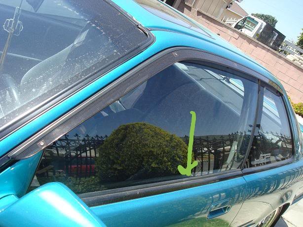

    Nother nother update....got some work in on the car this weekend.
    i jumped to the rear window motors because they are dead as door nails. I also turned my attention to addressing some of the trim and replacing the destroyed weather stripping around the door. Here are some pics:
    I'll be making a new moisture barrier for the door after i'm all done.
    Also replacing my scratched up door glass with some non scratched up door glass (still oem glass).
    And i found out why my windows are getting all scratched up, check out the back of the lower trim.
    The replacement trim is just as bad. I'm having a hard time finding if you can order just these replacement pads from honda. I think i might have found it for the fronts, but i'm not sure about the rear. I'm gonna just order one and see what shows up. If i cant use it on the rear, any ideas on what i can use the cover these up so the glass slides on something other than metal??
    Here is what i found on acura's breakdown
    Window regulator out, cleaned up and re-greased. They leave out an important step in the manual, unless i completely missed it. These things are super spring loaded lol i pinched my fingers between the gears when i removed the old window motor.
    i also replaced these in the door, mine were pretty worn and the set i got from the junkard were a little bit better. I fluffed up the fabric with a nylon brush before reinstalling.
    i'm waiting on re-installing everything until i figure out a good solution to keep the glass off of those metal portions that used to have the pad to slide on, but its still progress.
  12. Jan 22, 2018 at 10:39 AM
    #72
    Sacrifice
    Sacrifice Motorcycle Goon
    Oct 8, 2013
    #114093
    15,956
    KS
    DCSB OR 4X4 LT
    Pelfreybilt Front Bumper,BAMF sliders, Airflow Snorkel,Mini D2S Retrofits, ADS Rear Shocks, Deaver U402 Leafsprings, 35s, AllPro +2LT
    maybe just glue some felt on to the existing pad?
