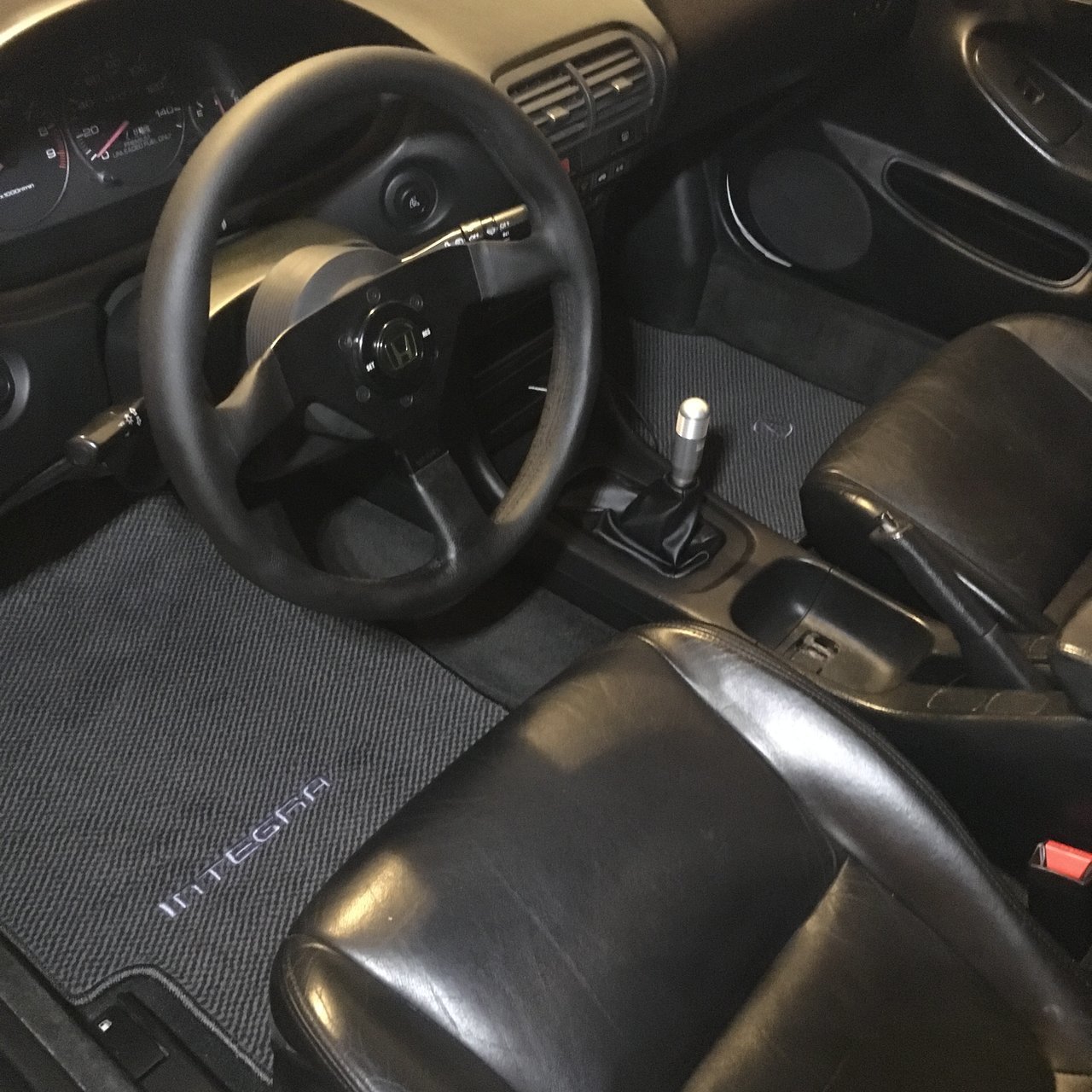

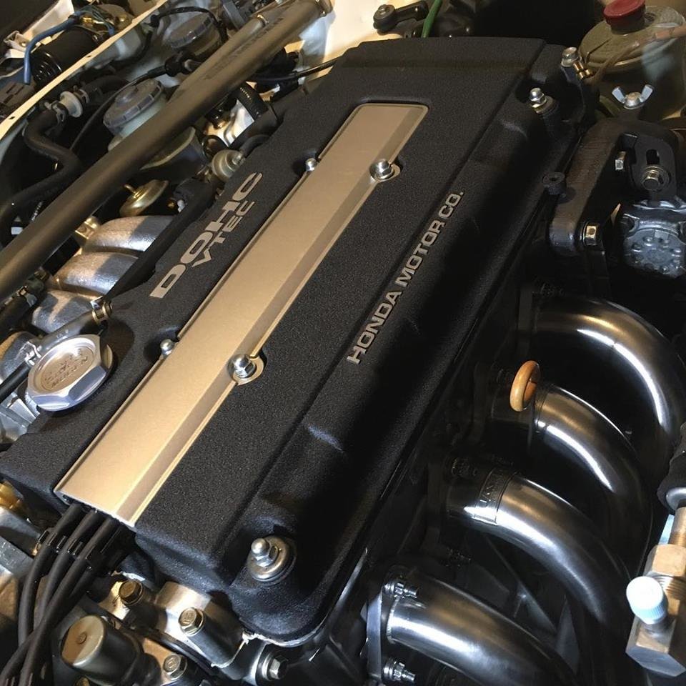

    Here's my interior and engine bay coming together slowly.

    ooooh those leather seats look mint! what exhaust manifold is that?

    Mugen 4-1

    Yeah, I'm trying to keep all the luxury as you called it. This one isn't going to be a Type-R clone or a gutted racer. Trying to stay GS-R, no red stitching, keeping A/C, cruise control, power steering, leather, etc.
    The original leather was shot. The driver seat had a cover on it and underneath looked like a racoon got in a fight with it, completely torn up. Found the fronts on ebay and probably paid too much, f it.

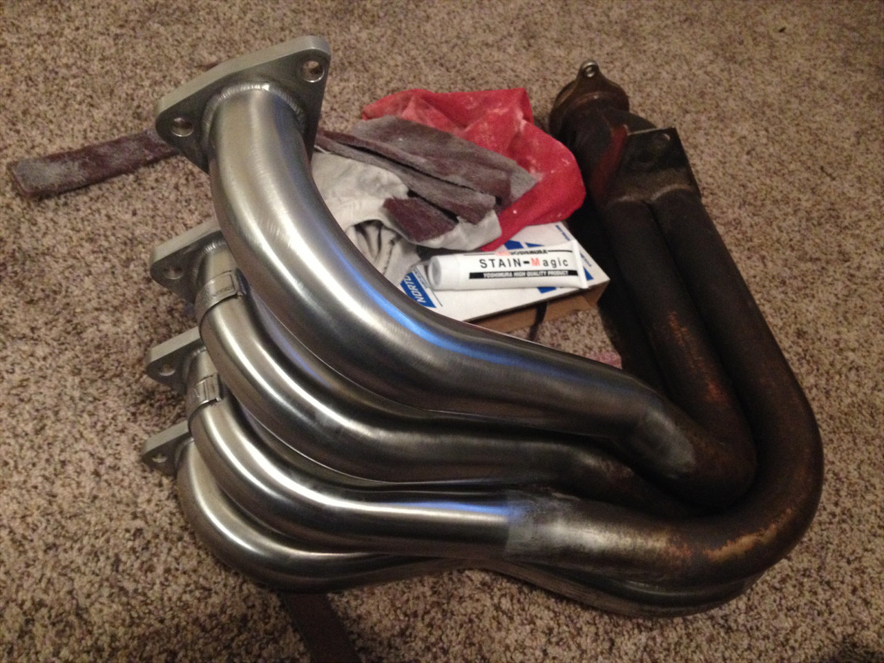

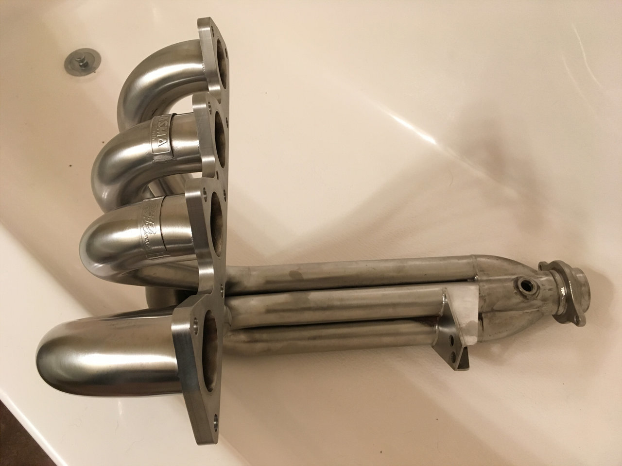

    The header looked beat when I received it as well. That was a few months of sporadic refinishing.

    yeah i put the power steering back in my car, the a/c needs repaired but it's staying and i need to troubleshoot my cruise control still. That header turned out amazing, what all did you use? I tried to get the same results with my type r manifold but it didnt come out anywhere near that good. I wet sanded and tried to polish the tubes the best i could

    50 yd roll of 1" 600 grit, Scotchbrite, experimented with that Yoshimura Stain Magic (Better used for a clean header that has some blueing on it).
    ...but the real MVP's were drill mounted wire brushes of different shapes and diameters.
    The final finish was scotchbrite.

    It's stainless so it should just get some color.
    Oh forgot, while I was wire wheeling it was in a tub with some water and CLR. It was total experimenting. The tub of water/CLR mixture was a failed attempt at one of those vibratory cleaners, after watching a few Youtube vids. Figured I'd sit the header in it and let it soak, then went to town with the wire wheels.
    Had a 30mm bore brush from an Apache laying around so chucked that up and cleaned the inside of the runners lol. Used it on my Skunk manifold also.

    Isn't the Type-R 4-1 mild steel? That needs to be coated with something.
    I thought about doing that to mine just because it was the lazy way out, however it would have some heat advantages. Eh, can always do it down the road.

    Huh, maybe he's right. I've never had one, so I was just going off the pictures.

    Still, with that amount of orange iron oxide rust, it must be a low grade stainless if it is. Who knows where he got his 409 stainless statistic.
