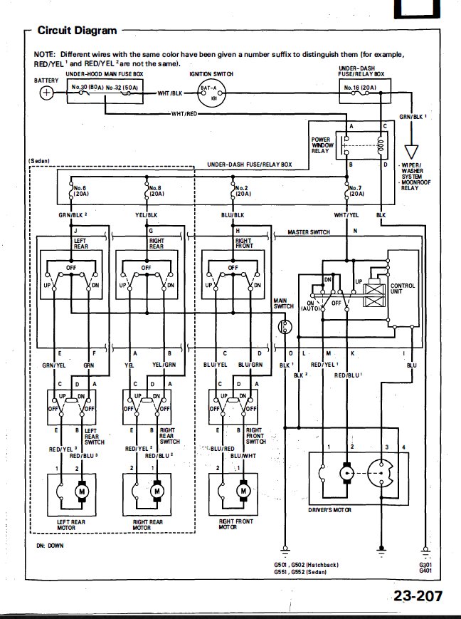

    starting to feel that way about my passenger window too. rolls down from driver switch just not up. ordered replacement switch and it doesnt roll down or up. even tested it.

    now thats odd, just from the driver's switch? Like, it works fine on the passenger switch?

    yeah just the drivers switch. passenger works fine

    thats gonna suck a fat one if you have to trace wires lol

    i dont think i should have too. i hope..lol. based on the diagram it has to be good wiring for the window to go down or up since the passenger switch goes through the master for grounds.

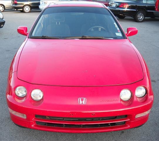

    here's a good one:

    Fatal_Paradox
    Fatal_Paradox Well-Known Member
    Jun 4, 2018
    #255460
    446
    Bardstown, KY
    2003 Tacoma DC 4x4 01 Tacoma 2.4 5lug
    33's Bedliner Nerf Bars (Custom)
    Its cheaper!
