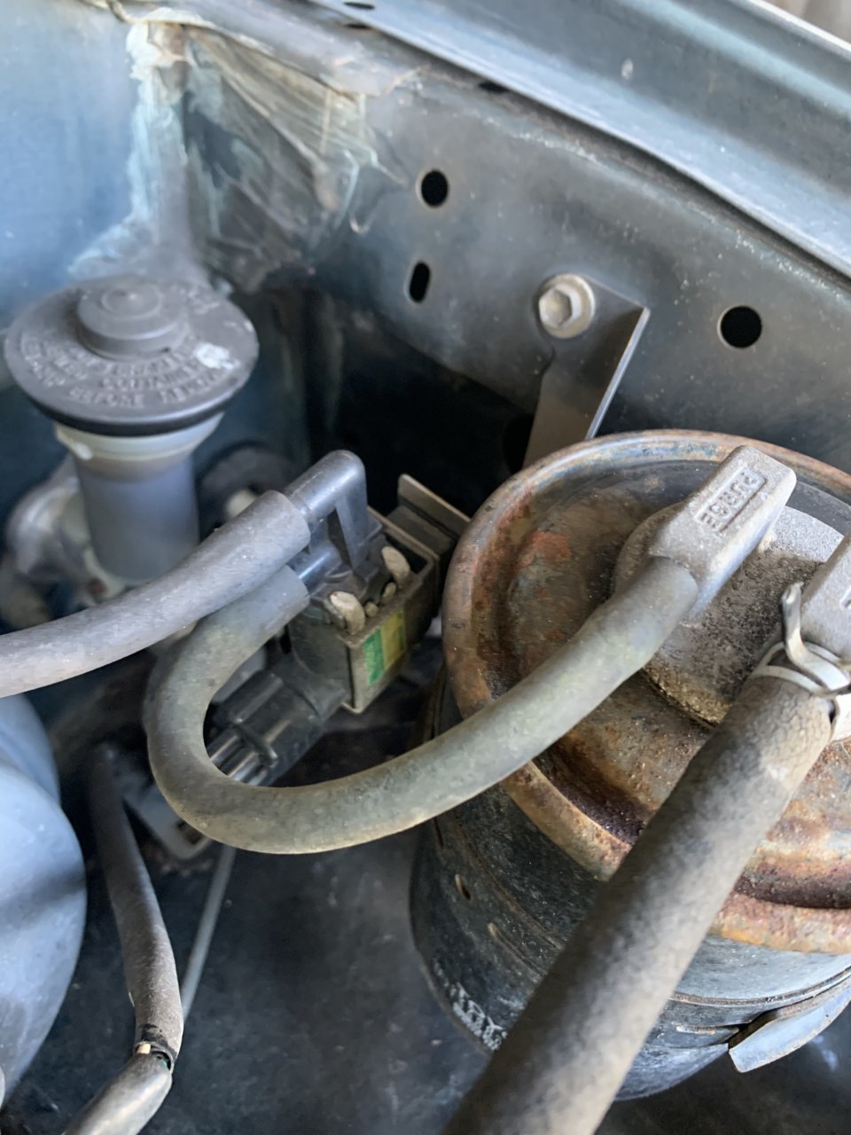

    Make sure the canister fresh air hose that runs under the truck isn't clogged, and be careful with the can. If it's clogged you won't be able to clean the filter. Stick with LOW pressure
    Btw this vapor canister works since the older canisters aren't available. It's slightly larger and you'll have to make it fit but it works great.

    Did you have issues with your vapor canister and replaced it? If so, what were your symptoms that lead you to troubleshoot your canister?

    Yeah, the can got clogged up and was allowing vapor into the intake which made fuel trims run rich until the ecm started pulling fuel. The hose that pulls air into the can was also blocked up with about 6" of dirt which could've been a contributing factor
    The gas cap vent also needs to work correctly for air to be pulled into the gas tank when the tank is under high vacuum. I'd recommend getting a new oem cap while they're still available

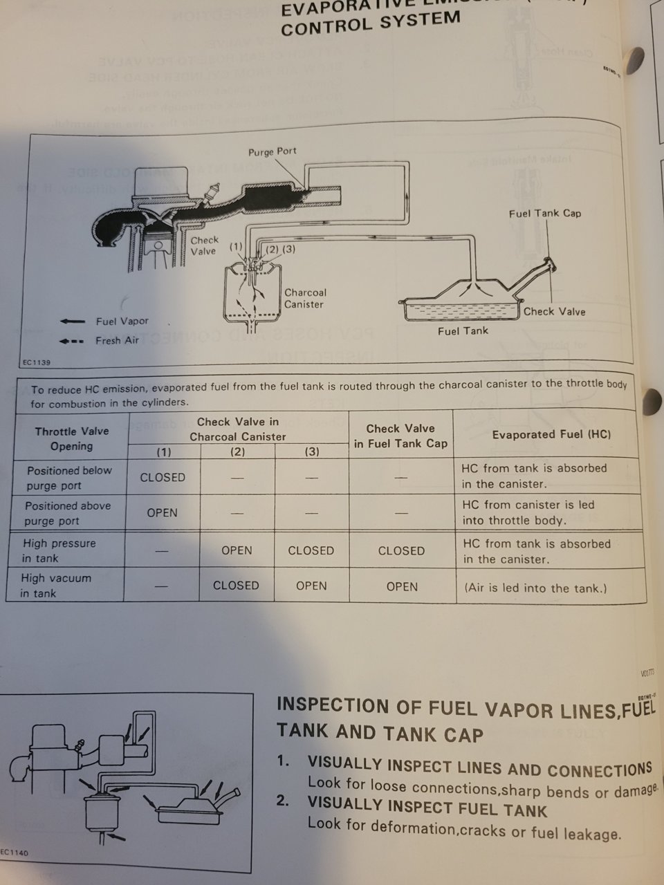

    Interesting. I’m gonna look into this. I noticed that everytime I go pump gas, whenever I open my gas cap there’s a lot of air pressure that releases. Is this normal? Does it mean the gas cap is working as it should?

    The gas cap is vented meaning that it allows fresh air to be sucked into the fuel tank to balance pressure when the fuel tank is under high vacuum. Yours is similar to the attached picture
