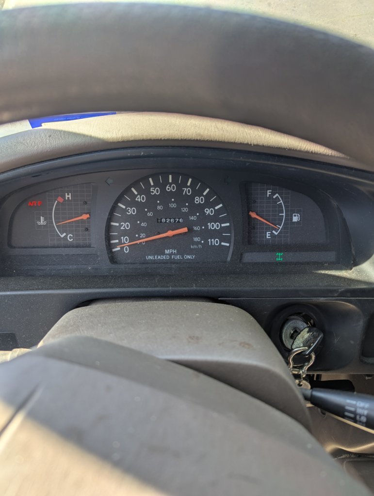

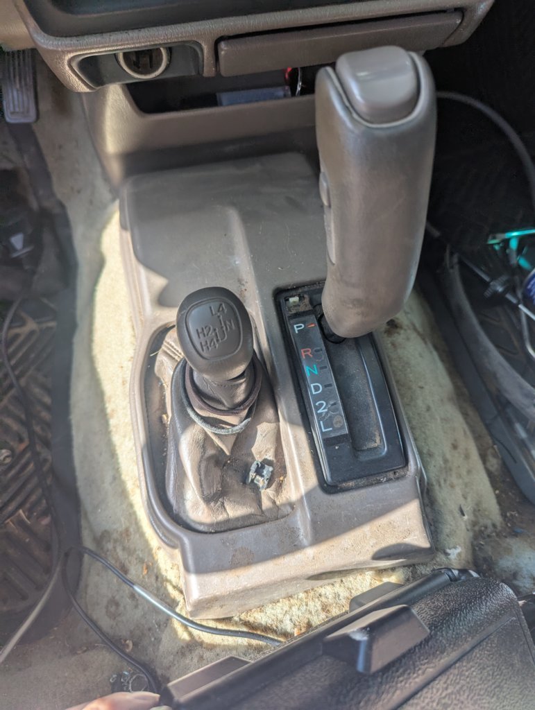

    What does A/T P mean and the bottom right shows wheels, is it in 4WD?
    How do I disengage the 4WD, hold the break and get it into the neutral slot?
    I tried putting the car into drive earlier and it didn't move, when I moved the shifter back to park it made a grinding noise for a short moment.

    That light illuminates when the transfer case is in neutral as a warning that the truck can still roll even if the transmission is in park.

    Pull all the way BACK on the small shifter until it stops.
    Then press the shifter to the LEFT until it stops, and the press UP.
    The Green Wheels Light should go off.
    You need to be in the 2H position.

    That worked! Had to move it up and down a few times, move out of park and back into it, then it let me move left on the small shifter wouldn't let me before.
    Park actually seems to work now, but when I shift into Revers or Drive the truck chokes out and dies. I was able to put it in drive and move forward about a foot before it died. Park/Neutral it continues to idle without issues.

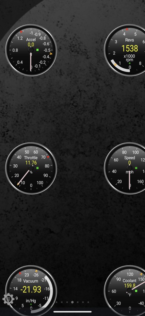

    Going to try adjusting the throttle opener thing from the video, grabbed a bluetooth OBD2 scanner so I can see RPM looks like it's idling at about 1400/1500 that seems high from what I remember it should idle around 800?

    Idle will be 1,200 or so on a COLD engine.
    Then drop down once warm and in closed loop.

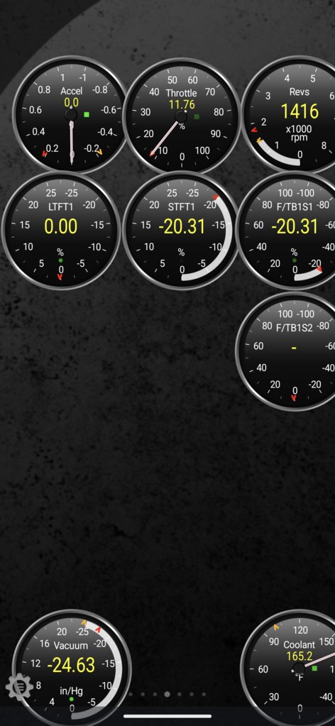

    The throttle gauge shows 11 at idle, could I have an issue with throttle position sensor?
    Not sure if I should adjust the throttle position plunger stop until my idle is under 1k
    From under the hood of I gradually turn the throttle the rpms rev up, if I move it quickly it stutters and does a kind of blowback then revs up high?

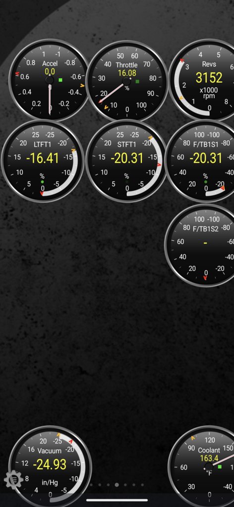

    Fuel trims? idle/ and mid throttle

    I think these are the trims, idle mod throttle and idle again
  20. Jan 24, 2025 at 6:20 PM
