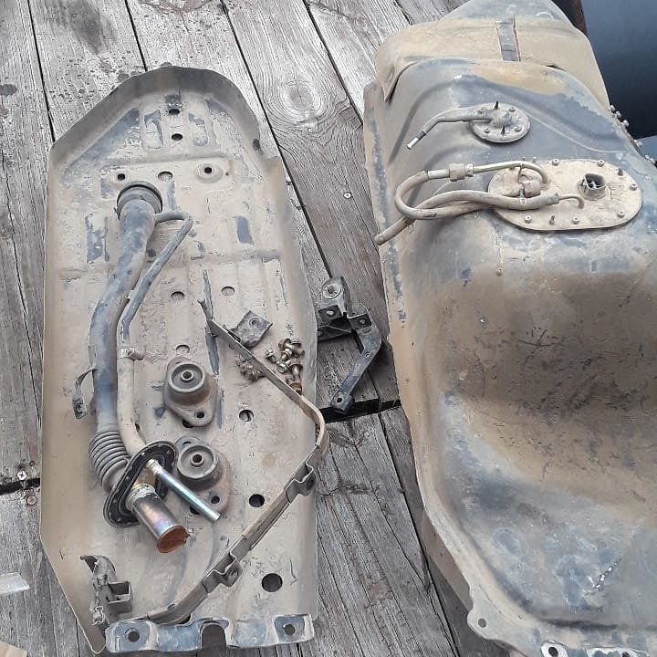

    That looks so much better there then it did sitting in my yard. I got a gas tank 18gallon if you are still looking.

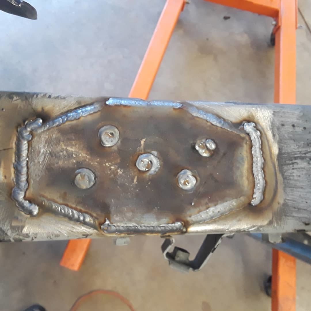

    162
    Dan
    Oh so close! But I like my welders painted red. Lincoln 180 Dual running. 030". It's plugged into 110v and I'm getting good penetration. I may swap it to 220v for the plate welds just to see how it does. I've done a lot of welding on 3/8" with it wicked up but not on something as thin as this frame.

    162
    Dan
    No preheat. It seems that these frames are pretty thin compared to my Rangers.
    I can do vertical uphill but always end up with a tall weld from the middle sagging down. I must not move uphill fast enough and it pools.

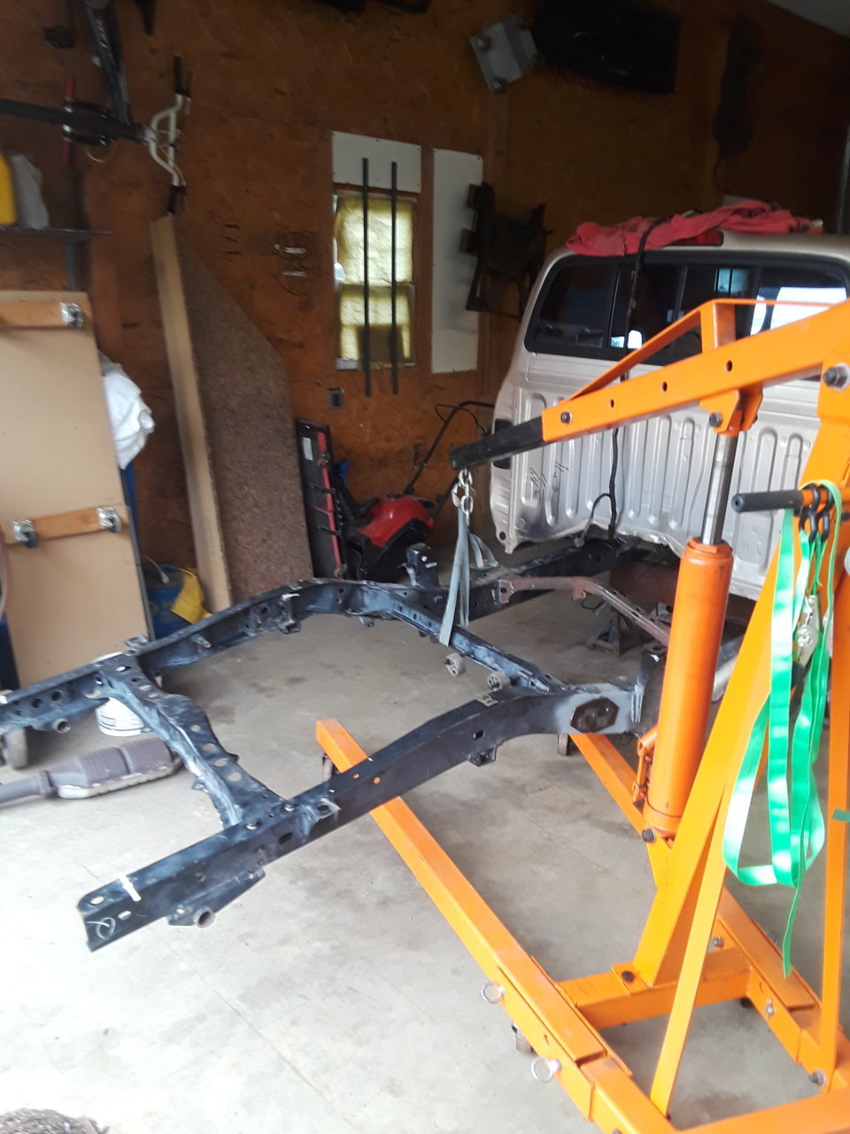

    162
    Dan

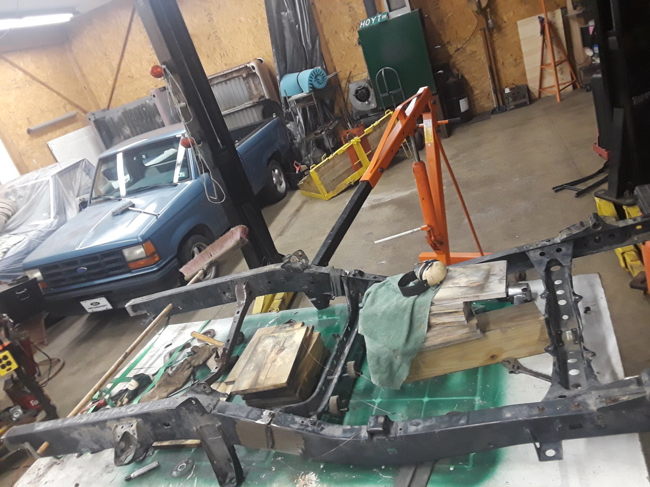

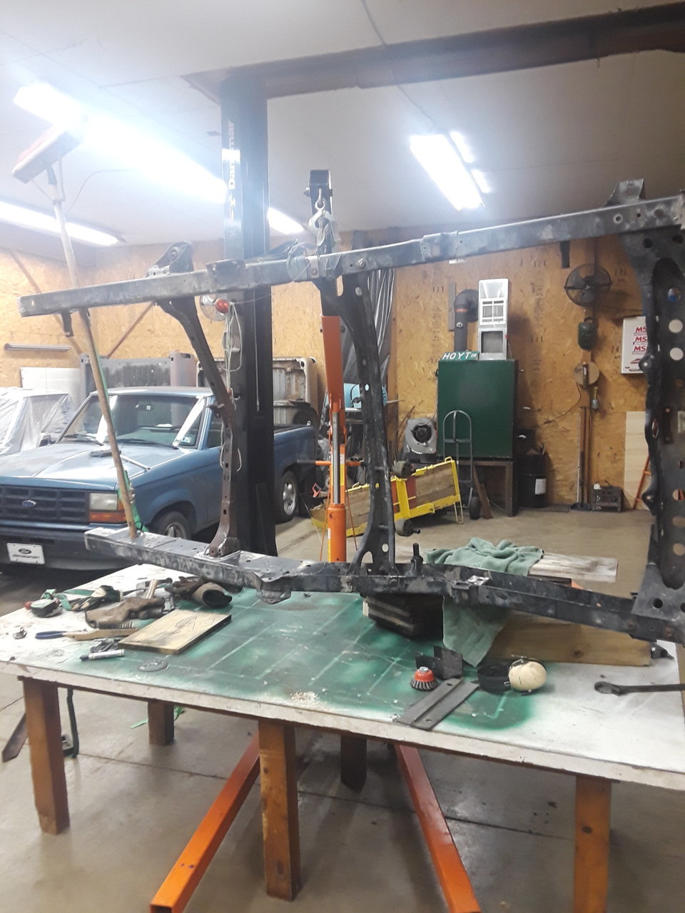

    Been away for a few days. Got back in town this evening and had to play in the garage a bit. Flipped the frame over so I can weld the bottom side. Also waiting on another load of parts from Tour991. I need body mounts that are among the parts before I stab this section on for good. Until then I'll get my seams welded and plated.

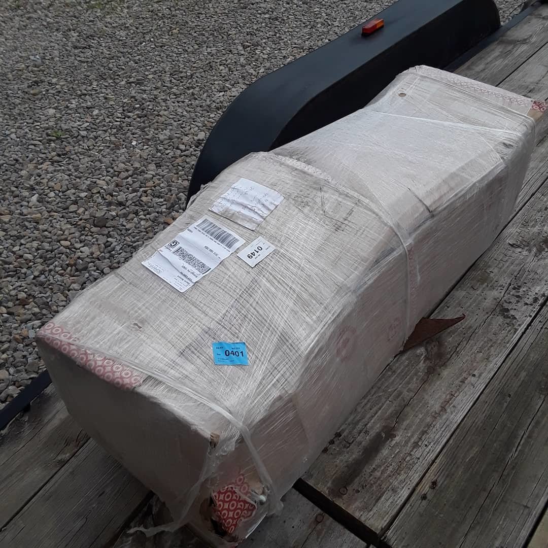

    162
    Dan
    Tour991 hooked me up again.

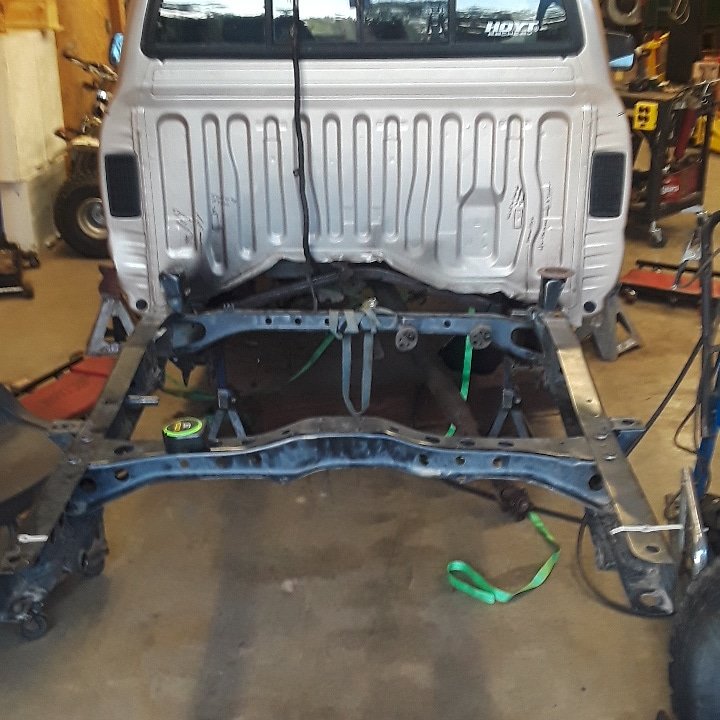

    162
    Dan

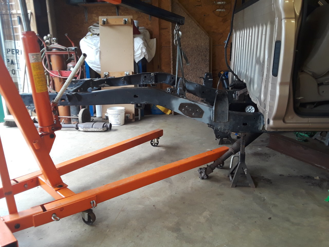

    Final fit.

    162
    Dan

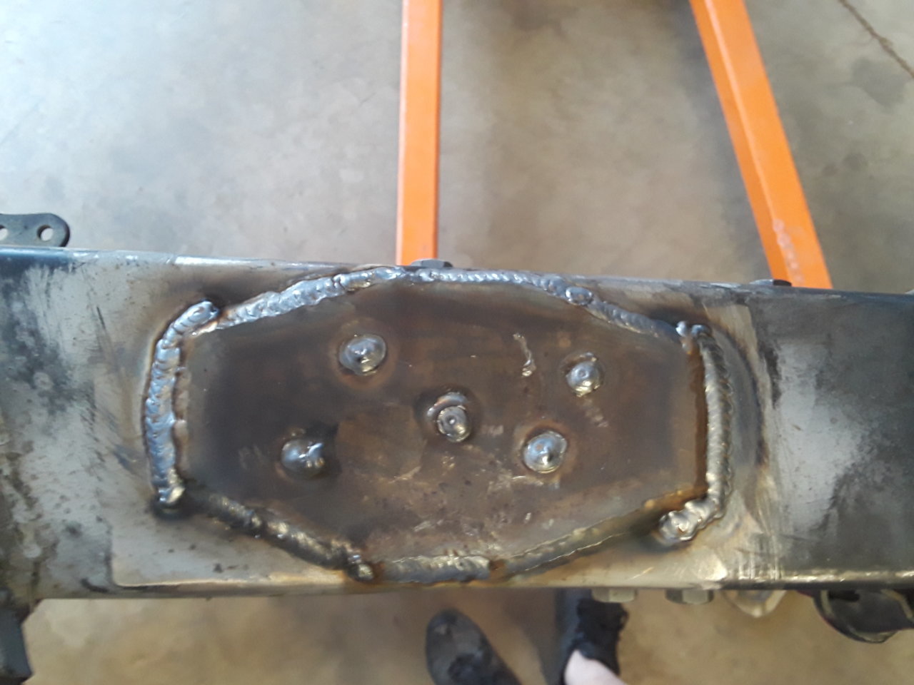

    Fish plates on rear section done.

    162
    Dan
    Frame is now in permanently. Just have to finish up some welding.
    Now I can start the search for leaf springs and installing new brake lines. My 1997 springs won't fit on the 1998 rear section....I knew that going into this swap but now is the time to address the issue. I'd like to find a clean set of stock springs for now...or even a reasonably priced used aftermarket set. Anyone have something before I post in the classifieds?

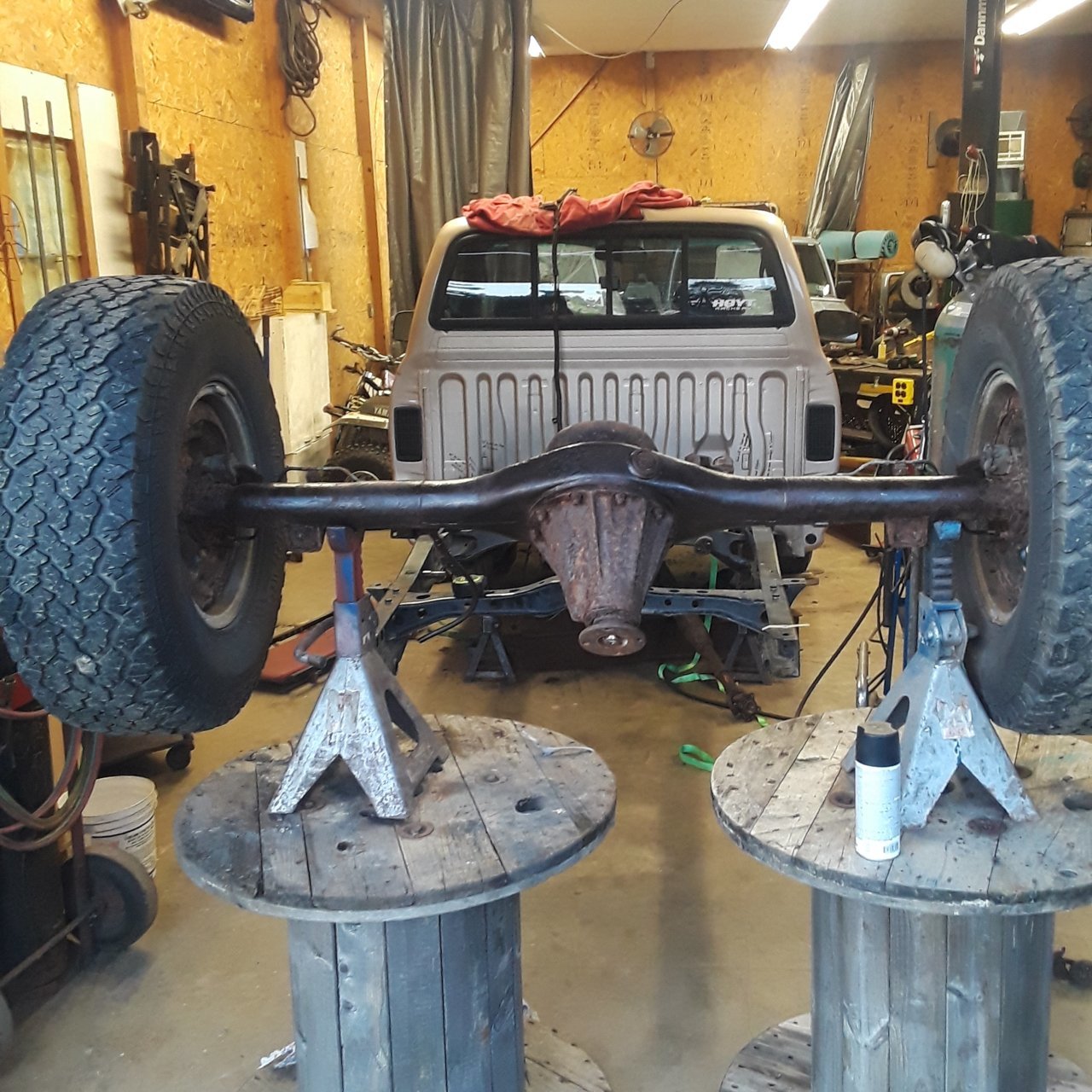

    162
    Dan

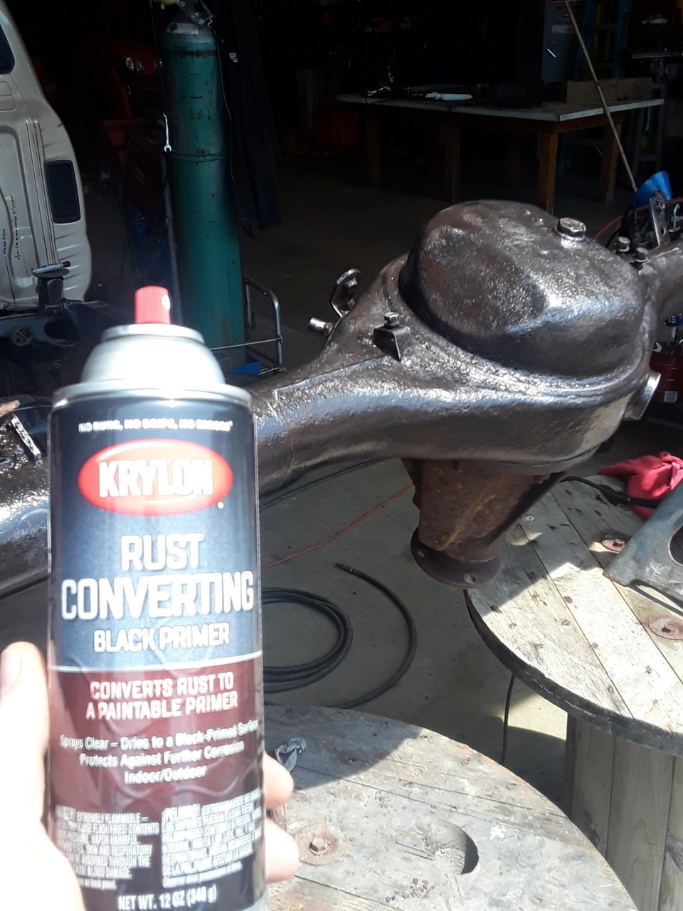

    Time to start cleaning the diff and pull the wheels while I'm looking for springs.
