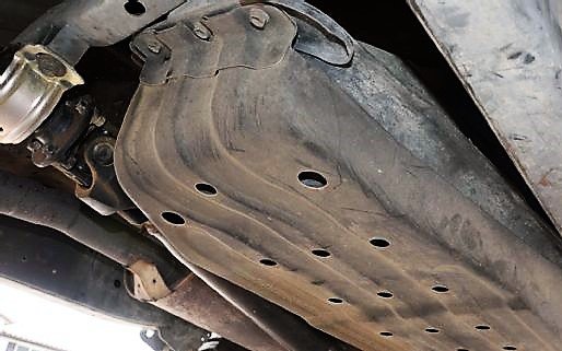

    Here is an image of the piece I need....it has the three bolts in it that hold the front of the skid plate and gas tank. It bolts to the frame next to the e-brake lever arm. Thanks!

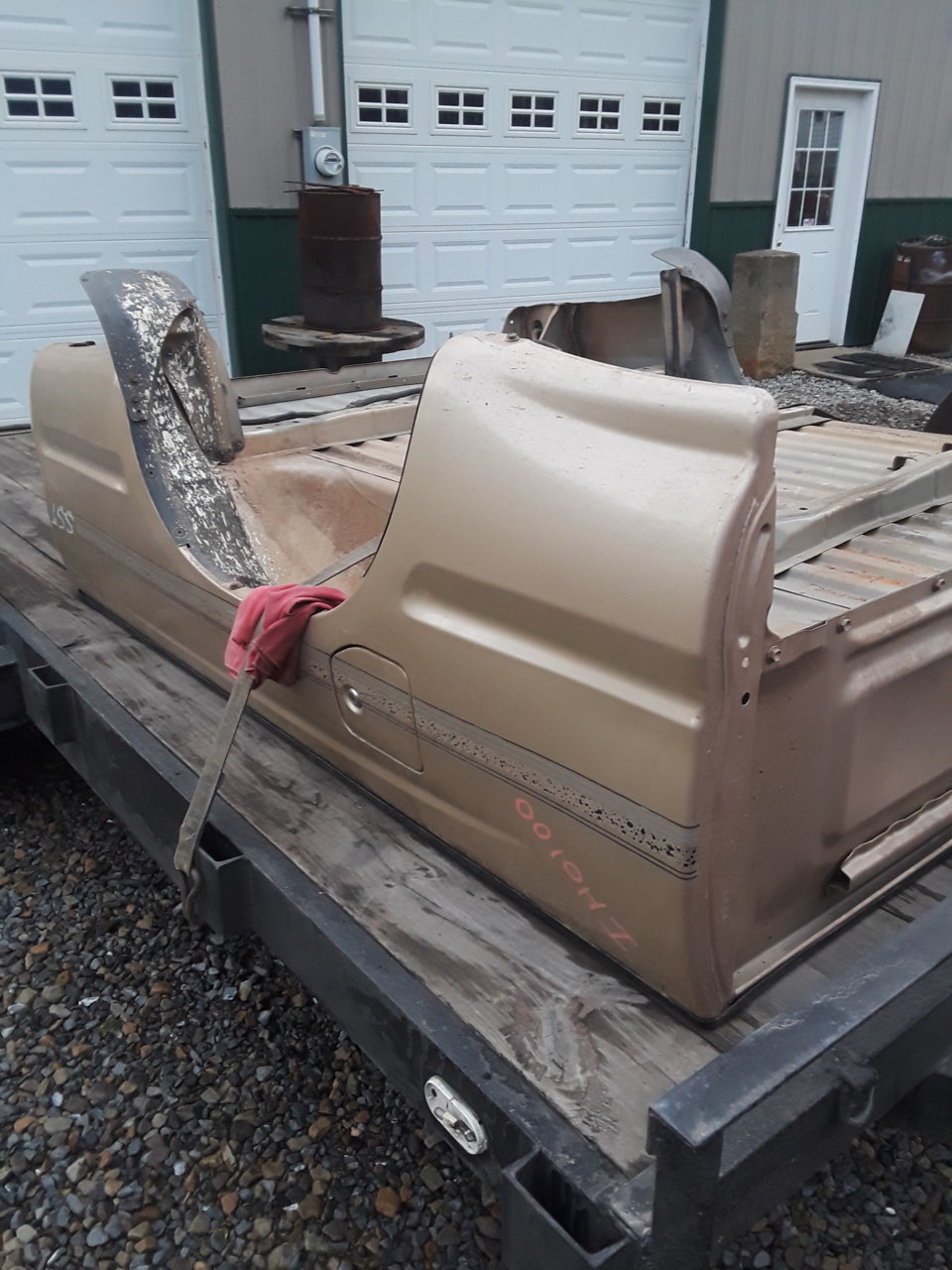

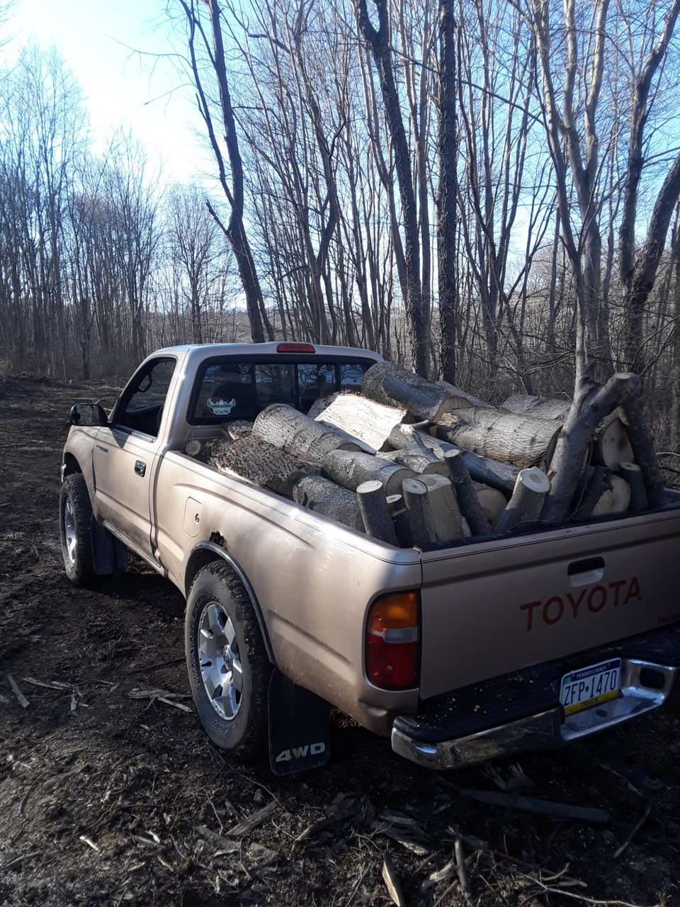

    Time for an update.

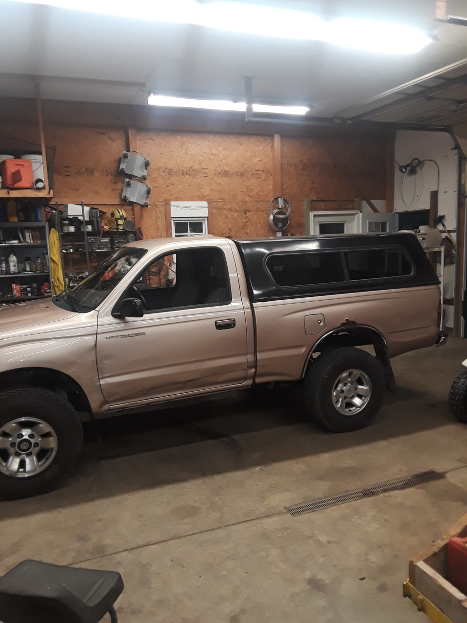

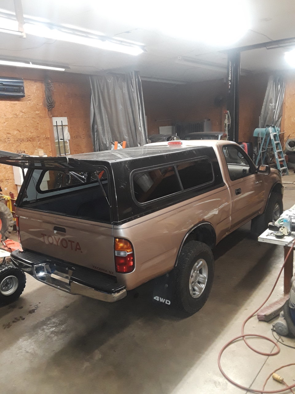

    Been driving the truck for a while near. Odometer is up to nearly 51k miles...probably hit that this weekend. That's about 4k since I took possession and rebuilt the entire back end of the truck. It's served flawlessly as a general run around truck for everything that I don't need the F150 and trailer to accomplish. That includes everything hunting related, firewood, general farm work, pulling my small trailer and even some DD driving. There were a few road trips along the way, the longest was 600 miles round trip. Never a problem...but that would be expected from one that hadn't yet cracked 50k miles and no one would ever know that 9 months ago it was destined for the scrap heap due a bad frame.
    By cruising CL I was able to find a nice set of FJ wheels and tires ($125 including lug nuts). I trimmed the centers to allow access to the manual hubs.
    The bed rust is quite bad but I was able to stumble on a color matching bed in near perfect condition with not a spot of rust on it. Some places that may be common, not in PA. It was trucked in by a company that transports clean auto parts up north. The red on the bottom of the bed is dust from down south...I pressure washed it and stripped off the nasty pin stripes. Prepping it now for a good coat of black equipment paint and I'm waiting for winter to pass before I install it.
    Anyhow...that's the latest.
    Riding Dirty, ACEkraut and Tour991 like this.
