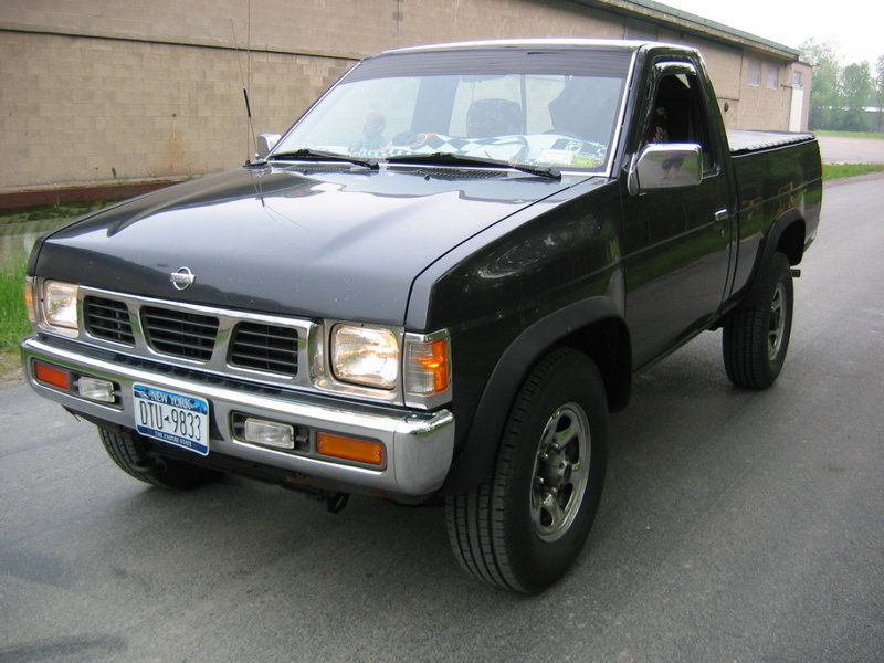

    Here is my $400 93 RC I traded up for my 10 RC upload_2022-6-26_9-13-52.jpg1DED10D3-3C21-4CF5-8DEF-94C65925129F.jpg Edit: The NASCAR blanket on the dash has made into the 10 RC (it gets around)
