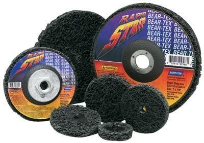

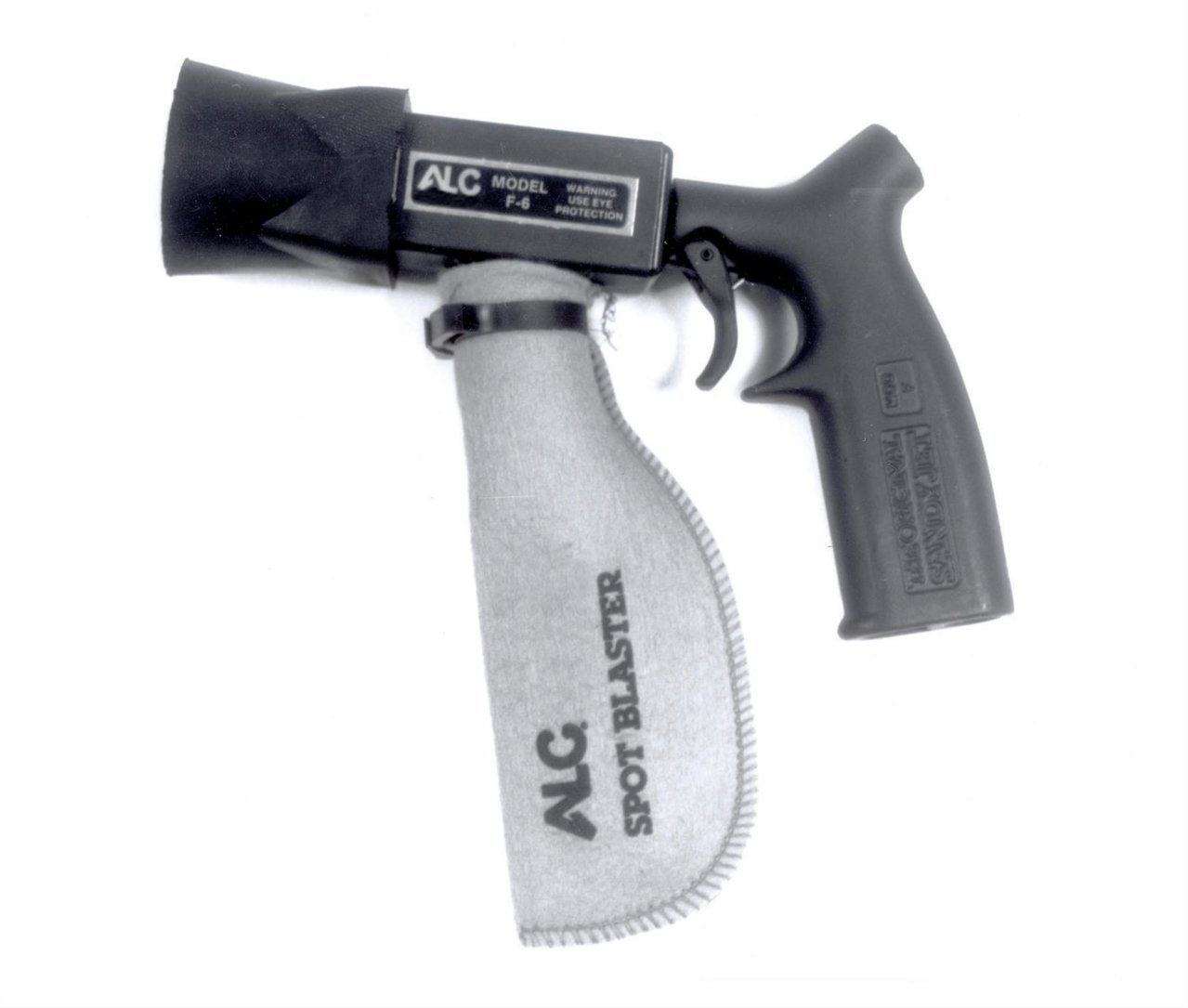

    That pitting will cause you trouble, you have to get the rust out or it will come back.
    Grinding isn't the answer because you remove too much metal.
    These Norton disks are very expensive but also work very well. Used carefully they will last a long time. The woven material is impregnated with silicon carbide abrasive, as it wears new abrasive is constantly exposed. These do a good job at getting into the pits without removing metal like sanding/grinding.
    If you have access to an air compressor a spot blaster like this will really get the pitting clean. The abrasive recycles so you use a long lasting high quality abrasive like silicone carbide or aluminum oxide. "Sand" won't work as it instantly turns to dust.
    Since you are only blasting a small area about the size of a quarter at a time these will work with a smaller compressor providing it is a tank type and has a 3/8" hose.
    This ALC brand is a quality unit.
    Remember, primer is porous, it will allow water to pass through to the metal (rust again), make sure you put a top coat on it.

    Thank you for all of those tips, including this one. I didnt know. I guess I will be now!
