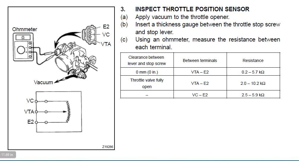

    Yeah it is adjustable.. You should be able to adjust it with a OHM meter and feeler gauges
    HairBear[OP] likes this.

    I have a four pin connector. My Haynes does not have an ohm chart for 4 pin set up. Only 3 pin. Between the top two pins I read 3.36k ohm at throttle closed. When Throttle 100% open I read 1.08k ohm.
    Scratching my head. ???

    I know this probably won't help, but this is from the 99 Tacoma service manual... I could have swore the 95-97 were the same (3wire TPS), but I guess not...You may want to try doing the procedure with the ohm meter and feeler gauges here.. I had a 91 toyota truck i replace the tps on and adjusted it with a ohm meter and feeler gauges(it was 4 pin TPS on it as well)
