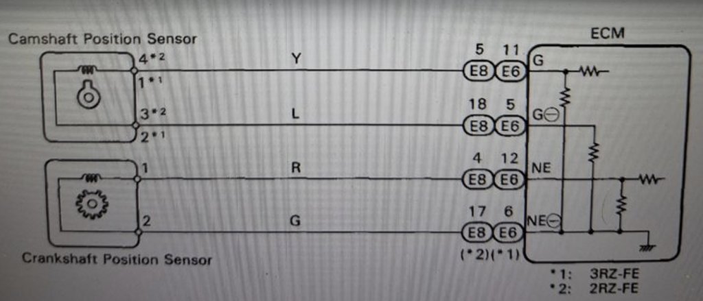

    Finally got my hands on a nice expensive scanner tool with LIVE data...
    No RPMs on the scanner tool live data..
    I did replaced the crankshaft sensor with new one about 2 weeks ago, but it wasn't an OEM Denso brand..
    I've read OEM is the best way to go with these parts. I just ordered a new crankshaft position sensor but
    this time its an OEM Denso Brand..
    Lets see if i get Live Data RPMs after i install that one..
    Will report back...
    Just to update everyone on what has been done..
    97 tacoma 3RZ-FE 4x4 5Speed 2.7L
    Cranks No Start with No spark..
    Replaced Camshaft sensor
    Replaced Crankshaft sensor (Denso brand coming soon)
    Replaced TPS sensor
    Replaced MAF sensor
    Checked ALL grounds
    Checked 12v power and ground to both coils
    Sent ECM to get checked and repaired..They replaced 5 capacitors inside ECM
    All fuses and relays seem to check out.
    Fuel pump turns ON in Live Data when cranking.
    All sensor wires trace back to the ECM are good
    ECM has good ground and 12v
    ECM still doesn’t see crankshaft sensor
