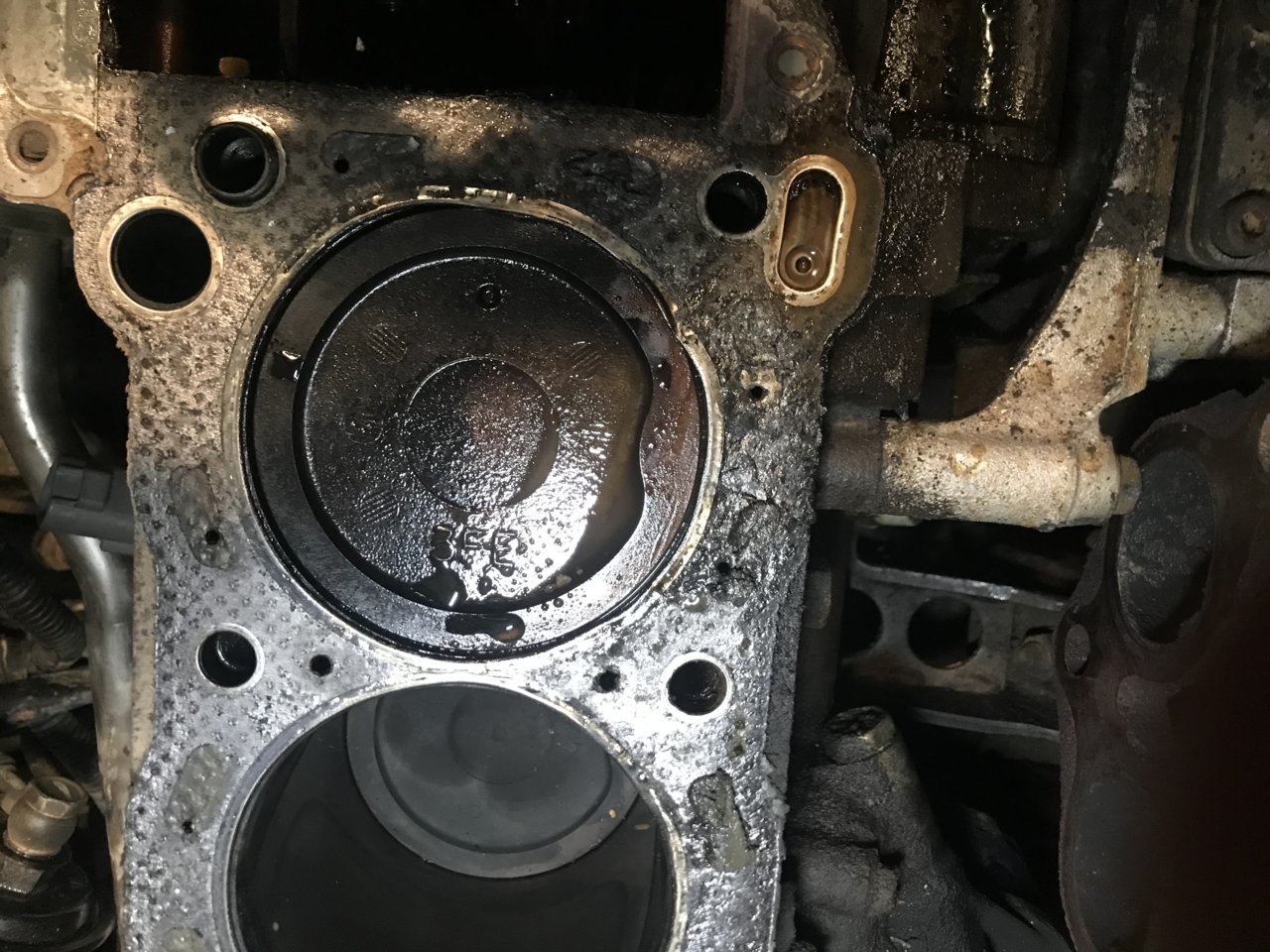

    Pulled number I spark out antifreeze blowed out when turned motor over I don’t understand why that happened unless head gasket blowed I haven’t noticed any smoke from it before the old antifreeze that came out of it before this was brown looking I flushed it and put new ran good for few days then this was happened if the head is bad I guess it will be junked hope it is just gasket will have it off maybe tomorrow evening

    Got head off and found this the one that had antifreeze in it
