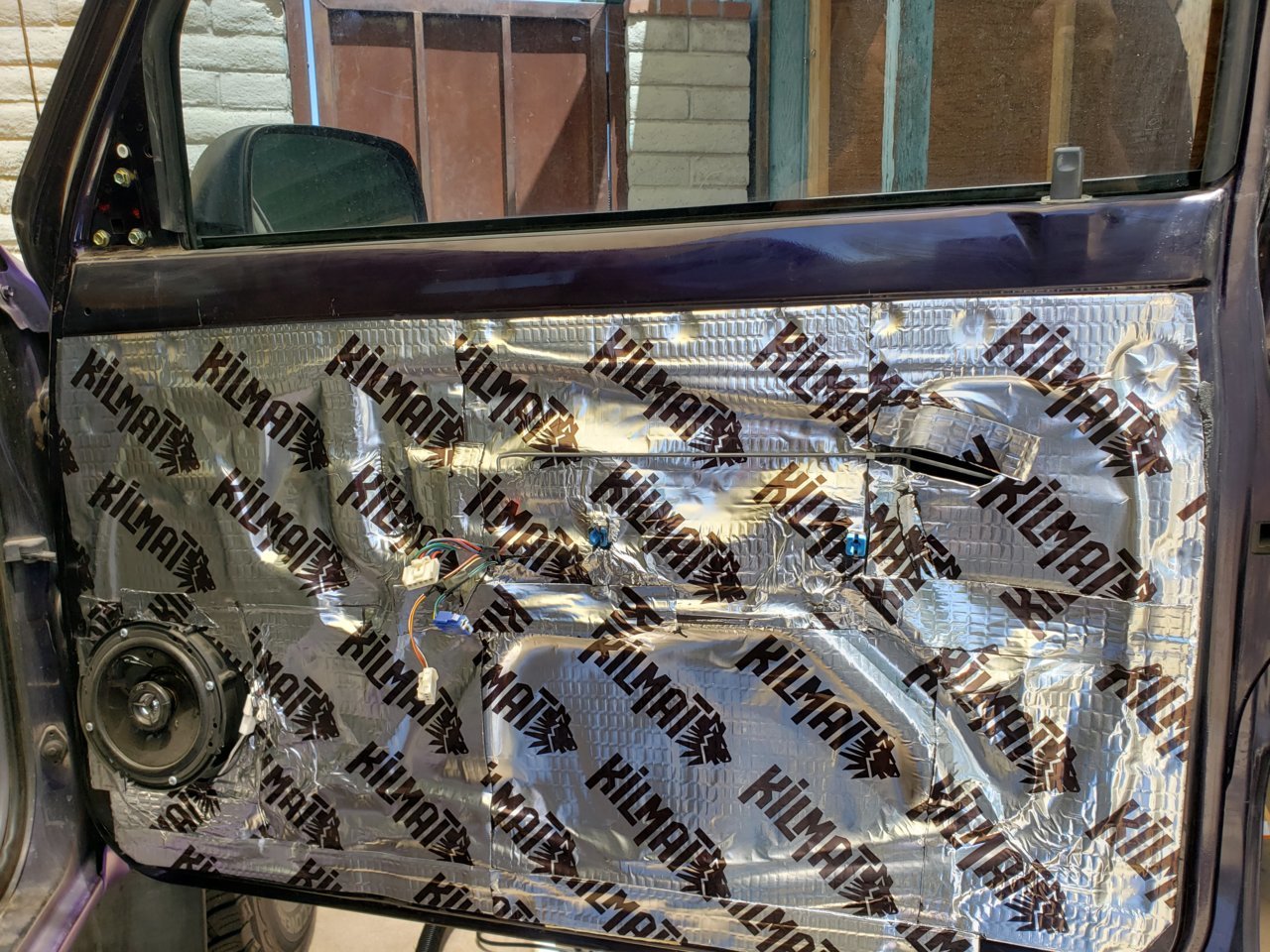

    I didn't do the exterior skin, I just did the interior side, but it made a big difference. I really like the Kilmat stuff.20220507_124155.jpg

    I'm glad to see I'm not the only one to use that type of sound deadener.
    Your job looks well done!

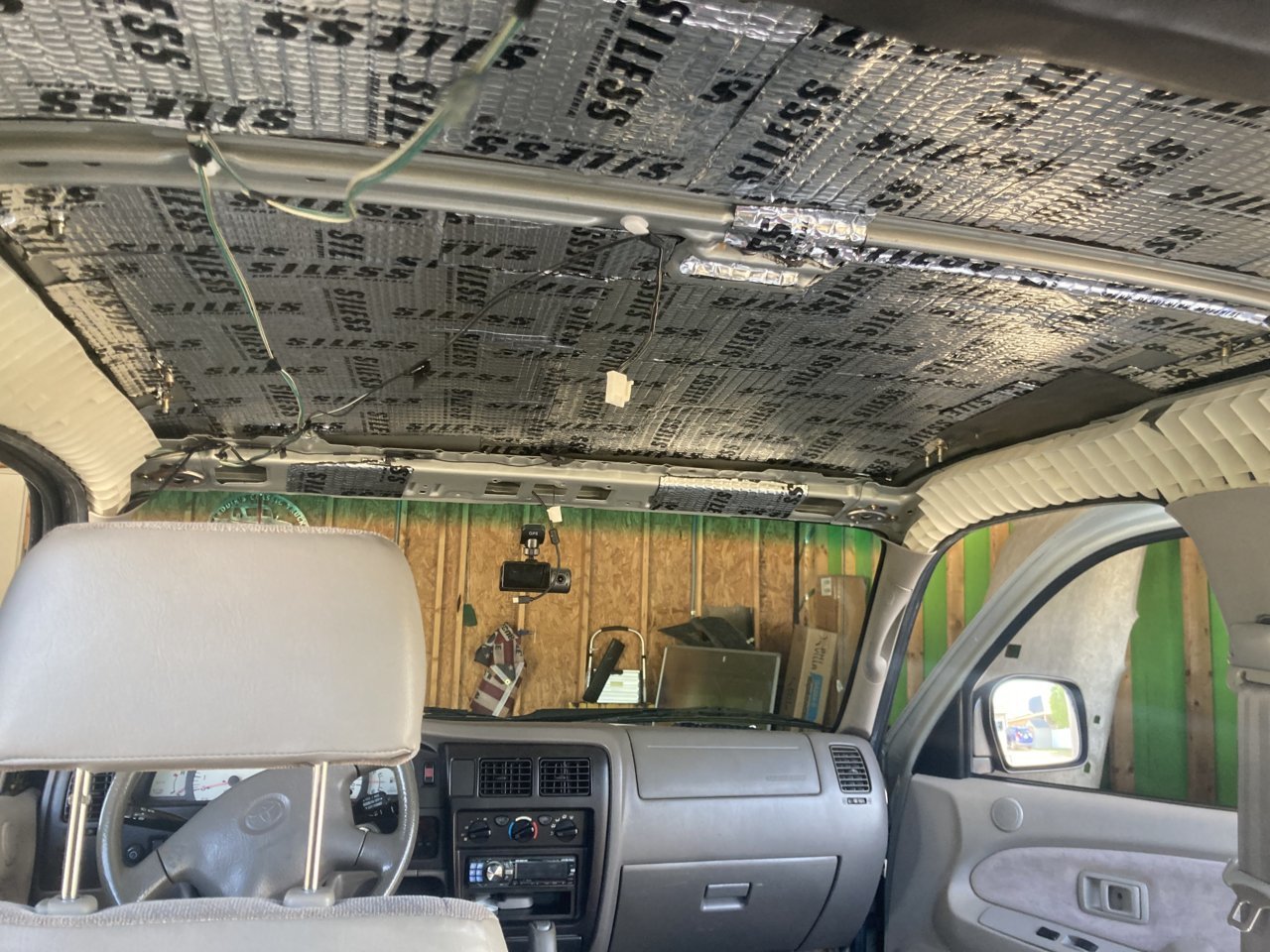

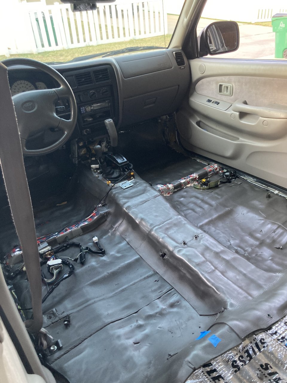

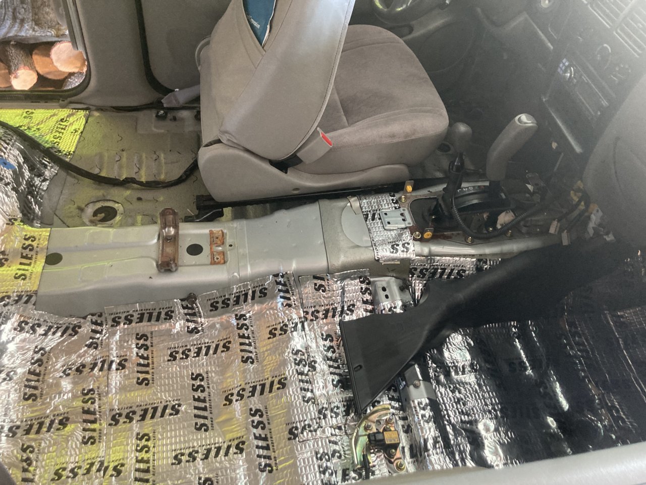

    Your doors are way better installed than what I did on mine. I couln't fit the door panel back on afterward and had to trim up all that hard work.
    Do the flooboards, headliner, and back of the rear seats and you'll be in a lap of luxury, I used Siless, two layers around everything but a third layer on the floorboards for TX heat. Mind the holes with painters tape!

    What did you use as your third layer on the floor?

    This was very helpful when I did mine. I did a closed cell foam in addition to mat as a 2nd layer, which I've been very happy with.

    I ended up using 4mm Siless matt, but all the major manufactures sell similar products.

    I used Aggsound 394mil sound deadener off Amazon, mainly because of the thickness for the floorboards and price - The rear cupholder is very snug and I prepped the surface with alchohol first. The AC keeps up with ~105 degree heat when I drive home from work now. I can't wait to see how it insulates in the winter.
