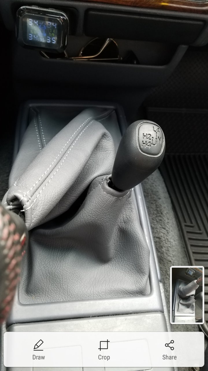

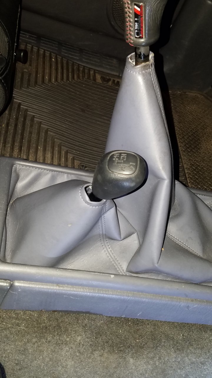

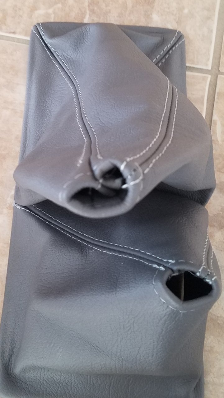

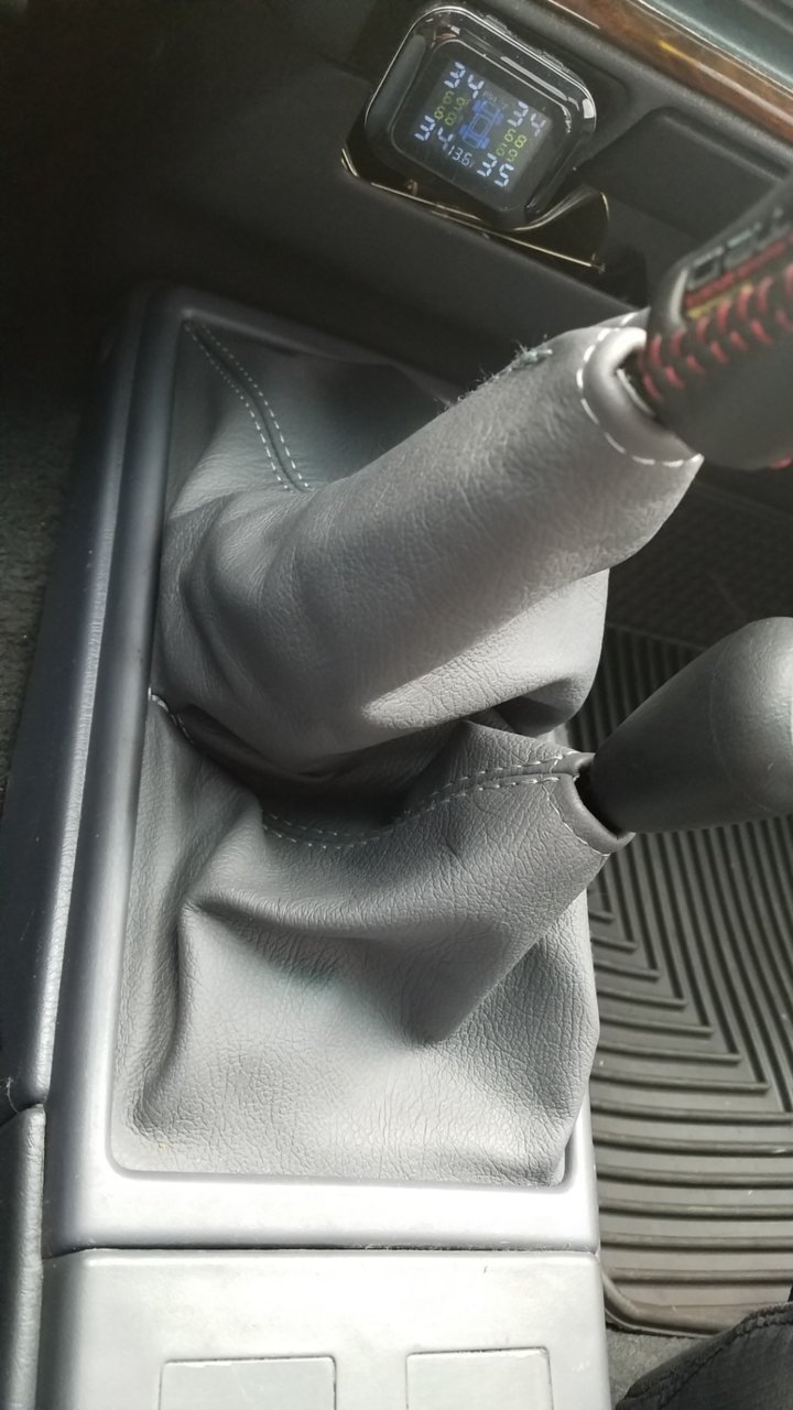

    Ordered an aftermarket leather shift boot.
    Before and after

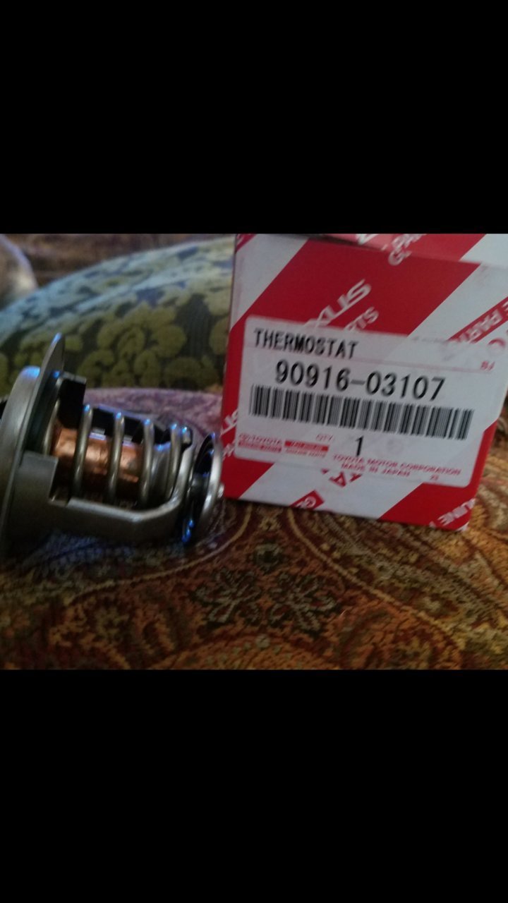

    Adding this new thermostat I found.
    I ran a super stat 170, it failed 4 months later,
    Got a 170 from advance auto and it failed 2 months later,
    Both of these looked cheaply made.
    Just found out the Corolla OEM 170 thermostat fits the 3.4 motor, got it installed, everything's working perfectly
    Highways temps are 168-173
    04yota, boostedka and Oside7even6ixty like this.

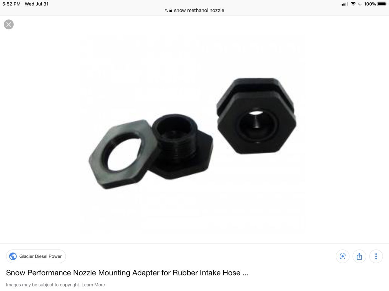

    Nice find!

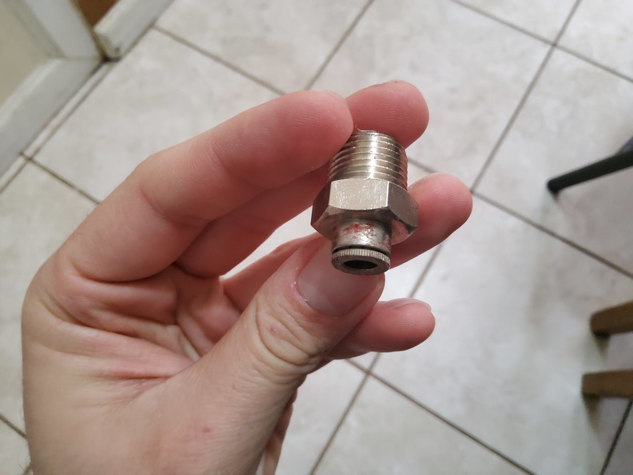

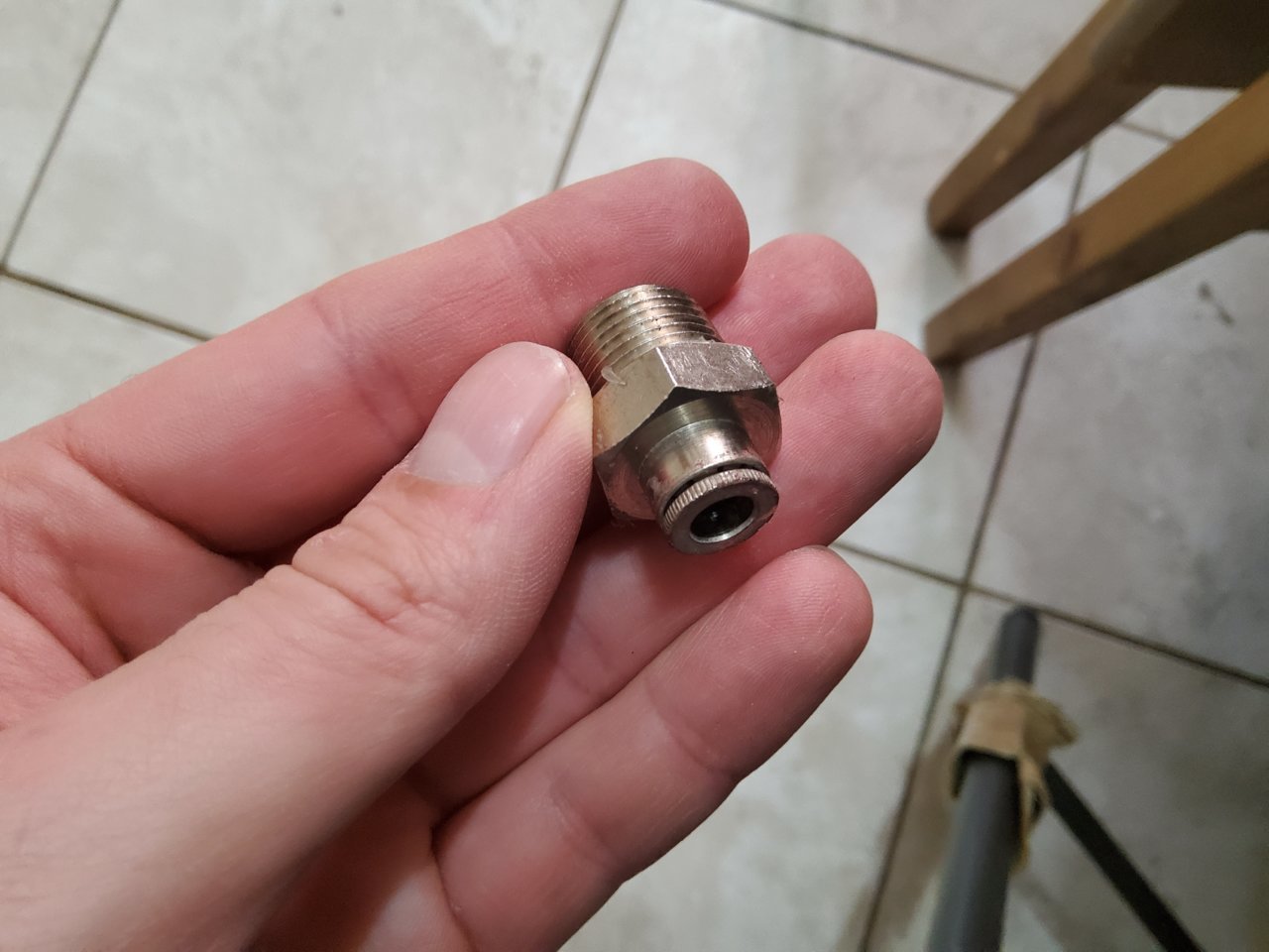

    The recently noticed I have been consuming a lot of methanol. A tank would last me 500 miles where I would usually do about 2k to 3k on a tank of methanol. It turns out a quick disconnect was leaking. Have you had any issues with them. I have been looking online but it seems like snow performance upgraded the style of connector.
    Edit. Sorry I screwed up the post lol

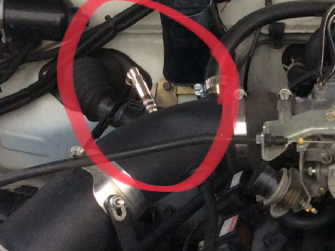

    Is that just pipe thread by quick connect tube fitting?
    04yota[QUOTED] likes this.

    That’s a place that does leak sometimes depending on the connection.
    I did notice a very small Leak there after about 30k miles, so after looking at the hose there was a wear
    mark grove so I cut 1/2” off the hose and alls good now, you have to make sure the slip connect is tight tho

    Yes

    The the problem is the hose sits at a 90° angle. I have to find the same quick connect with an attachment for the 90.
    Aside from this I have 30k on the supercharger and 25k on the methanol kit and no issues. :)

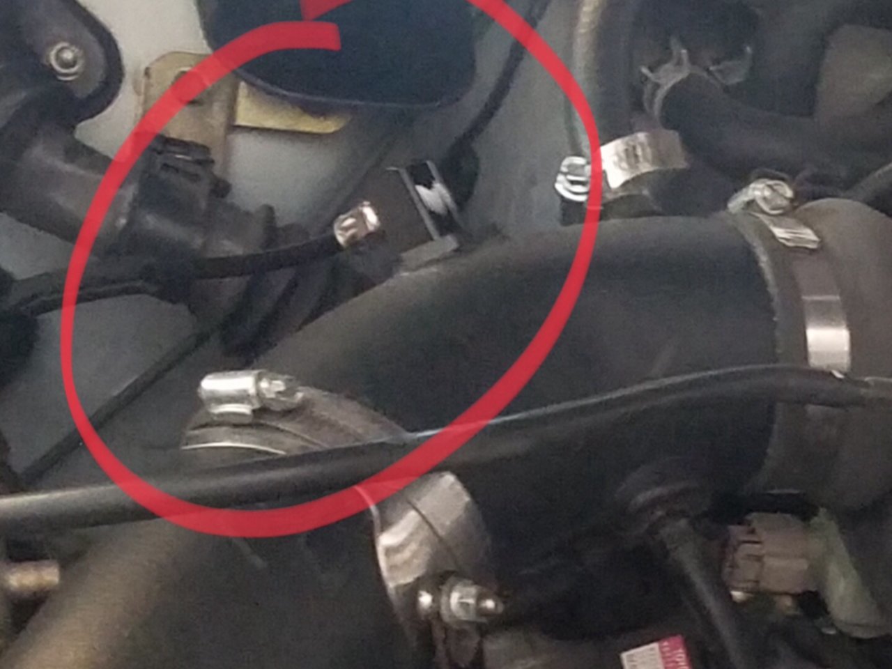

    I ended getting a low profile 90 degrees nozzle and an adapter that you install into the intake tube that holds the nozzle .
    Before I had the long 90 degree nozzle

    If your leaking from the thread you have to use a methonal resistant sealer like this

    What size pipe thread? I might have some

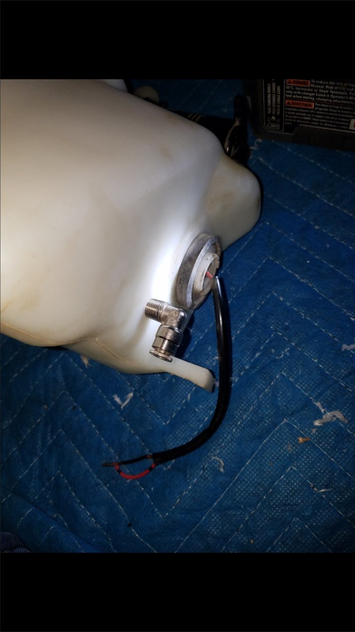

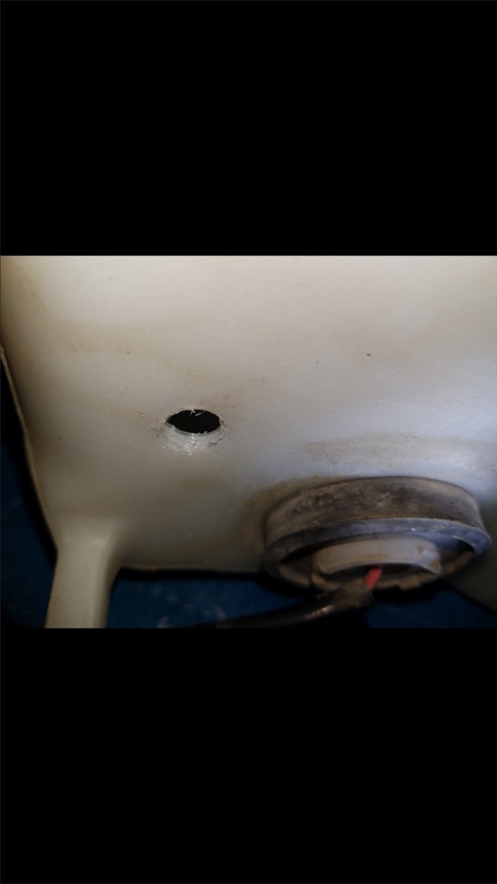

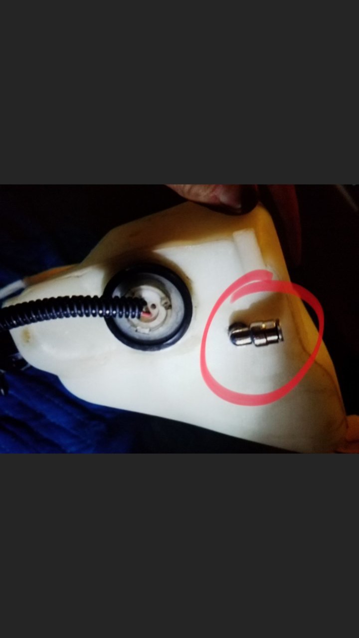

    My issue is at the bottom of the reservoir. My bottle sits almost at the wheel well and the line rubs.
    I found this on their website
    https://www.summitracing.com/parts/sno-82081r-90

    Devi’s own has a 90 degree push lock fitting and a self healing tank tap. Check them out saves space and solved my clearance issue.

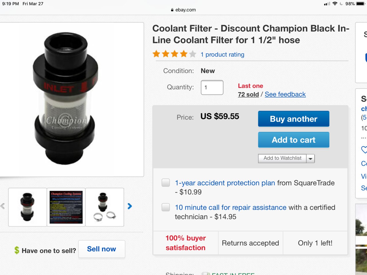

    John, what interval do you normally change the engine coolant?
    i have roughly 30k since the whole system was purged almost a year ago
    but am probably gonna do it myself this time, I have only had it dealer serviced the few times before roughly every 30k (but not every year, every other year or so) for $80 approximate
    it looks easy enough to get the little drain at the bottom off from the topside and have no idea about the radiator cap, its still original as i can remember
    one original owner on TW with the 96 claims to have never changed the engine coolant on his 440k truck, so he must be on the original radiator still
    there is some 'burping' involved to get rid of air bubbles i have read about
  18. Apr 25, 2020 at 3:56 PM
    #438
    1997tacomav6
    1997tacomav6 [OP] V6 5sp,RegCab,TRD Supercharger,Haltech,meth, 750k
    Oct 5, 2013
    #113940
    10,249
    John
    Denver
    97 reg cab, v6 5sp 300hp supercharged, Methonal Injection, 750,001 plus miles, Original Owner
    V6 5sp,RegCab,TRD Supercharger, 1.9” pulley, methanol injected Haltech ECU, AC TRD supercharger,(MUST DO) TRD supercharger ported, every 125,000- 150,000 needs rebuild Projector headlights HID 5 speed manual Amsoil for all drive train Smaller 2” pulley, (MUST DO) 2004 DESNO fuel injectors, zero ping ping, 2004 side door mirrors Dick Cepek Rims, Michelin tires LTX, ( that last 100,000 miles) Now running Dynopro ATM mud and snow tires KN cold air intake Cat back exhaust with ss exhaust tip, Raised exhaust tail pipe to 2" below body line Optima*dry cell battery,red top Alpine sirius radio, 200 watt amp, focal is165 split door pod speakers Focal door speakers Subwoffer behind seat Viper alarm, Electric Locks Dark tinted windows, bucket seats corbeau lg1 Tacoma Rubber floor mats TRD fender extenders, Bilstien shocks, King shocks nerf bars, add a leaf for rear springs trailer iv hitch, electric brake control, Drilled slotted brakes, High carbon steel (MUST DO) EBS green stuff 7000 series pads(MUST DO) TRD engine oil cap TRD stick shift, Marlin crawl shift kit. Rear sliding window 2002 4Runner functional hood scoop cut into Tacoma hood, 4Runner dual overhead map light Gentex Auto dim + Compass + Temp, garage,rearview mirror Snow Methonal kit stage 2 Custom 3 core aluminum radiator Linex bed liner Haltech stand alone ECU, Intake supercharger gauge. Stainless steel brake lines, Custom leather wrapped steering wheel,
    I change mine every two years or so which is about 60,000 miles.
    It’s super easy and quick.
    One of The damages that are done from not charging the coolant is that small particles of rust come loose from the block over time and then those particles act as sandpaper with the water movement on the aluminum heads.
    I have seen photos of the aluminum water jackets that were all worn down and causing head gasket issues. These areas the aluminum is thin to begin with.
    GQ7227[QUOTED] likes this.
  19. Apr 25, 2020 at 3:58 PM
    #439
    GQ7227
    GQ7227 mw survivor
    Dec 6, 2018
    #275019
    29,298
    J A Y
    i see why you put that see-through filter in!
    there is a product out there from BG for coolant additive that could stop internal corrosion from what i remember reading somewhere online
    darnit, now i must go doublecheck that flushing service i had last summer to see if thats what they used

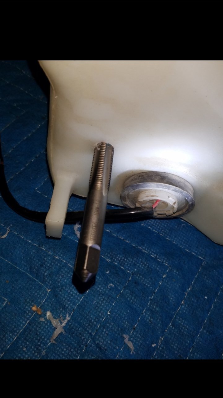

  20. Apr 25, 2020 at 4:07 PM
    #440
    1997tacomav6
    Oct 5, 2013
    #113940
    10,249
    John
    Denver

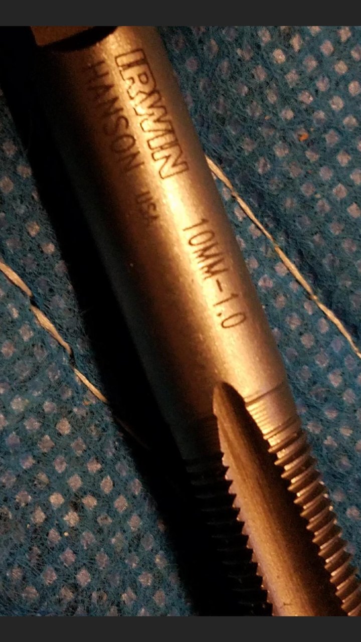

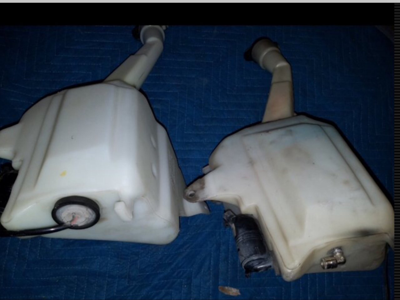

    That should work, the tank on the right was my stock tank with the rright angle fitting.
    I bought a newer style tank from the junk yard for 30.00 that had the stock low level sensor
    and moved the angle fitting to it.
    I used a tap and die set to get the threads correct for a tight fit.
