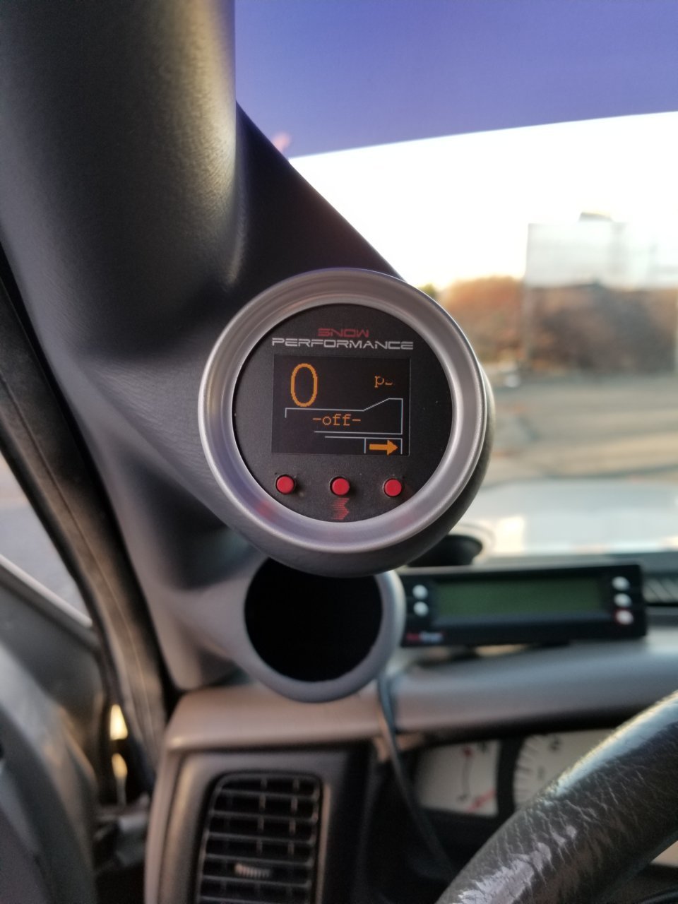

    This is the kit I want to get with the gauge, just haven’t figured were to mount another gauge

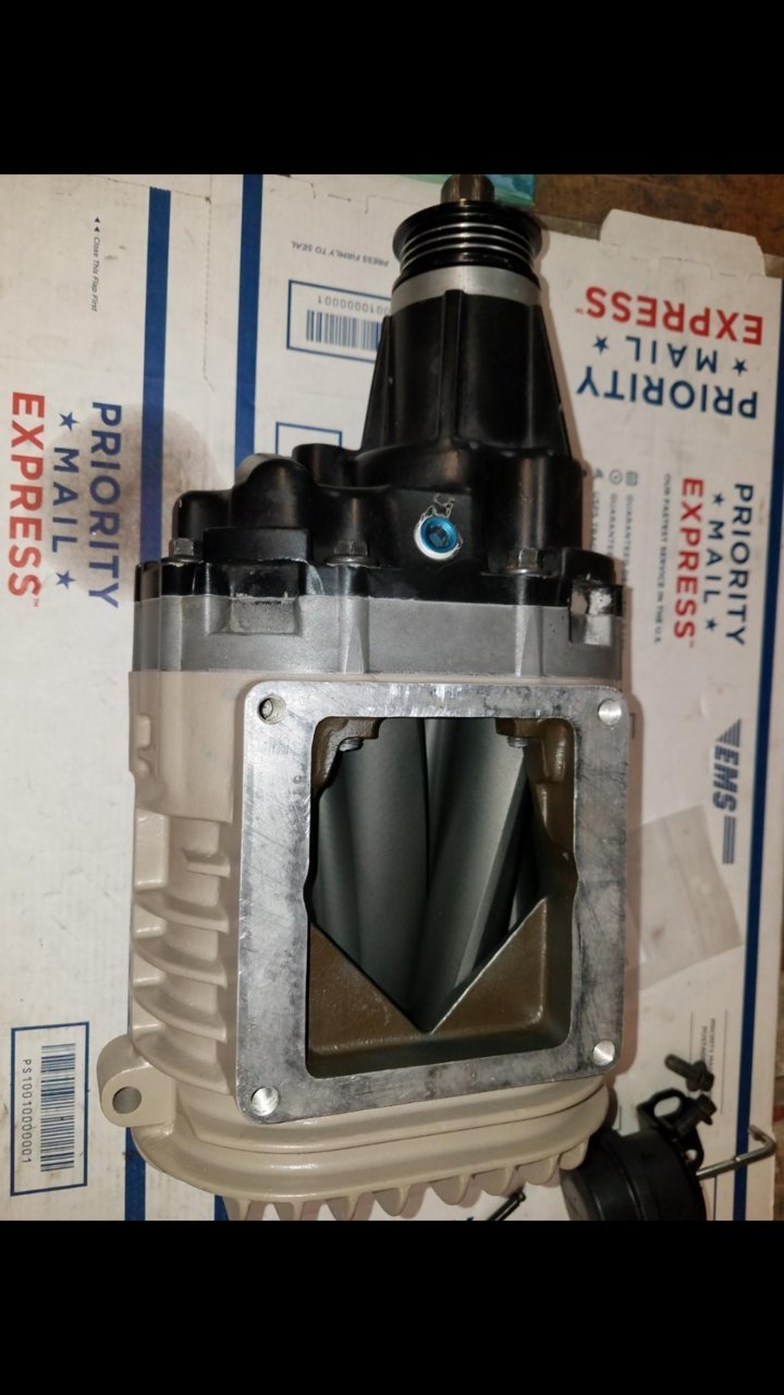

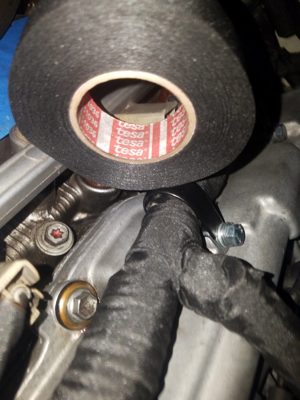

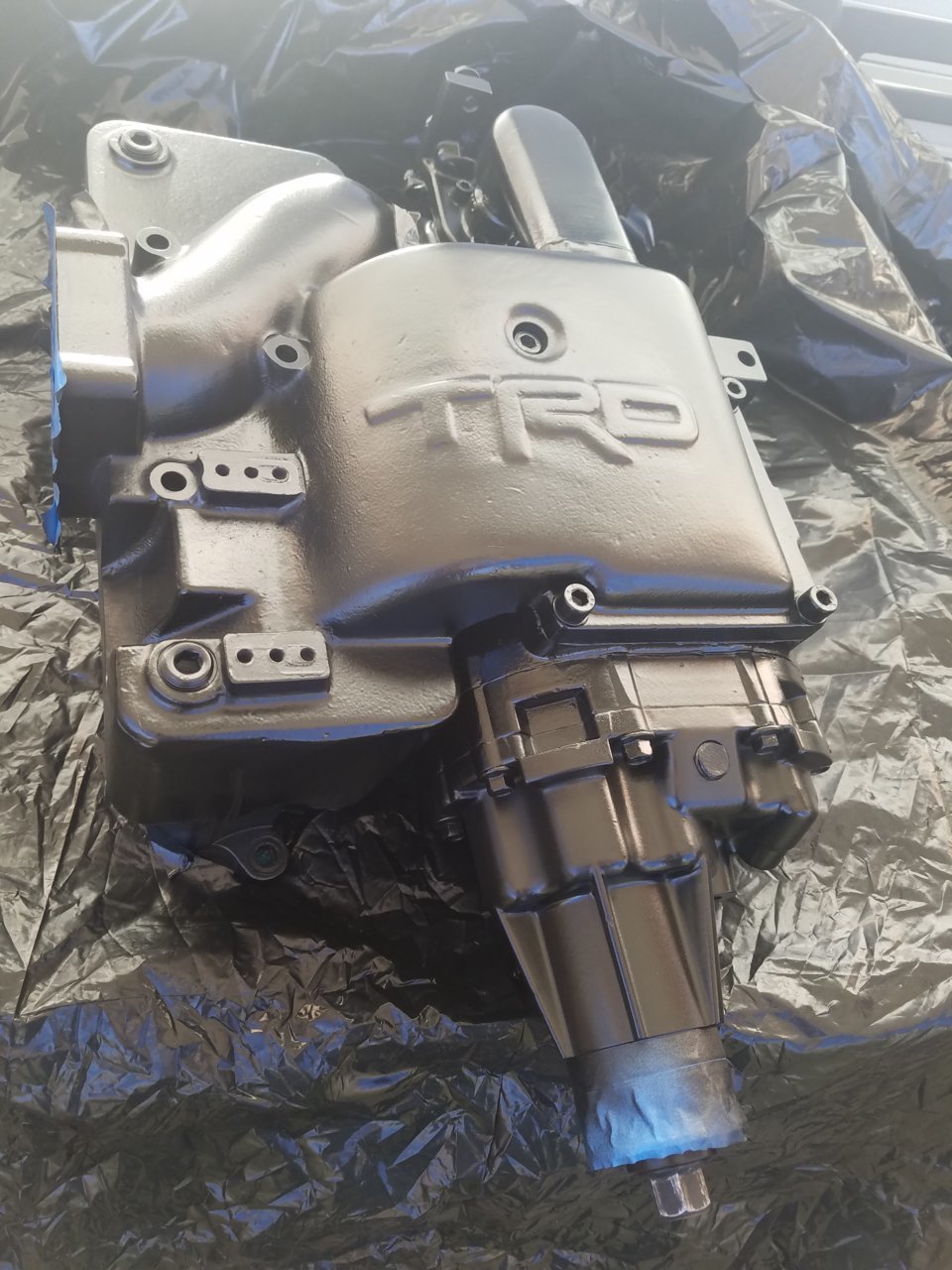

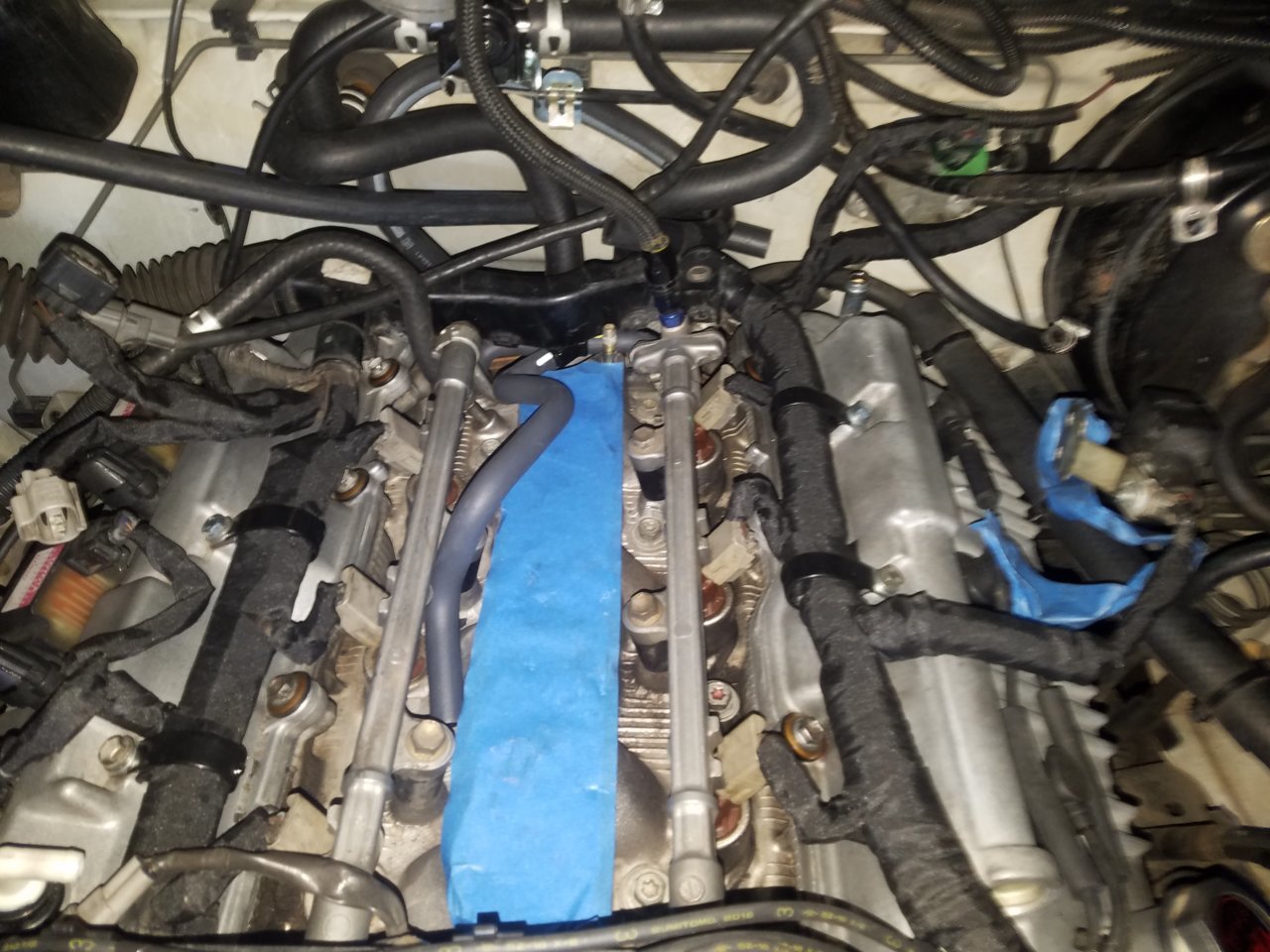

    Well I’ve been busy doing maintenance while waiting for the supercharger to get rebuilt and ported for the last 3 weeks at 576,000 miles
    Got new spark plugs, new spark plug cables, new Airfilter, new heater core hoses and heater core valve,
    new vacuum hoses, new fuel filter, new rear axle breather tube, fixed the wiring harness with TESA heat tape and new wiring harness brackets.
    AND got the supercharger repainted and back on.
    Not an oil leak anywhere to be found!!
    The porting of the supercharger definitely has given the truck a new kick and more timing
    than before.
    Has a bunch of new torque right off the line and new power above the 4000 rpm range.
    The timing goes up from 16 degrees at 4000rpms to 21 degrees at 5000rpm
    where as before the timing peaked at 16 degrees at full boost.
    I have to get a new dyno to know the actual results

    Curious where you got your snow Performance Stage 2 kit? Spoke with them today, they said the only one they offer with just the boost port is the vc50, the VC-20 is the older one they don’t offer any longer
    I don’t mind the gauge one , I would have to get a two gauge pillar mount tho
    The box one would be easier to hide

    1st pic is what I want
    2nd pic is what most of the kits out there are

    Looks like all you need to do to get the same function is turn the first dial to "Boost" then set the second and third like you would the other unit. Looks like you can just wire in mad voltages if you wanted. Super simple looking. Guessing if you read the manual it would be more specific ;)

    My only thing is I don’t want to tap into wiring , I would rather run a vacum line off manifold

    Why? Not hard to tap some wires. Technically should work better off the mad voltages anyways
