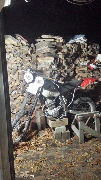

    Horizontal on your lights. Vertical looks like a junky Buell. The Cycra guards/flags are built like tanks.

    Seems to be the consensus! If I don't get to it before this weekend, I'll mock it up both ways and have pictures of the lights on the bike. Aluminum is easy enough to work with, thankfully!

    Lights are going on horizontally! Hooray decisions! Thanks for the push everyone.

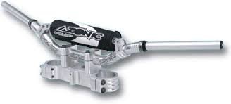

    Got'cha. Maybe a capacitor type system would work for you then? Way smaller and lighter. Again, if your sporting a 200watt stator I just don't see the need, but I'm old and slow. BTW, I found a pic of my old one the day I sold her. A sharp eye will find a very unique mod.image.jpg

    Your fork tree? Looks different to me, but My eyes aren't too sharp... :( nice looking bike by the way!
    The stator and R/R should work fine. I'll wire it without the battery first, and if it needs one it'll be easy enough to add one! Appreciate the knowledge @t4daddy!

    image.jpg Nailed it, I scored a 1 1/8 bar top clamp for just a bit more than cheesy adapters. Ran Azonic Doublecross bars in LaRocco bend in them. Plus (it's very hard to see in that photo), I made some brackets that bolted to the triple clamp to tie my bark busters into. The weird bars made using a standard clamp impossible.

    But that's really cool actually. definitely more beefy than the adapters I have for the pro taper bar...

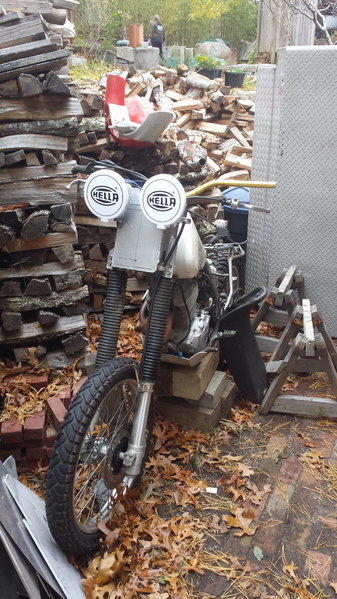

    Mounted the lights!
    Then started to figure out the rat's nest of wires... And start putting things in place!

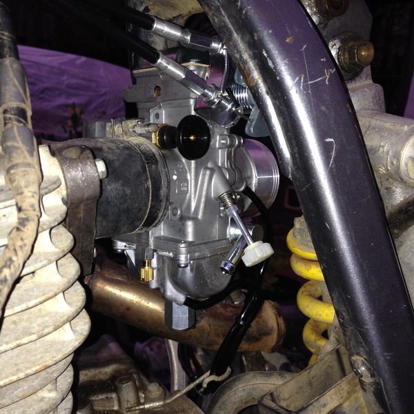

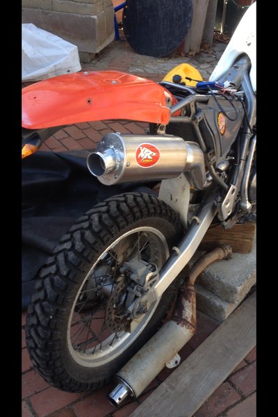

    Did a valve adjustment, and fixed the autodecomp and lever. It was buggered. Think it may have been contributing to my low compression issue, but still need to do a comp test. Once I get the tool... Anyway! Runs strong. Installed some new goodies.
    image.jpg New Mikuni pumper carb.
    image.jpg New exhaust from al bakers XRs only. Oem exhaust was fugged. Sounds good.

    The pumper was by far the best mod I did on mine, that and the ohlins rear shock. Totally different bike after I brought the front up to snuff.
