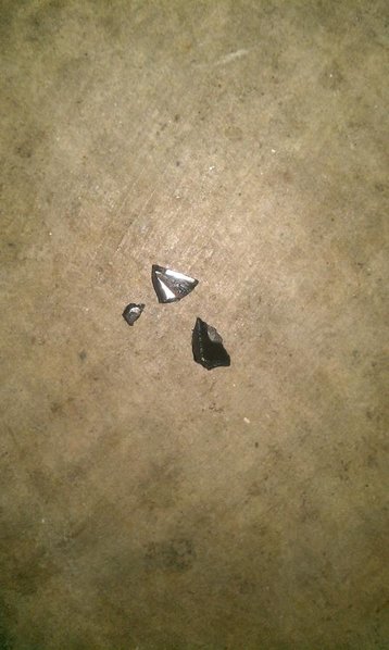

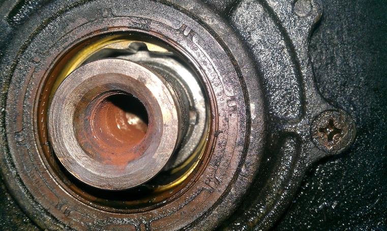

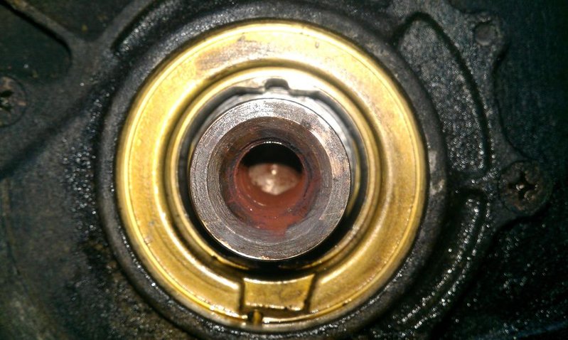

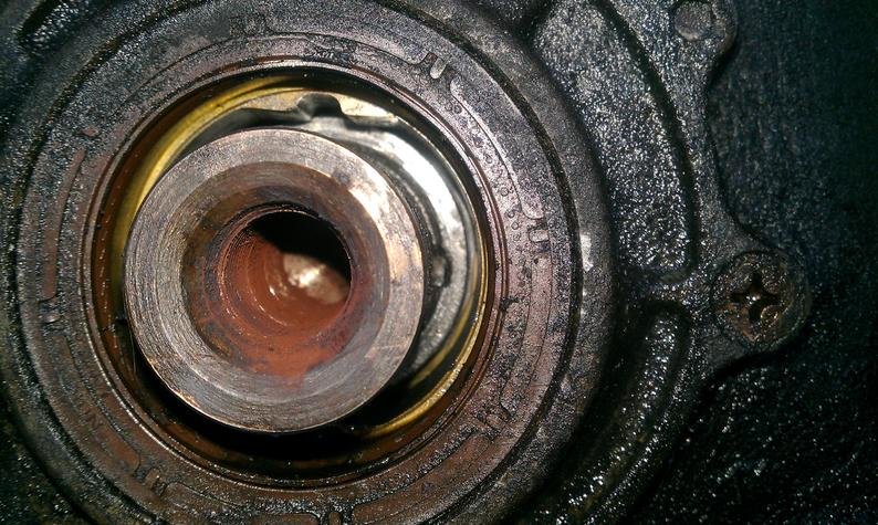

    see attached photos... long story short, if i think i see what is the wooddrift key right... its in half, with the one part for the timing chain still there and the other part for the harmonic balance, uh.. well... GONE :eek:
    so remember my first post on here.. the click click sound... well what i think happened was that the crankshaft bolt came lose just enough to cause a woble which cracked the balancer and wooddrift key... so the question now becomes this... to truely replace that key, i think i need to take off the timing chain cover, chain, gears, etc and install a new one.... MUCH more time and indept then i was just hoping for...
    or, do i really need the wood drift key, try to install the new balancer with it torque down (not what i am thining) but asking anyways..... this presumes the oil pump is ok... also is attached the bits and pieces of the balance that was left that i got out.... shaft looks to be good as i tired installing the new balance and its tight going on as it should be.... thoughts, ideas... i am open to ALL...

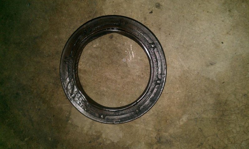

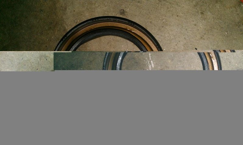

    see attached for seal that i got out too... i thought this was rubber? looks more like metal, with a spring... do i need this, thought it was replaceable?

    do you have a new HB? or is the old one OK? either way, just use a new woodruff key and torque it to specs. Is a part of the key stuck?

    I think the key also turns the oil pump rotor, but I'm not entirely sure. You will see when you get the oil pump off. There is a second key that aligns the crank timing gear, but that's farther back, and you shouldn't have to mess with that. You should have access to the key with the oil pump off.
    A new crank seal should be a complete unit including the outer metal part and spring around the rubber part.

    so i know i need a new seal... but i was suprised to see that it looks liek metal and not ALL ruber... thats all i am saying... interesting

    The online Toyota parts stores list 2 keys in the crankshaft section. One is listed for the timing gear and one for the pulley. Please post some pics once you get the oil pump off.
