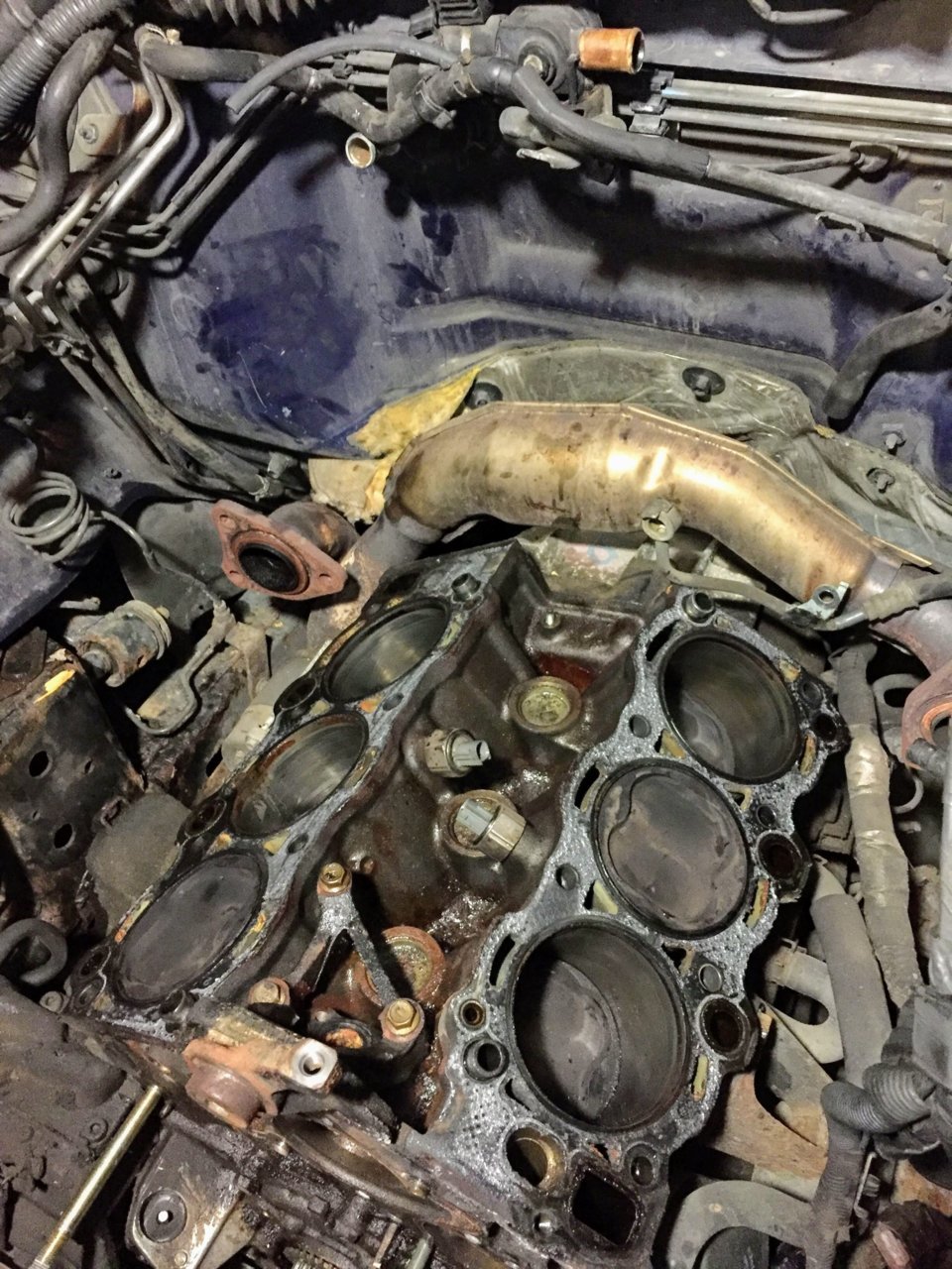

    I bought my 96 with 180k on it. Same issue. Oil was never milky and it smoked. There was just a pin hole leak in it. Two days of evening work and a rebuild kit from Rock Auto and I was good to go. Unless you wanna sell it?0BB5CC9A-54F2-46D1-A04F-A707222A6146.jpg
