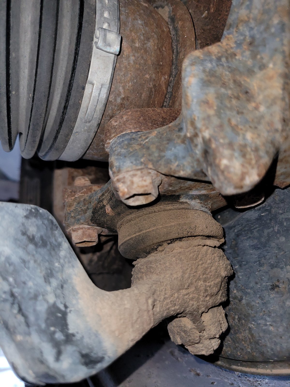

    Those LBJ protector boots, I haven't heard about them, that is somethi.g extra beyond just the normal boot that is wrapped around the ball joint? Not sure if that is something I should get?
    Here is my current LBJ:

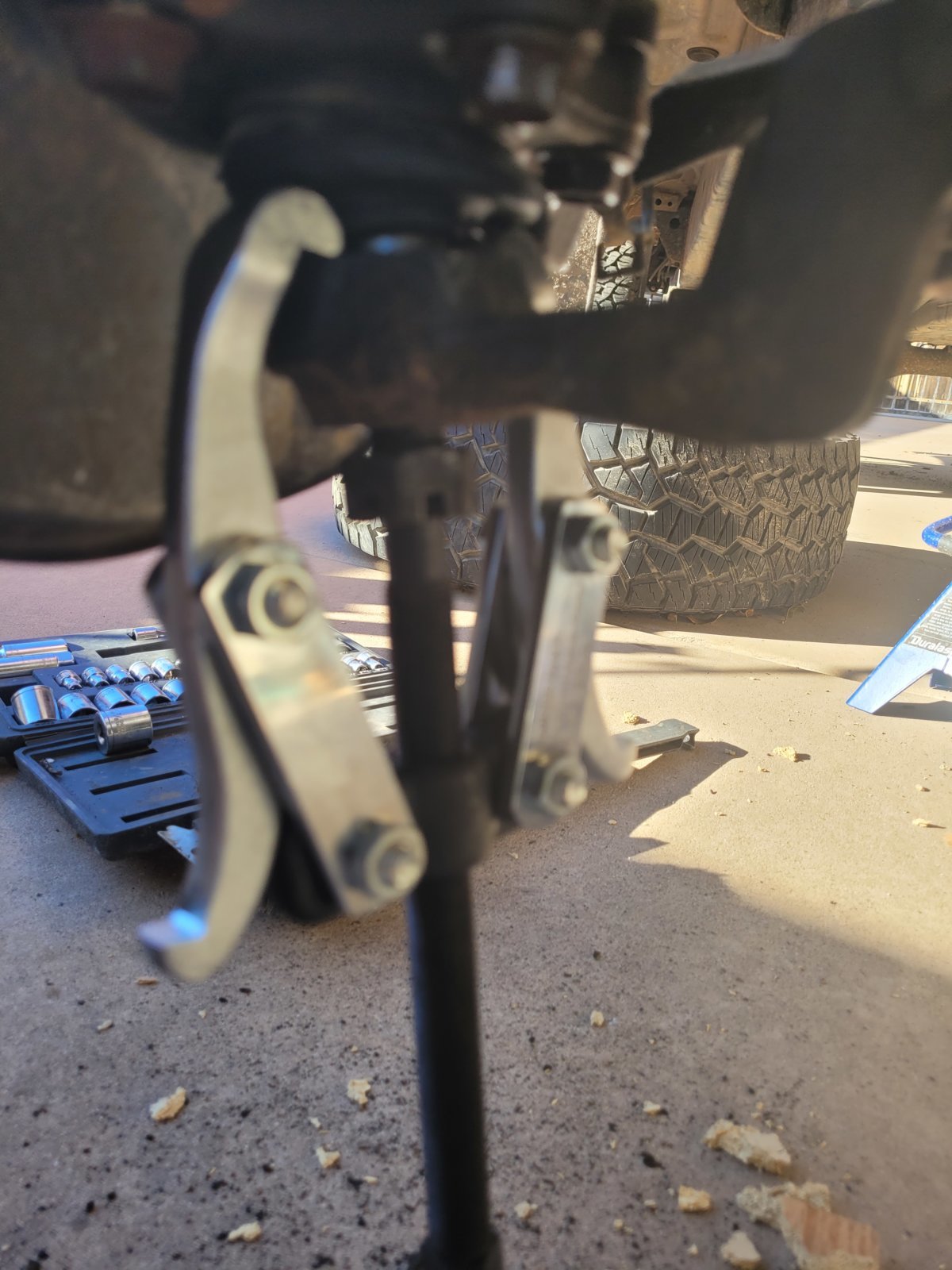

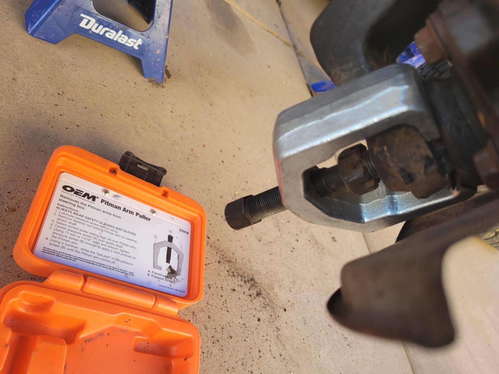

    In case anyone is looking to pull ball joints from a 1st gen tacoma, let me save you some trouble...
    The pittman puller needs to have a jaw opening of 1.25" or more, but less than 2".
    The first puller I bought from Oreillys was too small, wouldn't fit around shaft so top kept sliding off bolt. Ended up getting 3 rental tools from Autozone, they didn't have a full kit. Also they were clearancing all specialty tools, so was able to grab a 2 jaw adjustable puller. That one worked on all 3 ball joints.
    For the lower 2, the tie rod end and lower ball joint, a 1.25 to 1.5" puller would work the easiest. Here is the Autozone one to rent, #57016:
    And here is the adjustable 2 jaw one I bought that does all 3 ball joints, so it is all you need, but it does flop around and needs 3 hands almost to set up:

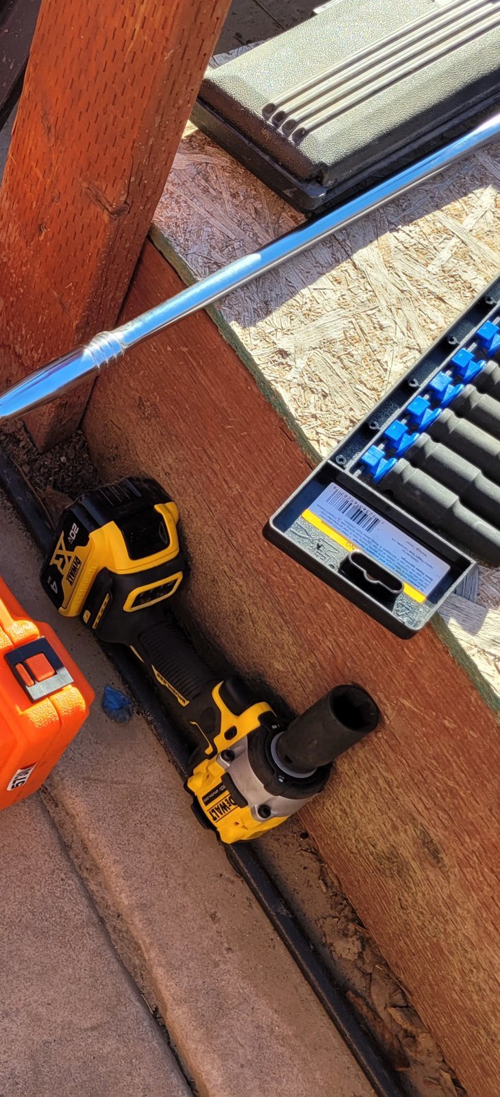

    Here is a tool and deal recommendation:
    The Dewalt 921 compact impact wrench.
    Small, compact, light. I was able to take off eveey single nut and bolt on my 98 tacoma suspension, no bolt had ever been loosened since new. So all brake bolts, the 35mm axle nut, all the castle nuts for ball joints, and all lug nuts.
    I watched about 30 videos from Torque Test Channel on Youtube. Basically the 921 was the best compact 5 months ago.
    https://youtu.be/yu1VGp-HSZs?si=9j-N1cftUW72CWGm
    Anyways, I went to buy this at HD, it was $219 with no battery. So I needed to buy a battery, dude takes me over to the Pre Christmas or pre black friday display they put up this week, where a 2 pack of batteries, bag, and charger were $199... and had a promo, buy the batteries and get a free tool! And the tool they were paired with for the promo was the 921 impact! So basically I got the $219 compact impact for free! And as I said above, it was small and could fit on all my suspension nuts, and did them all. I was pretty impressed!

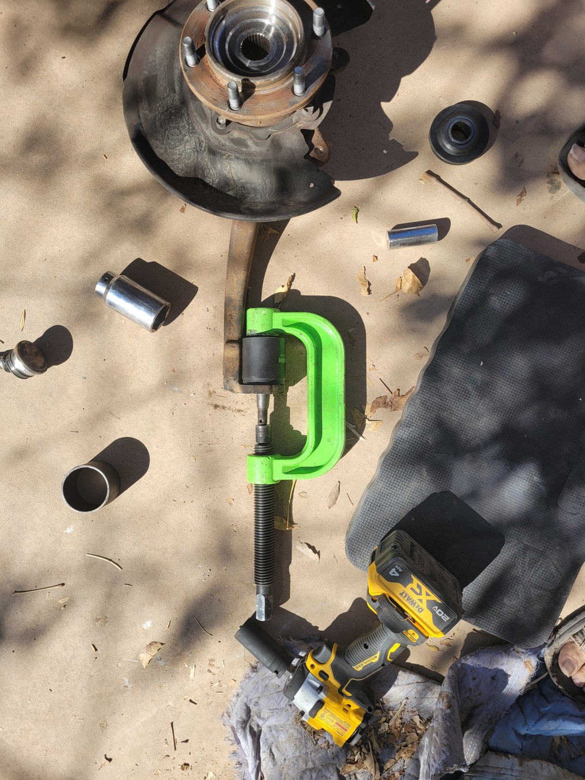

    Tip I found on removing Tacoma upper ball joint from knuckle. The curve bend of the knuckle doesn't let you line up the c press, so you have to flip it over and press ball into a cup, fine. But you then have to put a cup over the top of ball joint spindle too, so you can press on the rim of ball joint... even with the largest rental C press, you can't fit 2 cups plus knuckle in there.
    I've watched 10 videos of guys taking upper ball joints out of a knuckle, but usually Timmy is actually working on a 3rd gen 4runner and uses his 20 ton press. Crhis Fix uses the C clamp style ball joint and bushing press, which is what I can get. However he is working in smaller cars with smaller knuckles. So while it looks super easy and quick on all the videos, it's not.
    I ended up just pressing on the ball joint spindle, which looks like it will go cockeyed but actually worked well. Pressed the whole ball joint out easy. I figured worst case it would press spindle out and out of way, leaving joint rim to press out, but whole thing popped out.
    Couldn't keep it aligned using ratchet, so used impact wrench. The little 921 struggled, but did the job!
