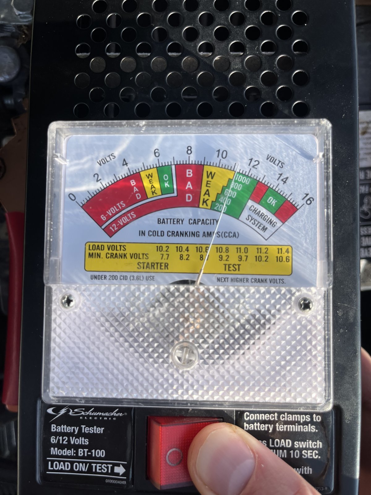

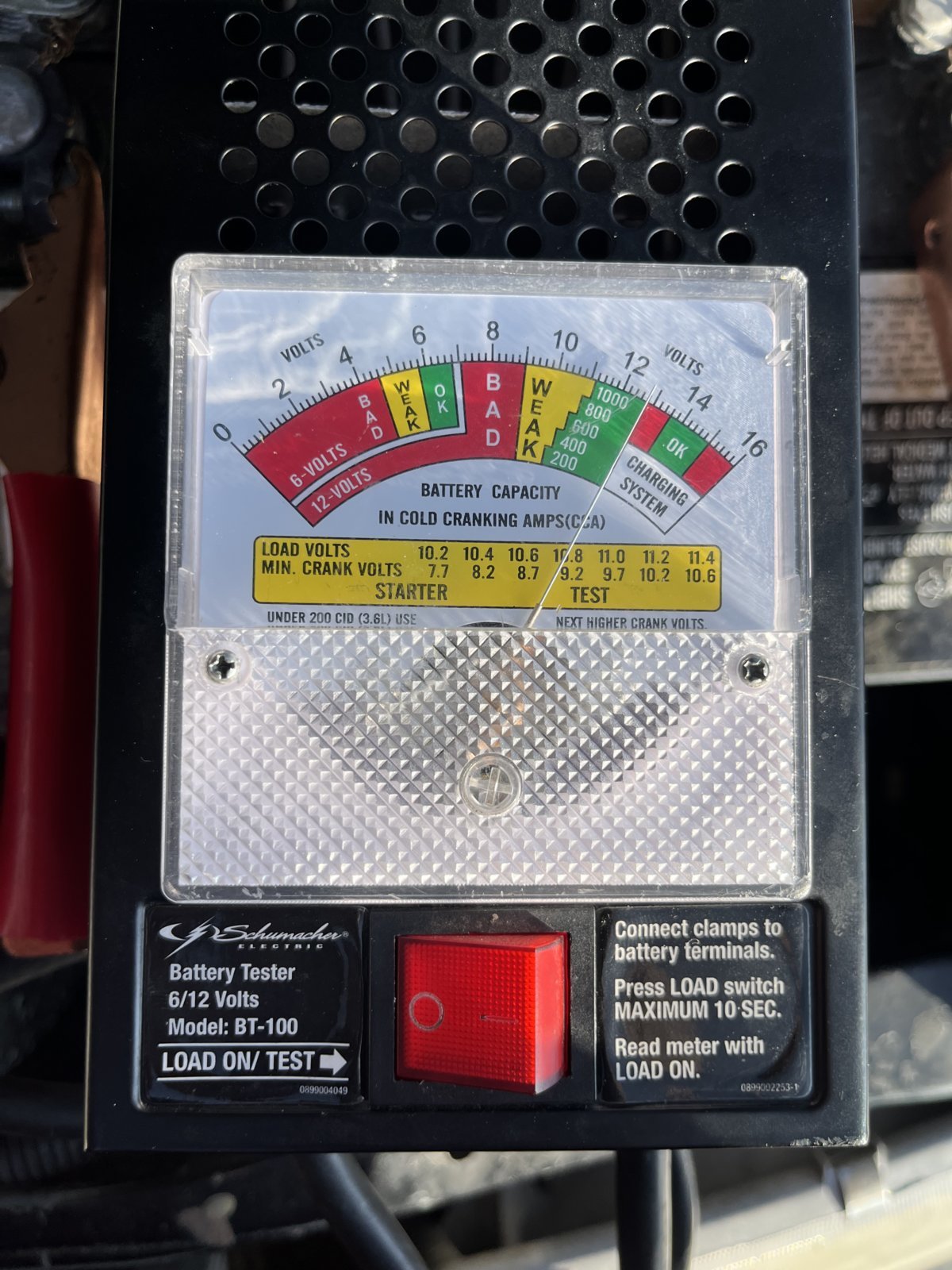

    jmreeder
    jmreeder [OP] Active Member
    Oct 25, 2023
    #436188
    34
    1998 Black Tacoma Regular Cab
    it’s right at 12.8 without switch on, and 11.2 with switch on, using this Schumacher volt meter
