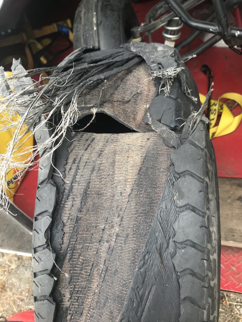

    On a side note. Went on a little vacation to Florence Oregon for the big bronco round up with the girlfriend and her family. Made the new truck work alittle considering I crammed her 2016 Tacoma in the trailer and her quad.
    Overloaded the trailer alittle bit, blew a tire and the brakes on the trailer took a dump but other then that it was a great trip! :angrygirl:

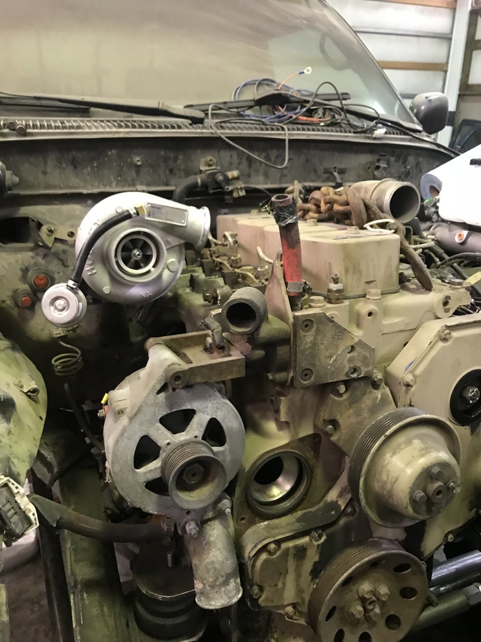

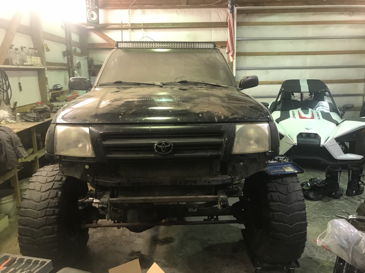

    341ABE7A-1CE8-4627-9270-A18E77E807CA.jpg 9AD28B14-B90C-4D8F-AF88-6378209C9C48.jpg Well started it in the truck for the first time yesterday. Should have videod it since I didn’t have the motor mounts bolted down all the way and it tried to turn over inside the truck :anonymous:
    But it only ran for about 30 seconds before it started leakin fuel out of a seal from the injection pump and a nice oil leak from the turbo, so I’ll take care of that before I make a video. Still has no trans but it runs!
