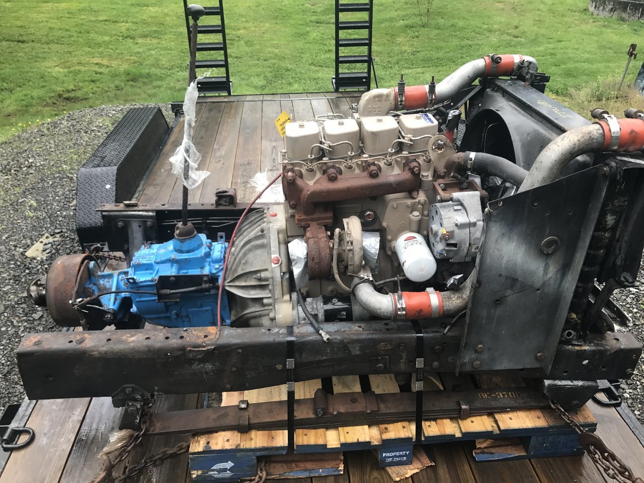

    Yes sir. That is. Here it is when I first got it. 4733ACDD-3946-461B-A229-8AA870FB4DAD.jpg

    Interesting how they shipped it on the frame like that, any idea what vehicle it came out of? Why did you chose that specific Cummins, or a Cummins in general as opposed to the Hilux equivalent which was the 165HP 1KD-FTV or the 1KZT-E? These guys do diesel conversions (for waaayyyyy too much) http://dieseltoys.com/tacoma-diesel-conversions

    This engine came out of an old bread/ shipping truck. They just cut out the engine package and shipped it. Even had the front leaf springs from the truck still attached to the frame. It’s just the easiest way to remove it complete from the truck and still runnable.
    I chose this engine for a lot of reasons because I couldn’t stuff a 5.9L into this truck and I have a bunch of parts laying around that I can use with it. Along with the fact that this is a very simple engine I’m very familiar with and can produce significant amounts of hp and trq out of.
    All in all I really just picked this because I couldn’t get any bigger one in there, it’s very different and most of all. Just cause I could.

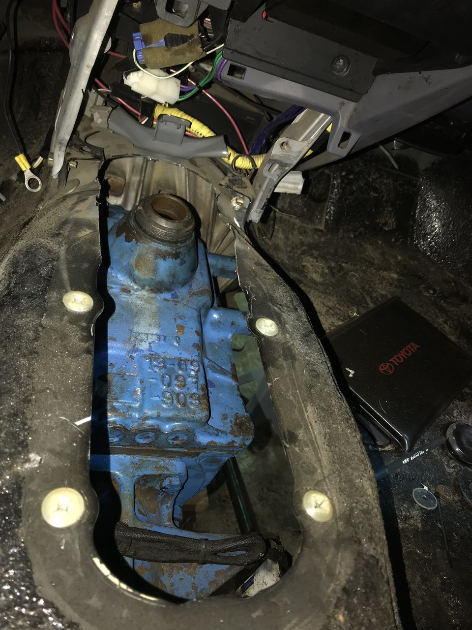

    Cut out the trans tunnel to get to the shifter for the trans. 8DC186F6-E5CB-4AD7-B998-12617AE652BD.jpg

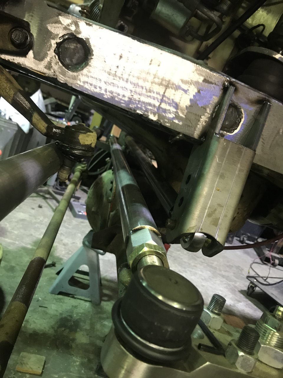

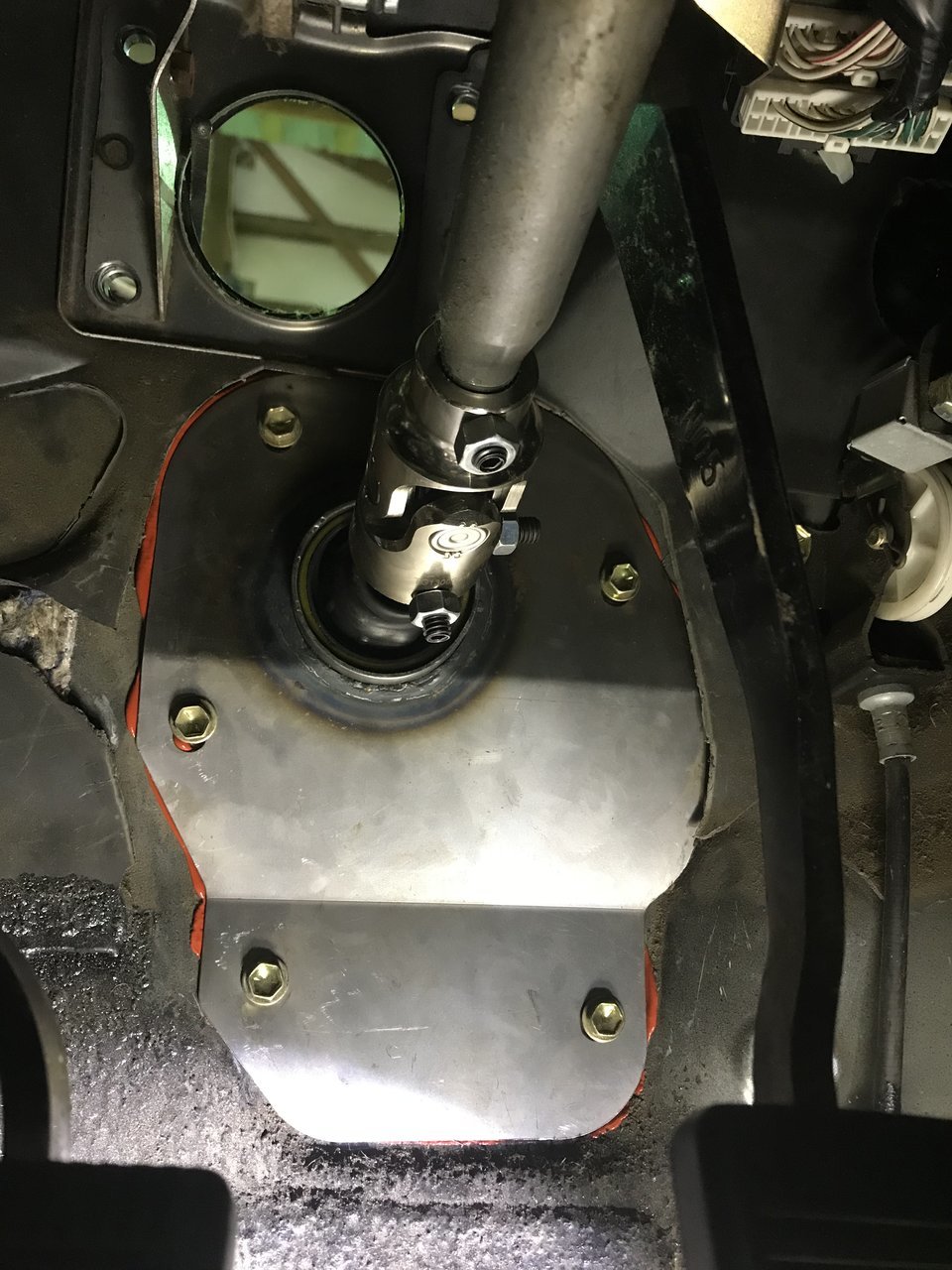

    Got the steering swapped over and box mounted even tho it’s not a rebuilt box as of yet. Got the drag link racked up and mounted along with starting to figure out where to mount the pan hard.

    The panhard bar appears close to the pan, or is it an illusion?

    ... agreed. It just appears close to me.

    It is very close about an inch really, but this is at complete compression and will never be this close due to the fox bump stops.
