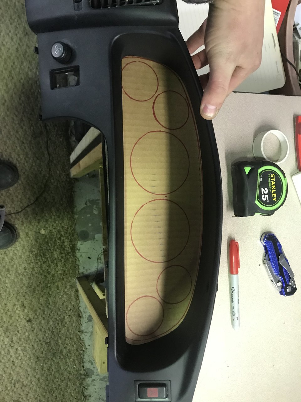

    Started mocking up how a new cluster might look.

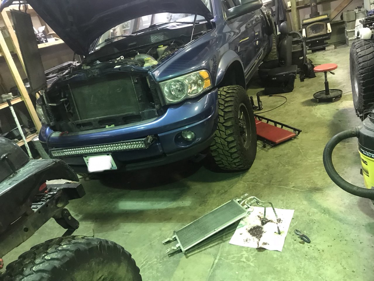

    And ripped the trans cooler out of the tow truck to replace it and a line. Think I might sell the truck here in a few months to pay some stuff off.... but idk.

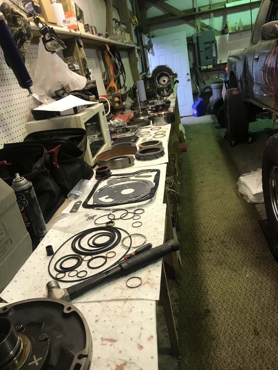

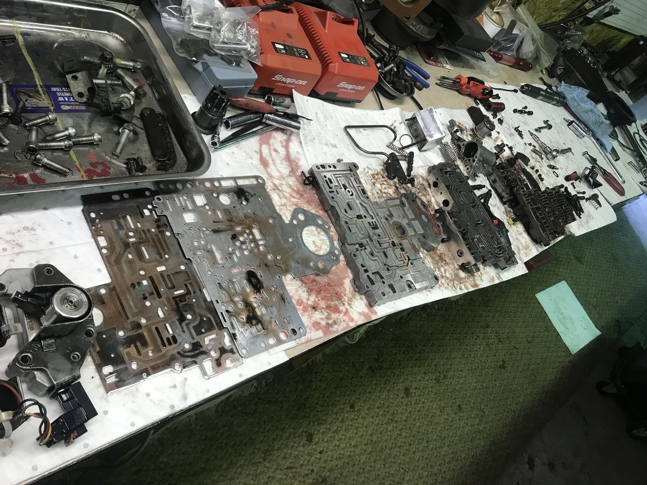

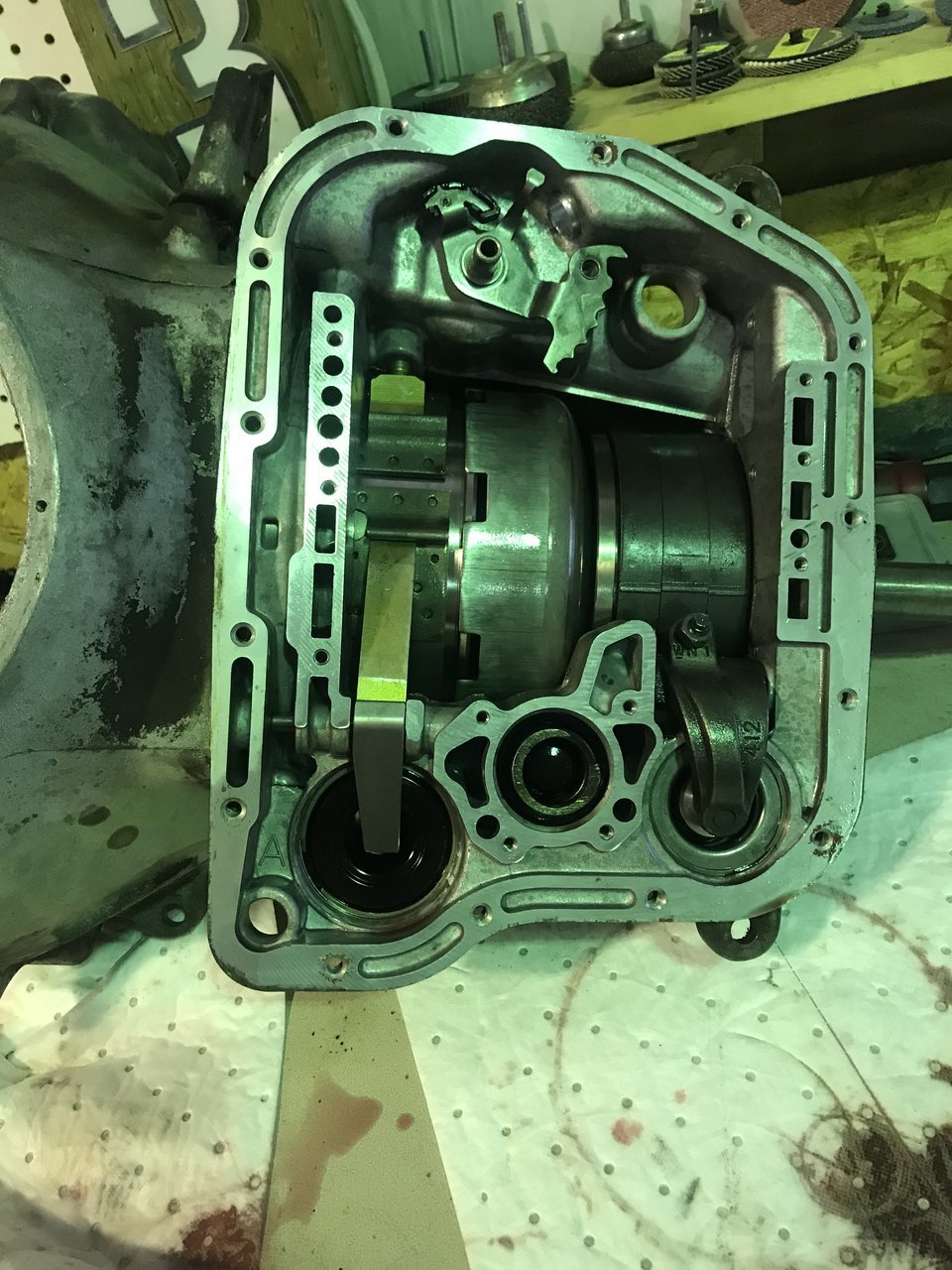

    Love to say I’ve made more progress on the yota but the frickin dodge is taking up my free time.
    Trans cooler is on and main section of the trans is together. Going to get the valve body cleaned up and put back together tomorrow after work. Then on to the overdrive housing on the trans. 1A2FDA71-6AB9-498A-B506-9DAD9369B272.jpgCA7758F6-4004-435B-8252-C28618348B2B.jpgA0604E2F-C7BD-4F43-8895-A4BC83DC3A7D.jpg

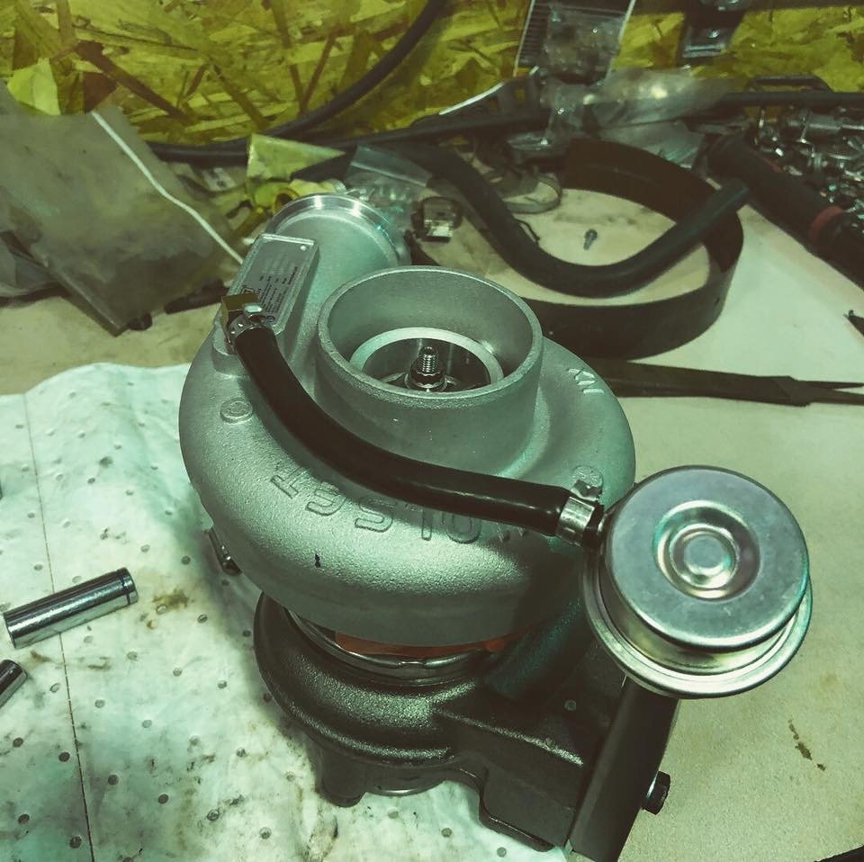

    Small update.
    Dodge is back together, tested, checked, inspected and up for sale.

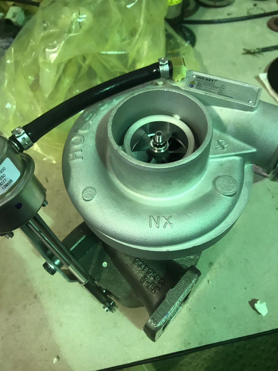

    Also my girlfriend got me the turbo I wanted for the 4bt!!!
    44mm holset hx30w :bananadance::bananadance:
    Now all I need is an oil pick up tube and oil lines for the turbo and she will be ready for a getto testfire in the truck!! :burnrubber:

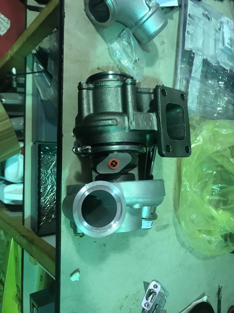

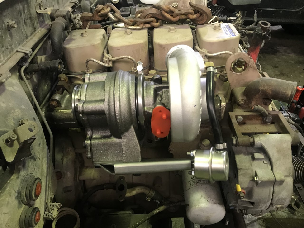

    That it has. Rebuilt the entire front end on the dodge and transmission. That took awhile.
    But should be hearing this thing fire here in the next week or so!
    Turbo looks tiny when my fat arse is holding it and next to the engine but it will support a ton of fuel and works awesome in the twin set up I’ve got planned.
    But me doing a test fit.

    One thing after another! :annoyed:
    Need to buy another manifold and cut it so the outlet is between 1&2 in the up position to make this turbo work.
    The manifold I roughly made has outlet at an angle right in the middle between 2&3 and that’s a little to tight all around up or down.
