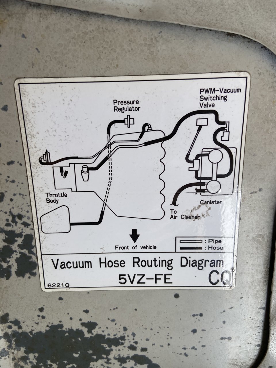

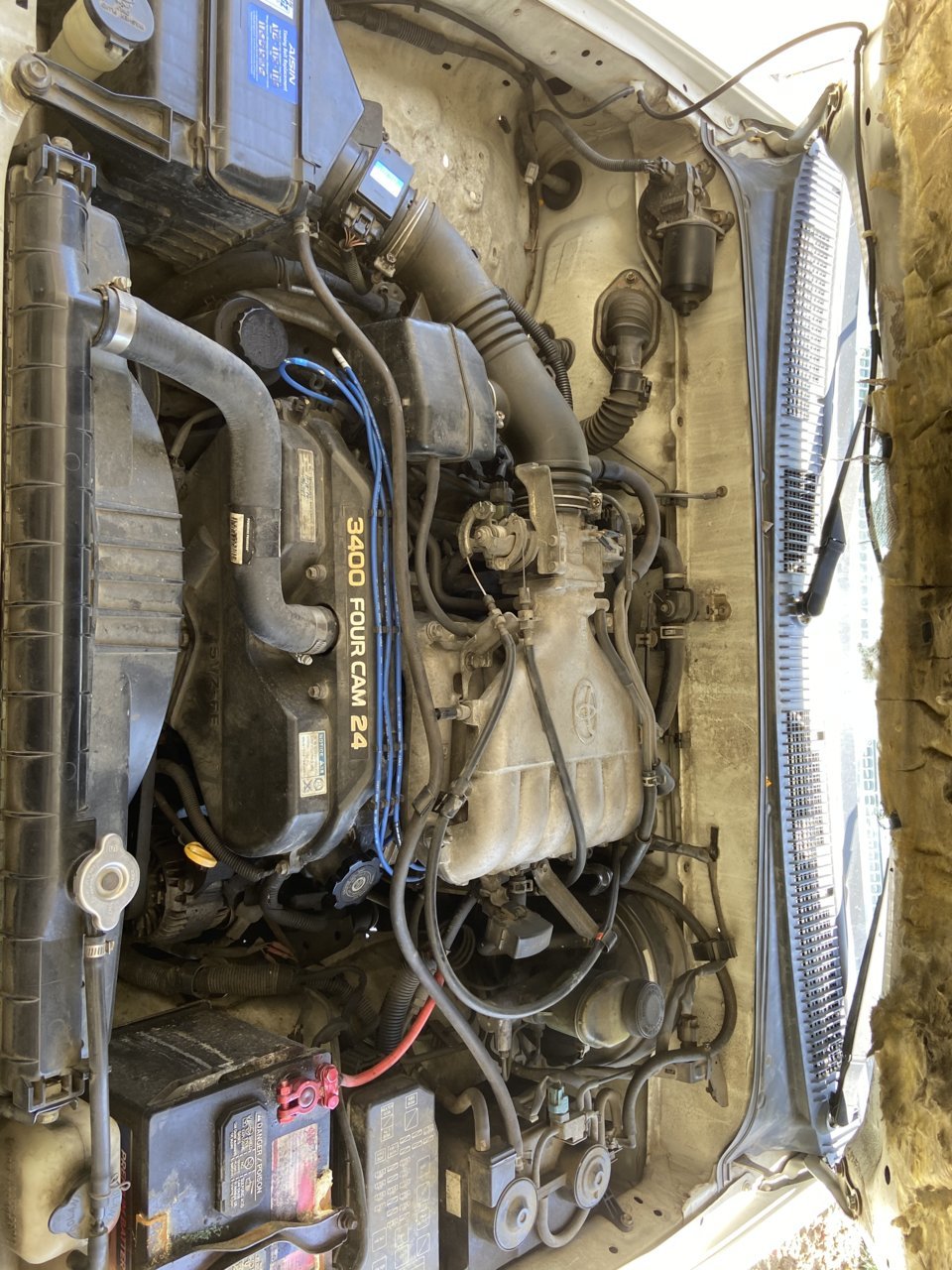

    Dillon
    Dillon [OP] Member
    May 29, 2015
    #156320
    11
    Dillon
    1998 White Toyota Tacoma TRD
    7EDBCC3D-0248-48F4-883D-3EED9A024821.jpg 165A47F8-4B83-4451-860B-7F8CD43519BC.jpg 3A455DC7-ADA3-49AC-8EF8-3FA8C09F0B11.jpg
    My truck has CA referenced on the sticker but was originally purchased in Hawaii

    DrZ
    DrZ Well-Known Member
    Dec 14, 2014
    #144262
    1,459
    Mesa, AZ
    96 2.4L 5-speed
    Looks like you don't have the EGR. NOx is usually caused by high peak combustion temperatures and an EGR system can lower the peak temperatures. It could also be from over advanced timing, but the computer should control that. Maybe a lean mixture, but computer should control that. Maybe carbon buildup causing higher compression. Maybe a knock sensor not working correctly, which would detect pinging caused by high combustion temperatures and reduce the spark timing advance. If everything else (sensors, etc.) appears to work, then I guess a new cat might be your best bet.
