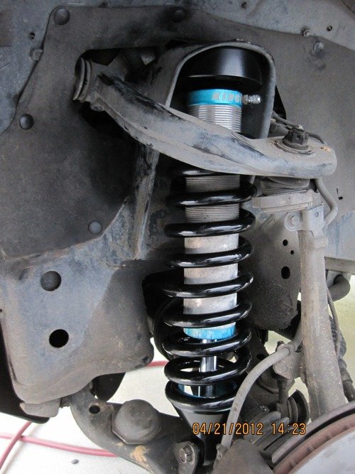

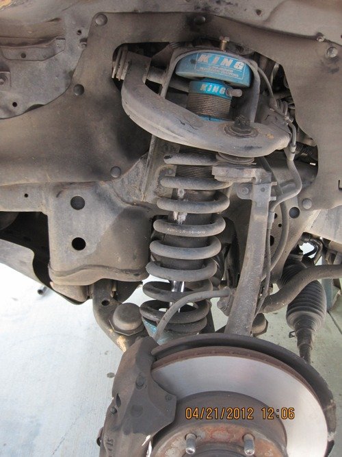

    cleaned up my coil overs over the weekend here are some before/after:

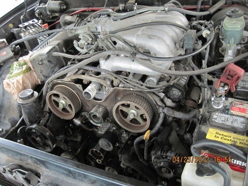

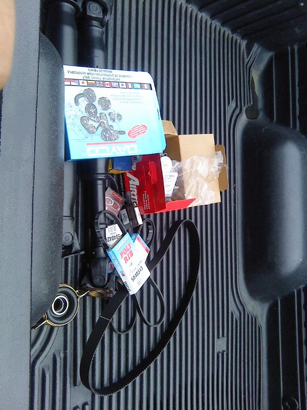

    Today i started on the timing belt, and now im waiting for the timing belt, tensioner bearing, idle bearing, and water pump to come in. Then ill be adjusting the valves.
    here is a picture:
    oh ya i also ordered a deck plate off ebay to mod my intake, should be here tomorrow or thursday.

    Just a little update...
    carrier bearing came in from rock auto so i reinstalled my drive shaft.
    Also bought cam seals, timing belt, fan belt, thermostat, water pump, and tensioning bearing.
    still have to adjust the valves which will be the trickiest part. but hoping all goes well im itching to drive it already!

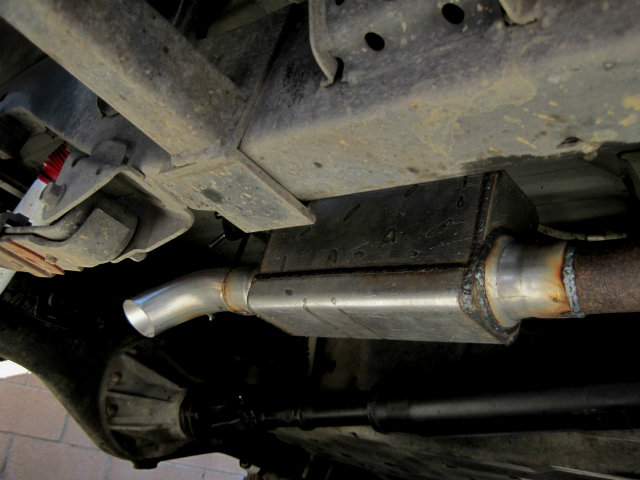

    Drove out to riverside today with my buddies and picked up a muffler from rob over at spintech.
    Ill have pics of the actual truck soon, just been lazy and enjoying my truck.

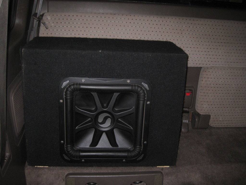

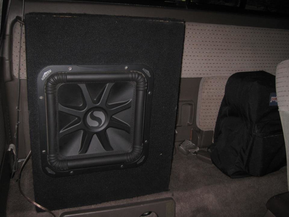

    Made some little feet for the bottom of the box so the wires wouldnt be crushed and i flipped the box around so it should sit the way it should and tucked up the wires, cleaned up the sub as well so now it looks all shiny.
    the measurements are:
    17tall X 22LONG X 8-10(the side of the box goes 8inch at the top then widens to 10 inches at the bottom of the side)
    EDIT: im getting a ported box so if any one wants this ill sell it, i also have some add a leafs if anyone wants to buy some

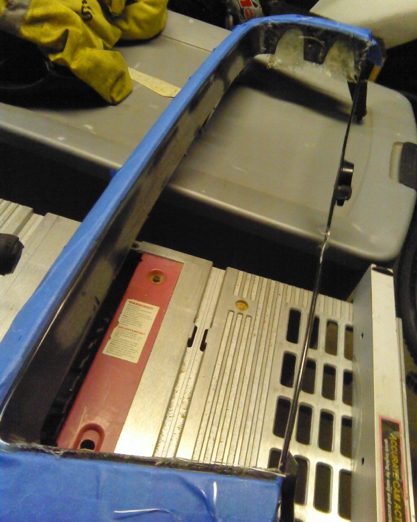

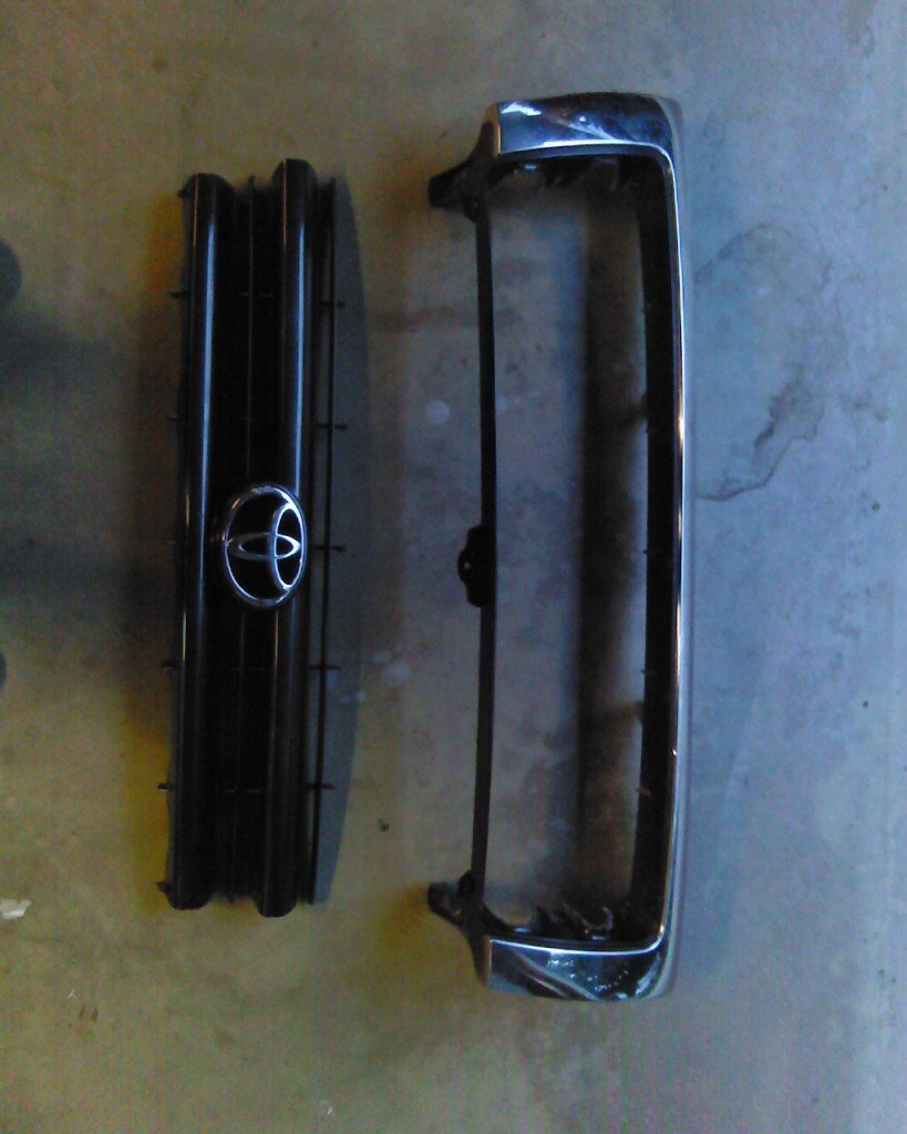

    So today i sacked up and finally decided to cut up my grill haha
    this is such and easy cheap mod, from what ive read people make it seem like a big task but in reality its really simple.
    ill give a few tips which will hopefully help people on theirs.
    1. use a sawsall to chop the center out.
    2. use a grinder to even out what ever needs to be grinded away. dont stick to one alternate to let one cool off then go back to it so you wont melt your grill.
    3. buy the roughest sand paper you can find which is 50 i belive to make sanded easier.
    honestly the grinder made things go by so much faster, i used a grinder with a flap deck because i dont have a sander so ya that works just be careful not to melt it.
    Here is where i left of today:
    cut it,sanded it, and fiberglass.
    left it drying and will finish it tomorrow and will post pics of the final product.

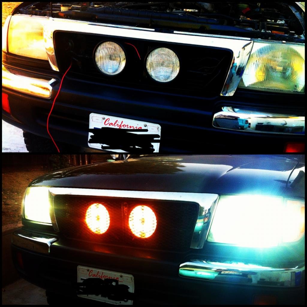

    Scored some hellas at a swap meet in hesperia for 5 bucks this weekend, one of the lenses is cracked but they work. mounted them behind my grille today.
    I will convert them to 55w 45k soon

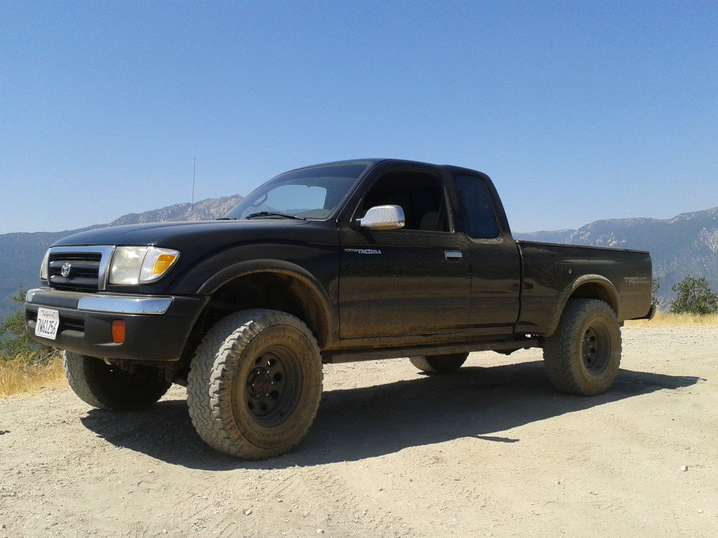

    Sorry haven't been on here in a while,
    The first picture on the very first page when I first bought the truck you can see it sits level with it and then the one where I'm in the mountains you cAn see it has a bro lean without it
