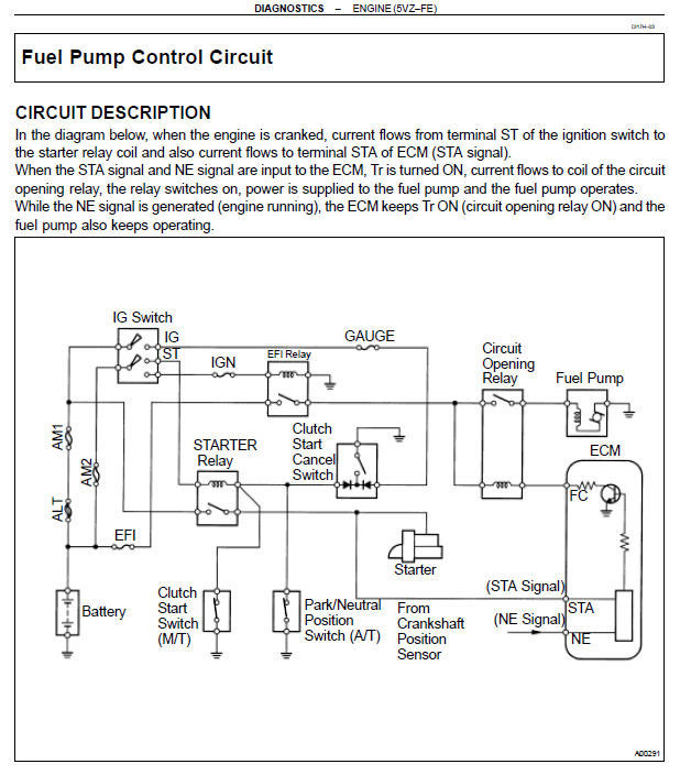

    There are 2 relays in series powering the pump.
    Below is for a V6, the 4cyl uses the cam sensor not the crank sensor, everything else is the same.
    It should be noted that the STA signal is not required for the ECM to allow the pump. It may override the NE signal when cranking but I have never tested it. (Man trans guys can push start without the starter in the picture at all)

    I was hoping you'd chime in dirty pool. Sounds like you're saying the same thing Bama did in that link i copied. Good, I was hoping I pointed him in the right direction. You guys know you're stuff, that's for sure.

    Ok so I located the COR and I'm doing some tests and when I energize the coil with my meter on the contacts to check for continuity the meter beeps for a second and then reads 126 ohms on that contact and if I set the meter to just ohms it reads 129 ohms. Now according to the COR diagram I found online that should be a straight contact with no resistance am I correct or not?

    New info With the COR in the plug i stuck a meter in the back of the plug and using this diagram i found in non start situation i have 12v on
    B+, and FC.
    and when i try to start the truck i get voltage on FP to the fuelpump and the voltage drops to like 11v on FC but that may be due to battery needing a charge at this point (plenty of crank left in her) so what would my next step be
