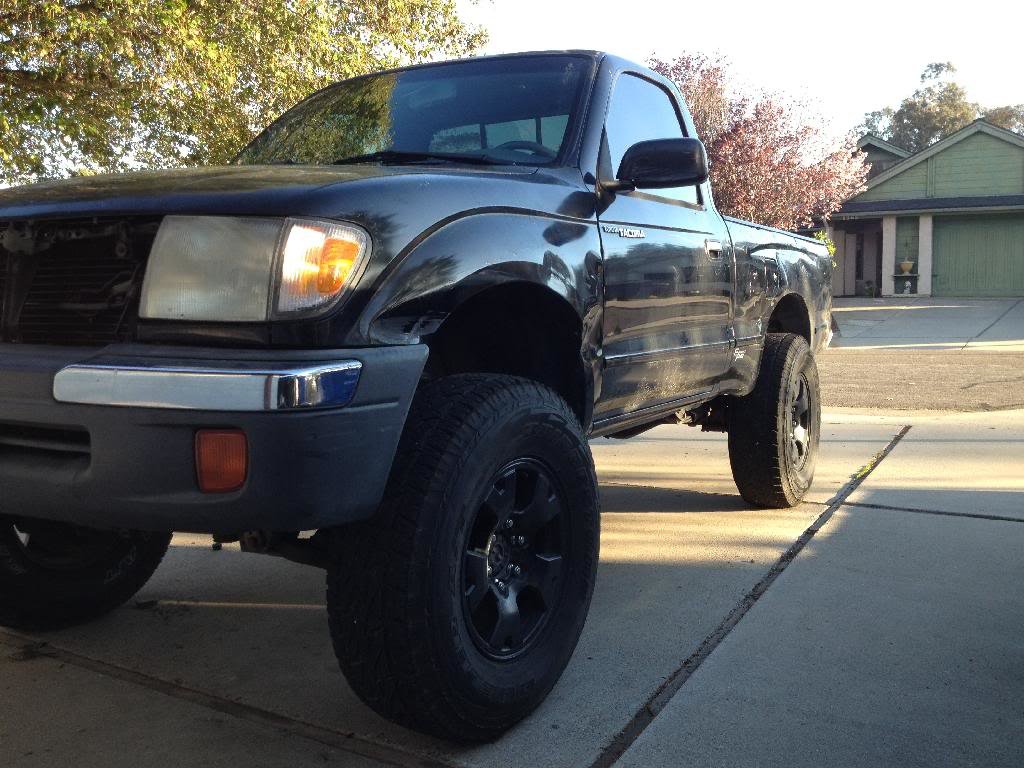

    Heres a couple better pics of the truck:
    this is of the "low" side of the Taco lol
    2F25E418-B6FE-4A06-8353-885545C55278_zps_6e6570a5eabdf942a52318a633e09b00f654ea7e.jpg
    A12F5D5E-470B-471C-A6D3-A56B06C3CC23_zps_b15ba0f95f0414a3ba6029d820039c1c22f248ec.jpg

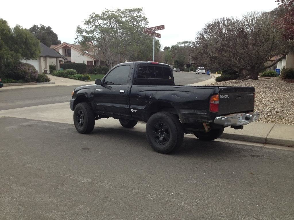

    Update:
    just wanted to post an update on the suspension. The truck handles nice and corners really well. I finally had a chance to rally it the other day and it did great. I took some nice mellow whoops at about 40 which was really fun, and did some nice hill climbs on some rock trails. I was really surprised how well the truck did, especially in 4 Lo. Overall really happy with the truck.
    I finally installed the polyurethane bushings on the steering rack and noticed a pretty good improvement. It tightened up the steering and improved the loose feeling when going over bumps at 40+ and turning slightly. Overall well worth the 20$ price tag at wheelers. It surprises me that the factory uses those rubber ones at all…
    22461b75-009b-4241-97a8-fe2c32ec98b2_zps_7b2b8040b3256c6e96dfb5b20d41dd2eb7e08575.jpg
    8d771cc4-6772-4cc0-8ffd-b1b320337628_zps_484a8a09da8a54005ebf5859b1f6ccc45ce313c1.jpg
    6c03b642-3aec-4c92-bf5e-1fba695d1d24_zps_7a02dd95e6de100ce77114285a6173a7814e290c.jpg
    a38550f2-c9c1-4dc5-b76e-492174d664c5_zps_8b3b06193de6a70fae3d43314d98704e8561147f.jpg
