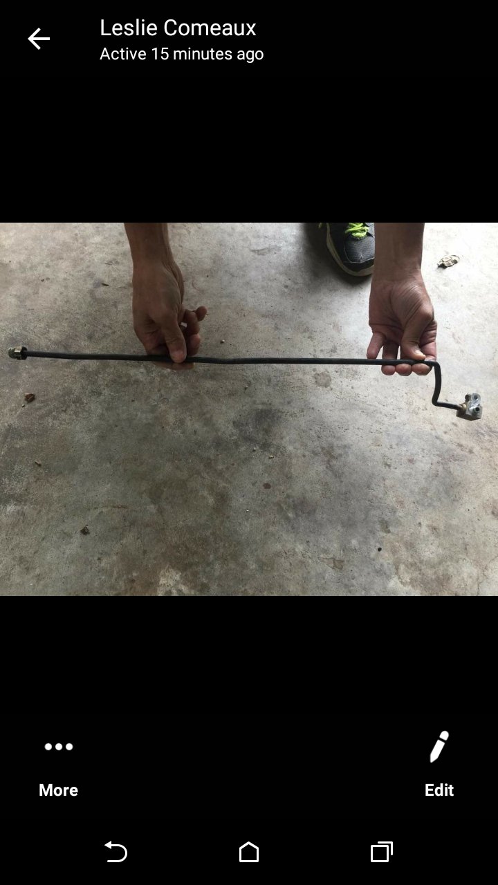

    Screenshot_2020-09-20-21-54-45.jpg can anyone please tell me if they recognize this part. I put the 2.7l from a 1997 in my 99 prerunner and while doing so made the mistake of not taking photos. A mistake that I will never make again.the replacement engine came fully dressed so some parts were not needed. Please if anyone knows what this part is it would be SO HELPFUL.

    That's an AC hard line

    God, I hope not !I was hoping to not lose my charge from my AC I'm proud of my air conditioner. It is one of the components that work so well in my truck.hope it was taken off of my donor.

    I was guessing at an ac line because the block (on the right of the photo) looks like it goes on a compressor or the condenser and the flare nut on the other side isn't anything I recognize from when I rebuilt my motor.
    It's definitely not anything attached to the motor anyway
