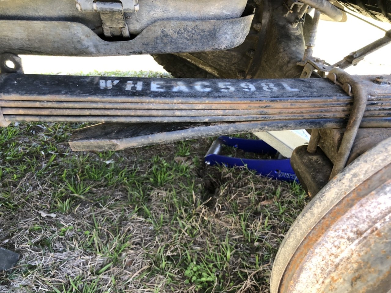

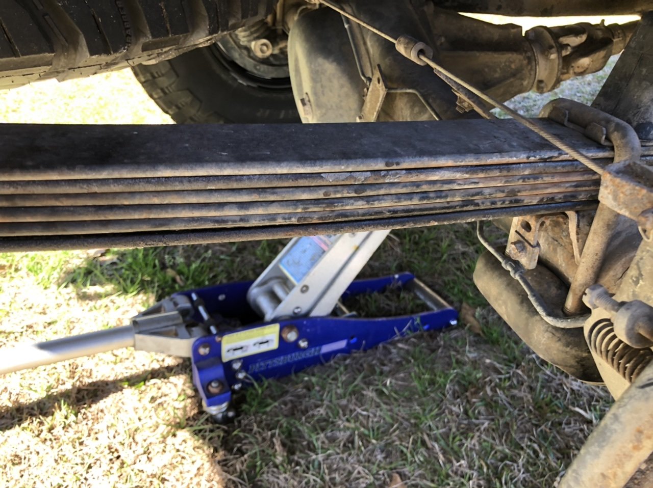

    I tackled the leaf springs last night and this morning. Went from 1/2” rear sag to 1.5” of rear rake. I didn’t snap many pics but basically went from a 4 leaf pack with an overload to a 6 leaf pack and no overload. I would’ve put an overload on, but didn’t foresee needing 7mm more U bolt to do it. Autozone had 1/2” and 5/8” U bolts, too small and too big. No time to order a new set at this point so no overload.
    I ended up cutting one down about an inch on the ends so that it would fit underneath and between the riveted clamps holding the remaining pack together. The older set of leafs were getting rusty after 9 years in the bushes. So I separated them and wire wheeled them down, then primed them with an acid-rust inhibitor last night before the game. After the game I sprayed them with rattle can truck undercoat.
    Super happy with the outcome and I’ll be making a road trip soon to ‘break them in’. Also happy that I basically got for a few bucks something between an 8 or 10 leaf Deaver style and stock. Like a best of both worlds.
    Old 4 leaf set on the driver’s side.
    “New” 6 leaf set on the passenger side.
