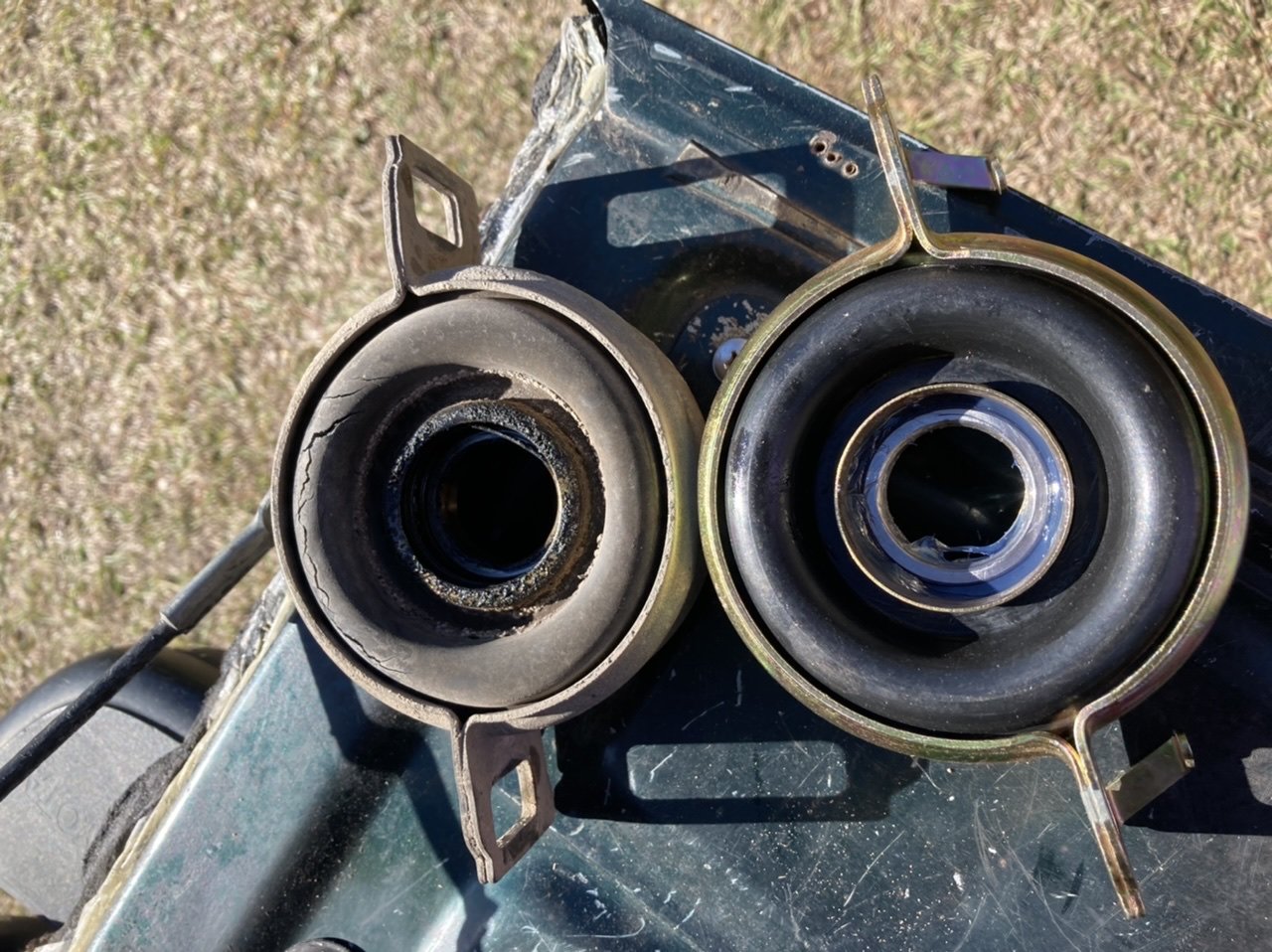

    I was crawling around underneath greasing up last week and noticed the rubber on my center support bearing was looking worse for wear. I had replaced the OEM with a RockAuto unit a couple of year back and at least 60k miles ago. So I figured it couldn’t hurt to put in a new one. Ordered up a National HB-26 and slapped it in this morning. Güdentïte cause you can’t get a torque wrench square on those bolts without pulling the entire driveshaft.

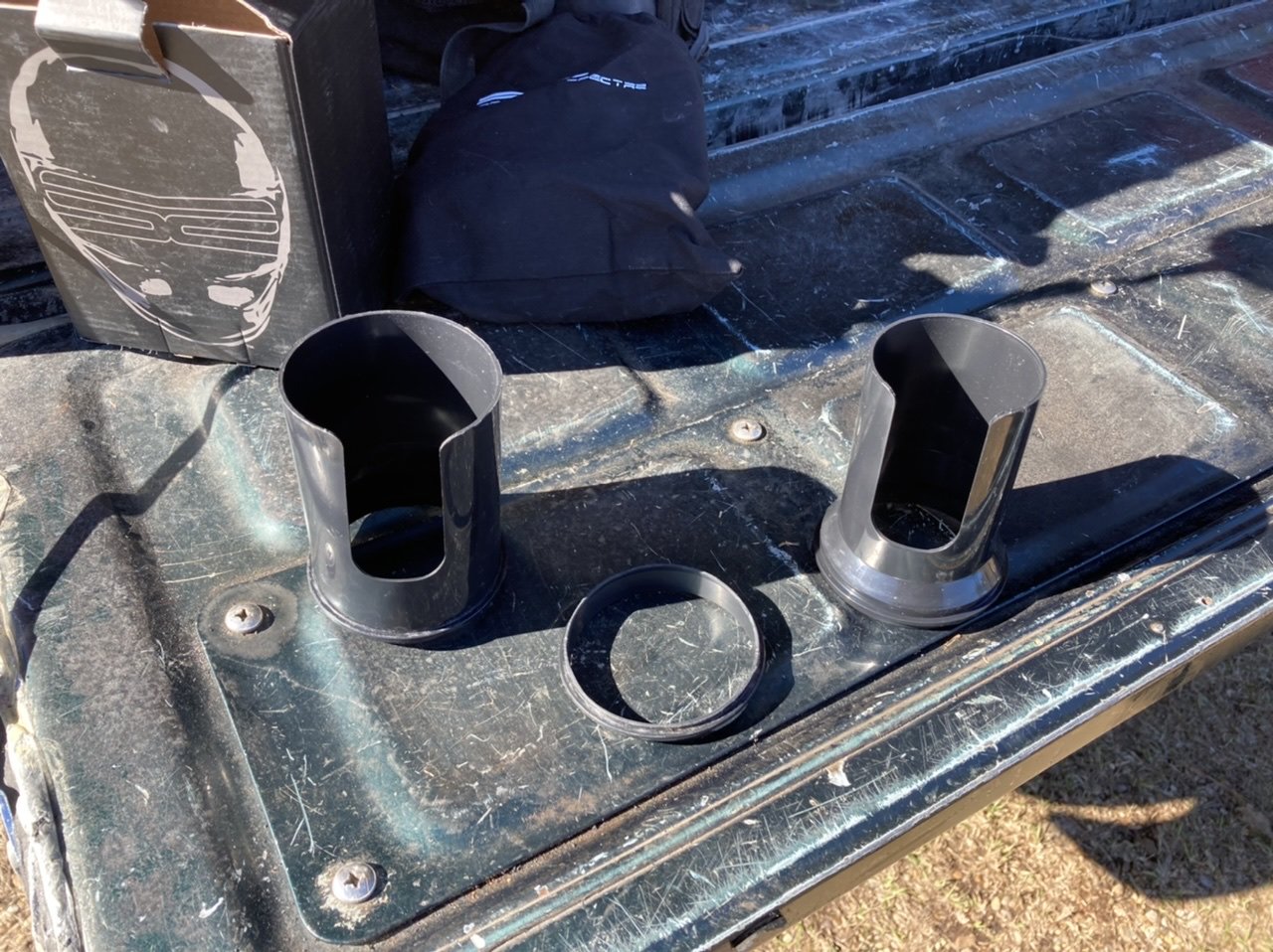

    As long as the truck is in closed loop it drives as it should. As soon as it hits open loop at any RPM it enriches out and shows 0.9v from both o2 sensors (catless). This is using Torque App to monitor things. Being I commute this long distances on the interstate it has become a nagging thorn in my side. I scooped up a set of used pink tops from a member here in hopes that my aging dual jet injectors could be an issue. Every plug change looked ‘OK’ aside from the constant running rich none were ever lean burnt or wet fouled. Same with the pink tops after 900 miles of rich open road conditions for hours on end.
    So, the only ways I can see altering AFR is either by fuel pressure changes, ECU changes, or MAF changes. Easiest for me was MAF changes. Either diode alteration or tricking the sensor physically. So I ordered one of those 3” Spectre MAF sensor housings and gave it a try. The largest insert is about 2.75”/69mm ID. Basically the same as the stock ‘99 3RZ and results were unchanged.
    So I removed the insert and let it be full 3” and closed loop was the same as expected. Open loop dropped to 0.0v and came back up to 0.1v on both o2 sensors. Wouldn’t call it a win but it is a change. Was hoping for 0.2-0.5v but I’ll take what I can. Just hope it doesn’t lean out too bad at higher RPMs because from a low RPM pull it’ll start at 0.8 and drop off to the 0.1 by 5000 RPMs.
    This kit
    And this adaptor for the stock air box. D0388955-C90F-4EA8-9B27-A3F03E2A206D.jpg

    This is where I’m at. Got the coupling installed and it looks a little cleaner. I used the middle sized restrictor and cut it down at the initial bevel. Made a pass on the highway and pulled over after seeing the numbers still rich. I cut back little by little over the course of 4th gear low to high RPM pulls. Got the volts down to 0.3v low RPM open loop pull up to 0.7-0.9v in the upper RPMs near redline. I’d imagine an airflow straightener would help smooth this out.
    I’ll be making a long commute tomorrow and see how this fares. I have the stock housing in my tool box.

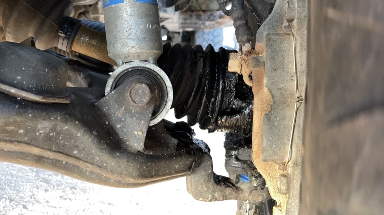

    Did an ECGS driver side bushing 4-5 months ago…or so. Truck just has felt like it’s been getting weaker and weaker as the years go by. Yesterday I changed the engine oil and lubed all the driveshafts and upper/lower ball joints. I had a 3x2” 45* silicone elbow I was going to use on my Audi project and realized it’d fit where the silly OEM rubber accordion looking intake hose is between airbox and intake mani. Put that in and the truck feels a little peppy. Could be placebo from the new intake sounds or maybe the cooler weather. I was feeling frisky so I bought some gear oils.
    Today I changed the transfercase for the first time ever at 225k. Then used MT90 in the w59 trans that had been wanting to get a little grindy 4to5th and 5to4th when shifting quickly. This cleared up. Last change there was about 62k ago. Did both diffs in parts house brand Dino and will change those again in 10-15k for some better stuff. Last on them wasn’t too long ago.
    No pic of silicone coupling installed but imagine replacing that rubber junk from post #85 with a proper length coupling. If you’re using the OEM MAF housing you’d need 3.25” to 2” with a longer leg on the 3” side.
    Edit: trans had a little bit of gold in it. Diffs had some metal but not bad. Driver side CV seal leaks bad and it’ll need changing ASAP. Going to pick one up tomorrow it’s that bad. Front diff has been running on oil only as deep as the CV and it’s got a lunchbox locker, too.

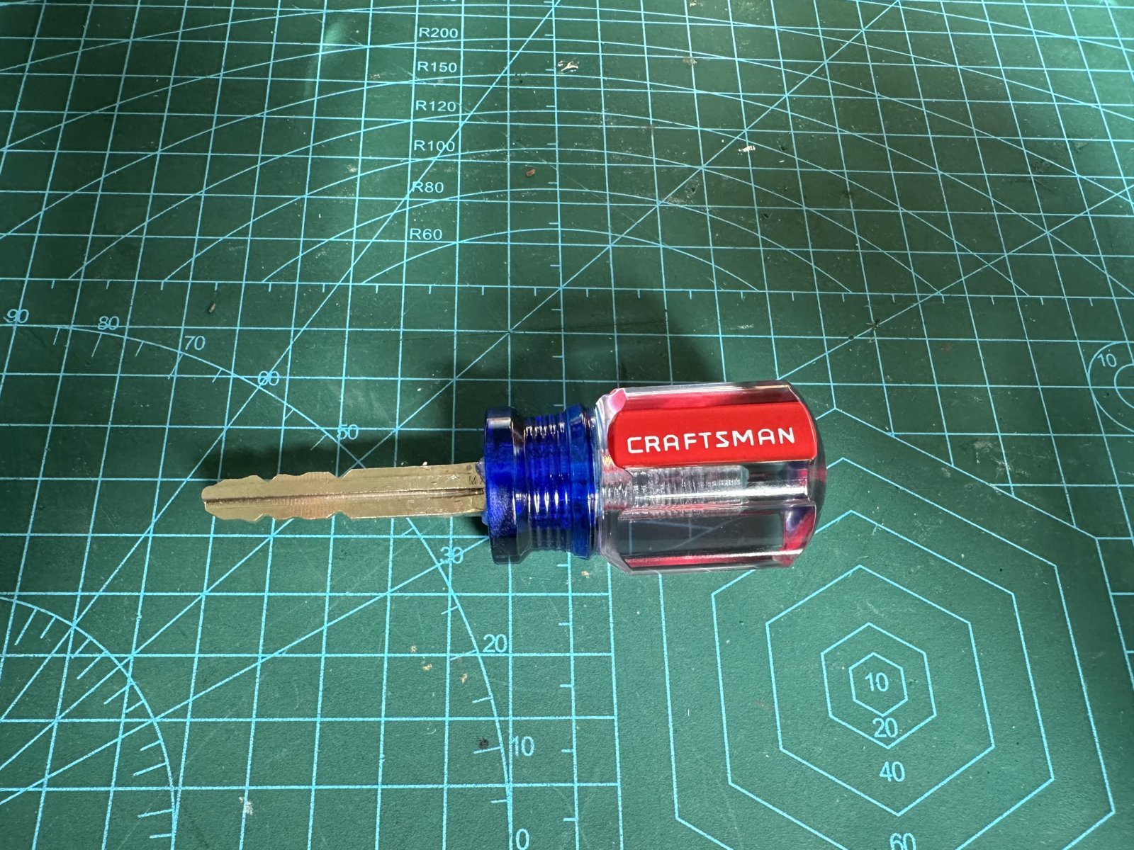

    Made a key today.

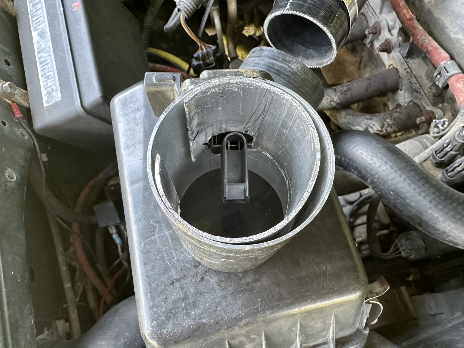

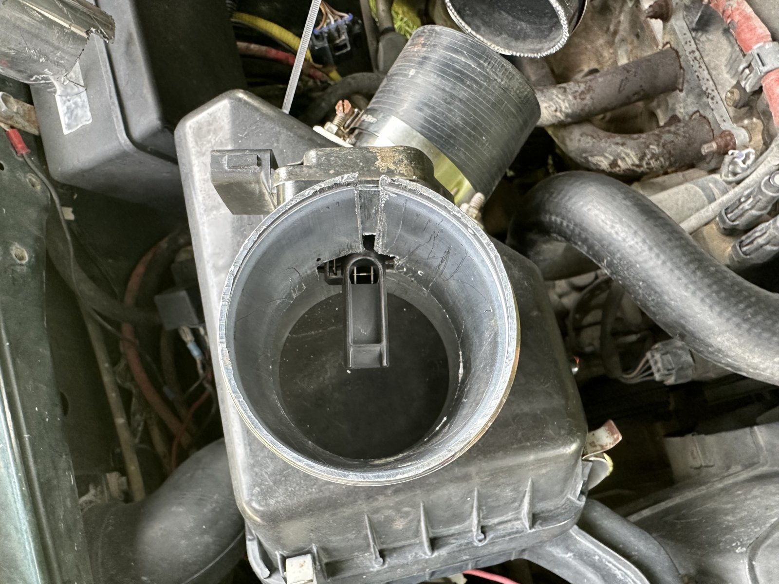

    Revisiting the richness in open loop. Hoping for a turbo setup before the year is out but wanting to tackle this sooner than later. The MAF reading/sizing/scaling is the trick. The URD MAF scaler would be ideal for reigning in the fuel trims NA.
    As for hard starts etc I discovered the generic plastic Spectre MAF housing warped under heat and was allowing some unmetered air to enter the system. I applied a liberal bead of gasket maker to it and put it back together. So far it’s been cranking fine. Have a high idle when warm and low idle when cold. Gonna redo the vac hose today and play with the MAF housing.
    koditten and Speedytech7 like this.
  12. Jun 9, 2024 at 3:51 PM
    #92
    Brake Weight
    Brake Weight [OP] But it hasn't rained in weeks...I'll make it.
    Jan 27, 2015
    #147363
    2,882
    Deep South near the Third Coast
    Taco pulling 33s and a B6 pushing 33psi
    Weld on sliders, fiberglass shell, 12k winch in an Elite Offroad bumper, front Aussie Lunchbox

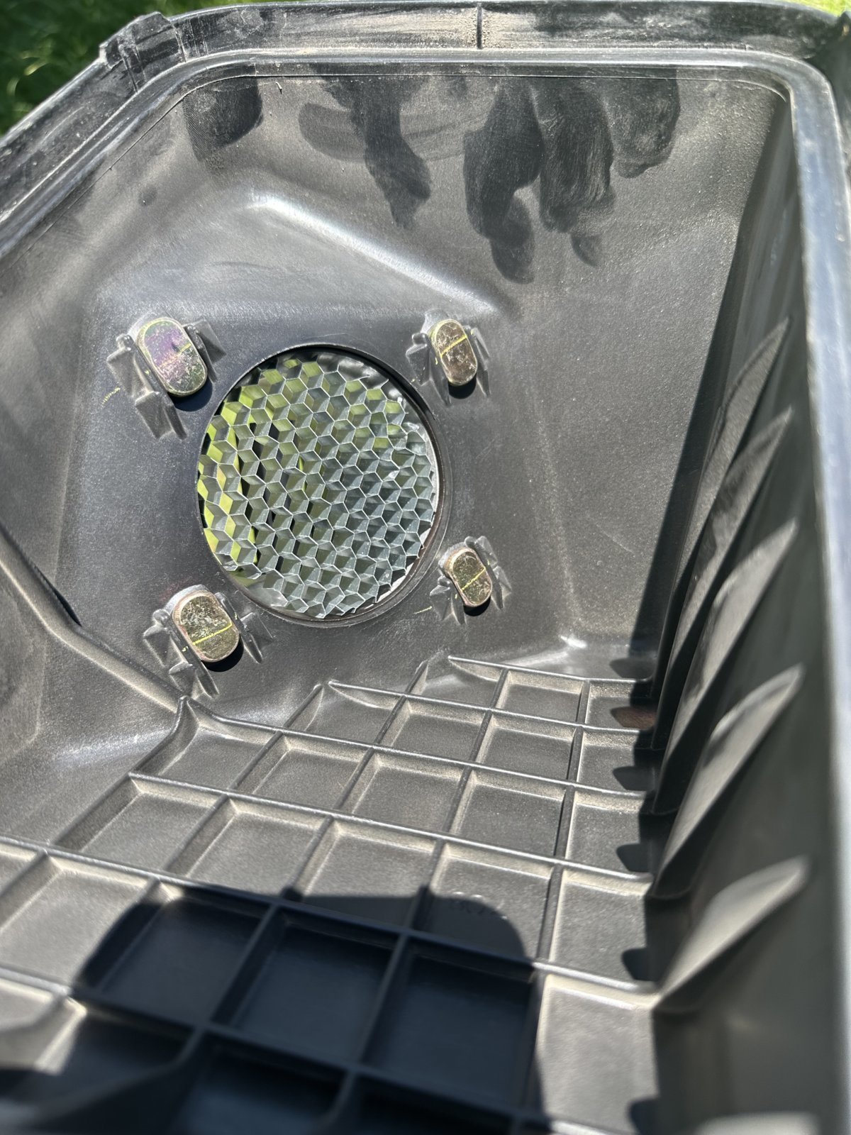

    So primary and secondary O2s read the same basically as it’s catless. There are fluctuations between them as well as up and down which is normal. Granted, this is a 1999 ECU and not a normal, more modern o2 and ECU. Closed loop voltage hangs between 0.3-0.7v. As soon as it goes open loop with the OEM MAF housing it shoots to 0.9v and stays there. Presumably pegged out and rich as a pig. The secondary on my Audi will read 0.4-0.5v when the primary shows a perfect lambda/stoich reading. So this is my litmus….
    Yesterday I tried a piece of air straightener cut to fit. No changes were observed.

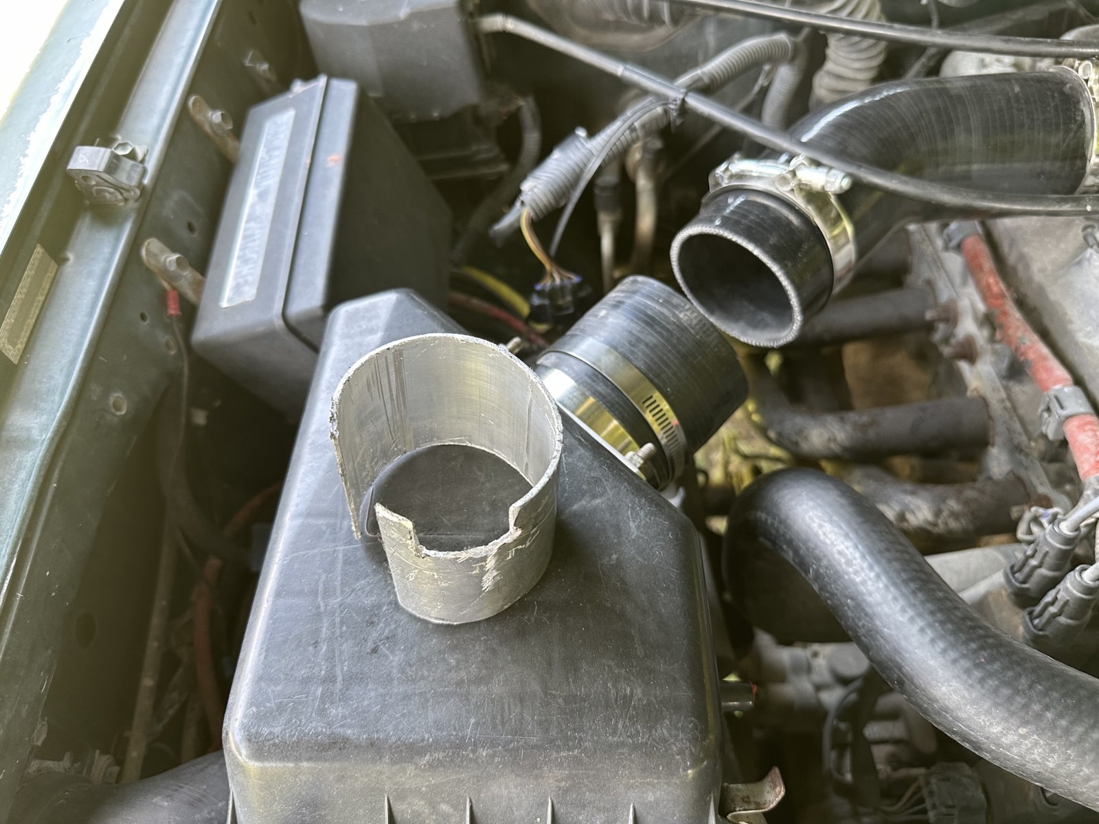

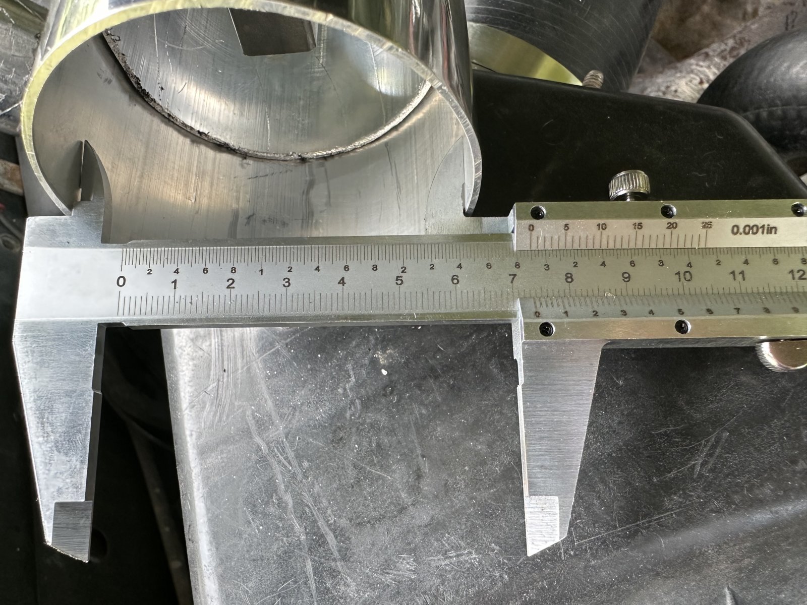

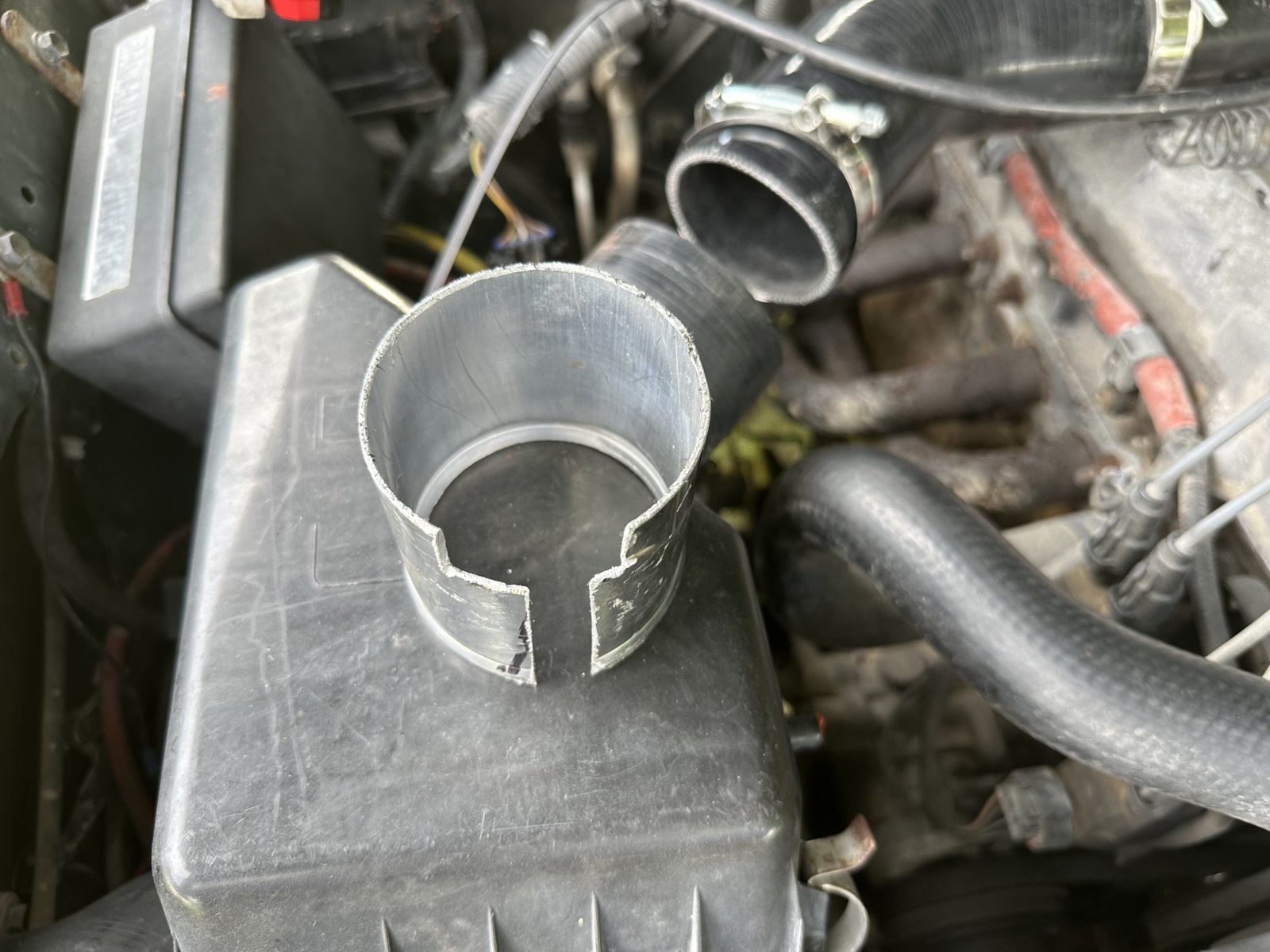

    Today I removed the little plastic piece from the 3” housing and took a piece of 2.5” tubing and cut it to length. Then a split and notch for MAF sensor. I spread it open and slid this in the 3” housing to illicit a reaction hopefully. Still got the complimentary 0.9v.
    Next I cut up a piece of 3” tubing and removed a section so that it would fit once squeezed together. Then a notch. Also hit my pinky with the cutting wheel through a pair of Mechanic gloves…pretty gnarly.
    So 65mm
    Instead of 73mm.
    pretty good fit if I do say so myself. I left the coupling bead but don’t think it’ll make much of an effect. If anything will possibly cause more turbulence. I should’ve made this 3” piece extra long.
    With the 3” piece inside the 3” housing I did get some change. Instead of immediately going crazy rich it instead went as high as 0.9v, but for the most part of a 3rd gear pull to 6000rpm it bounced between 0.7-0.8v with an occasional 0.9v. Hey, still rich, but not pegging the sensor rich.
