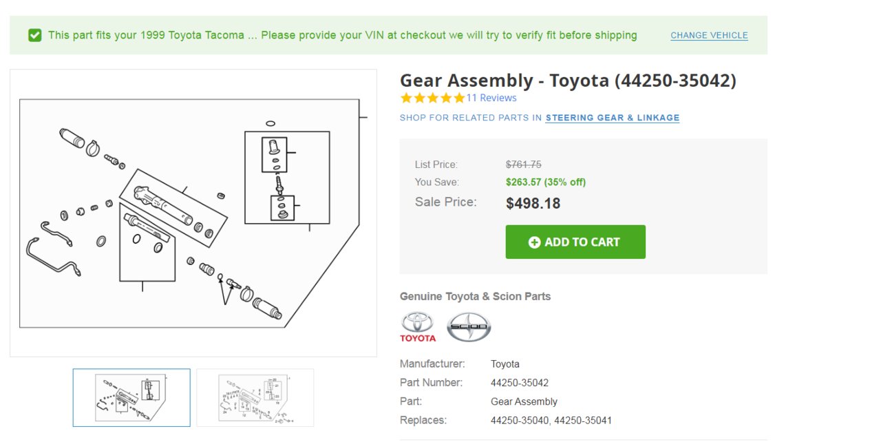

    Nevin
    Nevin Well-Known Member
    Jan 15, 2015
    #146446
    1,128
    Washington
    03 Tacoma 3.4 SR5 2022 TRD ORP 4Runner.
    OME 881 springs with 3/8 spacer. SCS SR8 16x8 Gunmetal 285/75/16 Yokohama G003 Nitros all 4 corners. Dakar rear leafs. Deckplate mod. Marlin Crawler 1200lb clutch. Redline hood struts. ECGS clam shell bearing. Philips LED headlights. Front Runner bed bars. Katskinz leather interior.
    I wouldn't buy it personally.
    That photo they're using looks like a factory steering rack. Highly doubt that's the unit you would receive.
    OEM outer tie rods are 100.00 bucks for the set. Shows you what kind of rack your getting there.

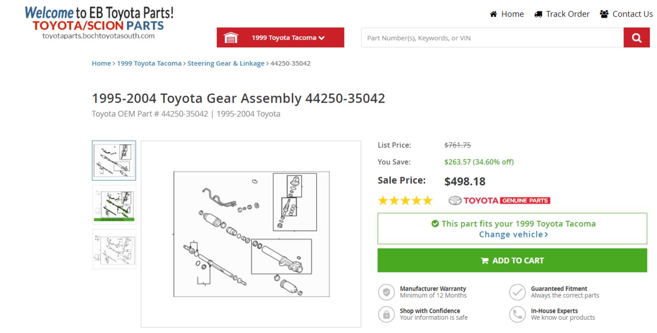

    @wellsf , there's been many, many posts here on these parts that need replacing. Parts geek and Rock Auto have some good timing belt kits, that have the tensioner and idler pulleys, timing belt, and water pump. For the steering rack, I found this one, cheapest toyota dealership part I could find.
    https://toyotaparts.bochtoyotasouth...bly-4425035042?c=bD0xJm49U2VhcmNoIFJlc3VsdHM=
    For lower ball joints, you'll hear many opinions, but I went with Genuine toyota parts, inner and outer tie rods, I went with 555 branded. If you replace your steering rack, they come with the inner tie rods already installed. There are many posts here that can help you figure out anything, and Timmy the toolman, has some very good videos. Good luck with your projects.

    That's right. The going price for a new rack is $498.18. Bochtoyotasouth and McGeorge usually compete to offer the best price. Be sure to verify shipping rates from each parts store to your location. Shipping rates very greatly by location.
    In the western part of the U.S. I see online rack pricing at a bit higher at $534.75. Prices depend on location. Shipping certainly depends on location.
    https://toyotaparts.mcgeorgetoyota.com/
    https://toyotaparts.bochtoyotasouth.com/
