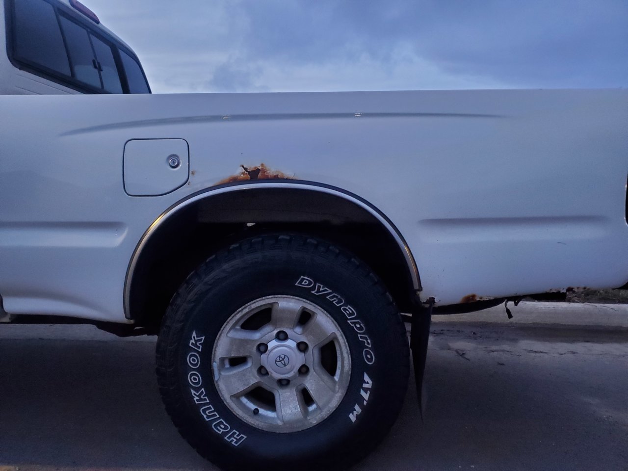

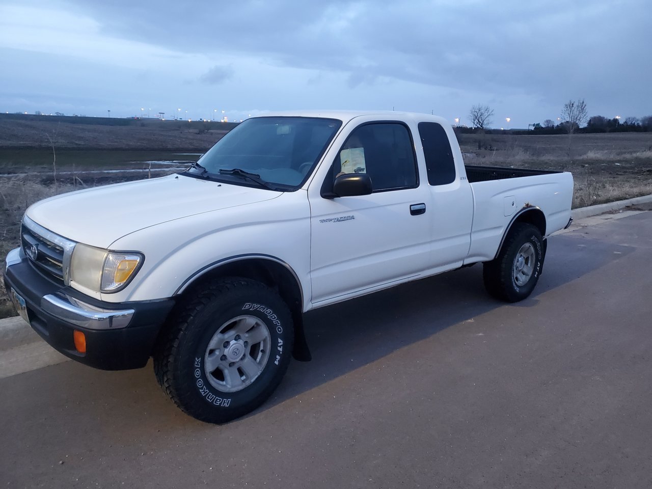

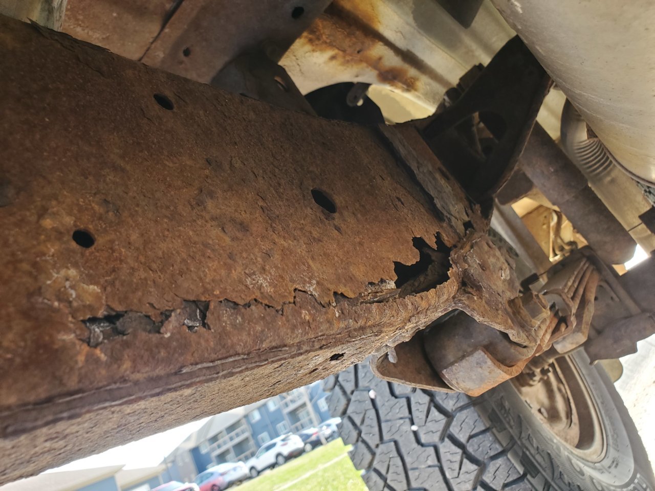

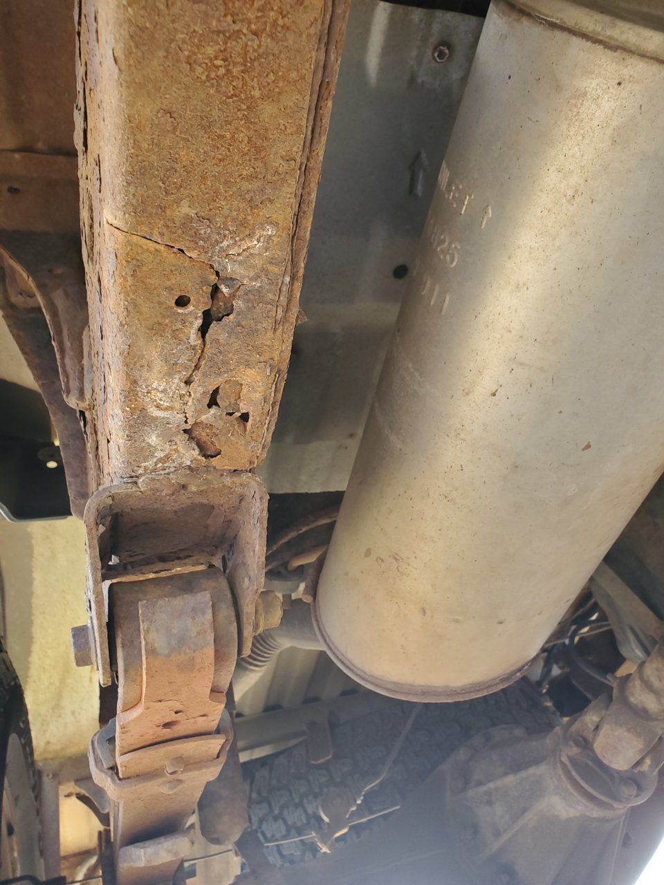

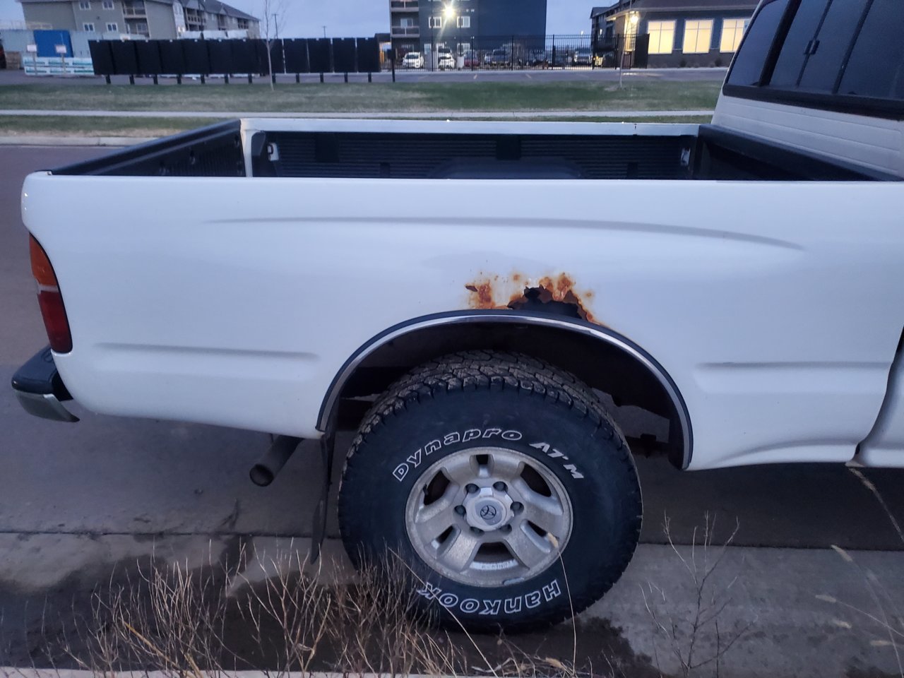

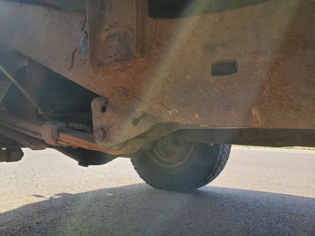

    I've owned my 1999 Toyota Tacoma for 5 years now and I have fallen in love with this truck. Currently it has 201k miles, but unfortunately it is unsafe to drive at the moment due to rust on the frame, along with electrical problems and a bad power-steering pump.
    I bought a newer truck recently and am now torn on selling my Tacoma or putting it into storage and try to restore it.
    I am very inexperienced working on vehicles but have always been interested in working on my own vehicle. I still get excited every time I get in my truck and would love to own it and pass it down to my family. The amount of problems that are amounting up seem very daunting and would take many years for me to work on and fix.
    I will leave some pictures of what I am dealing with at the moment, but I would love to hear from someone who has maybe been in the same situation or has any tips or knowledge to pass down.

    That frame is toast unfortunately. It's going to be an expensive and difficult endeavor if you had to swap that frame at a shop.

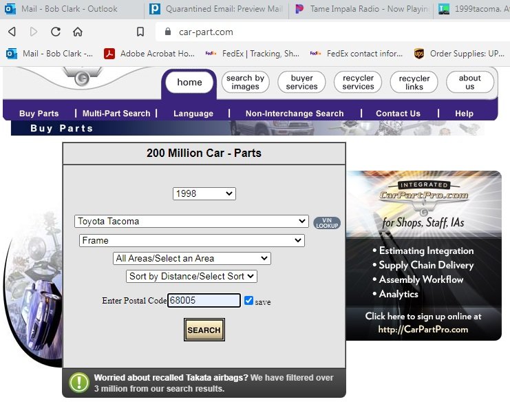

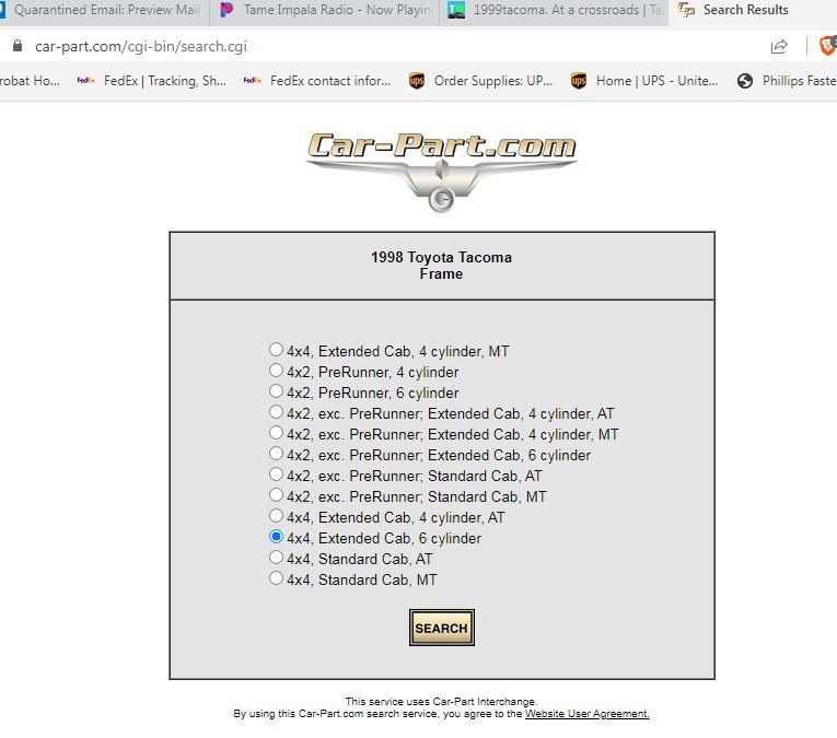

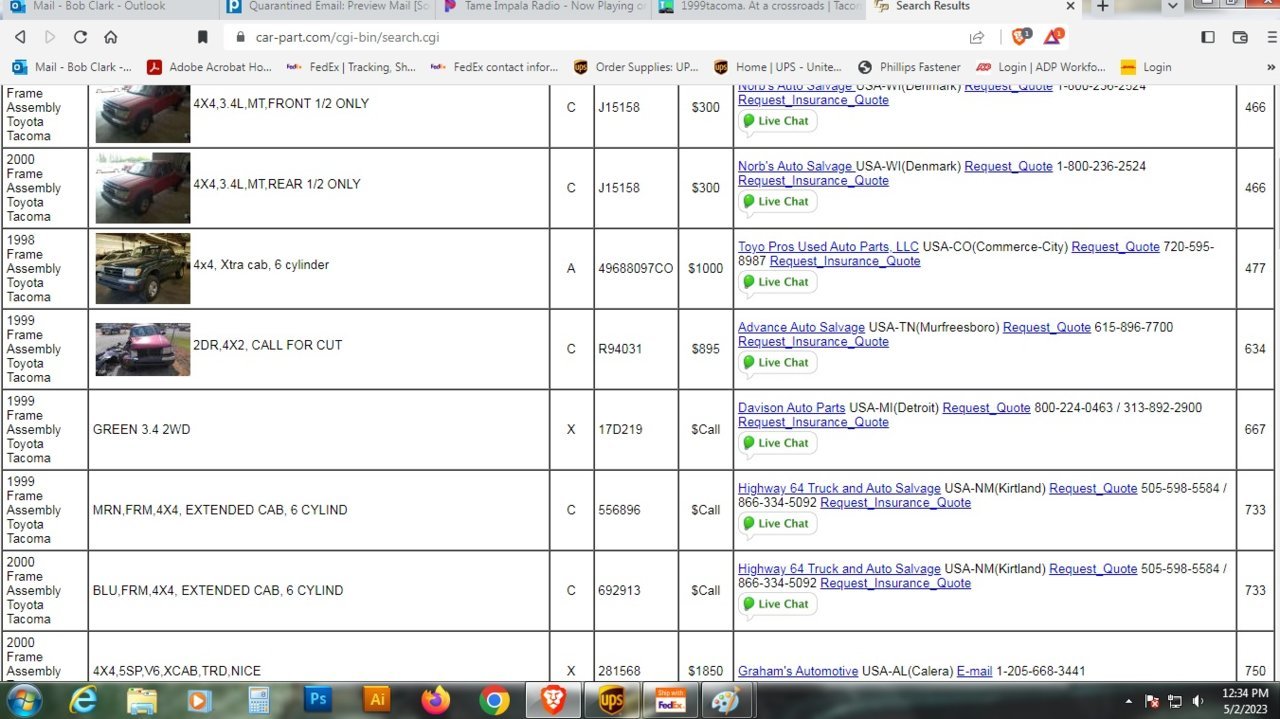

    If I were to do it again, I'd fix my frame with another frame from car-part.com. I fixed my frame with the frame reinforcement kit and it worked great and it was as bad as yours, but it doesn't look stock anymore. Here's a look at what you'll see when you click on car-part.com website. I used it to find a gas tank in mint condition. Maybe take a look on there, see if a nice frame pops up and buy it. The ones in New Mexico or Arizona would be best.

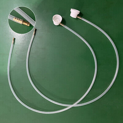

    There's a lot videos out there on how to treat.....
    and how to get fluid film down into rocker panels and other hard to get....
    Those '4-way spray' long straws that spray inside the frame box.......like $8 for half dozen of em...amozon...
    https://www.ebay.com/itm/364059976515

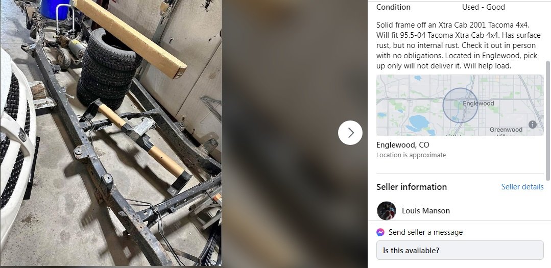

    I looked on Facebook Marketplace and found one in very nice shape for $1500 in Colorado. I could see buying that and stashing that away until needed.

    Keep in mind the 5lug frames are different from the 4X4 and pre runner 6 lug frames....
