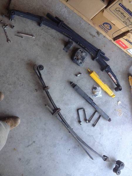

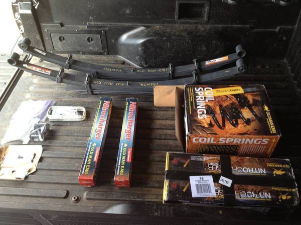

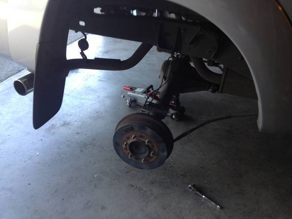

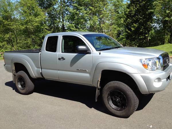

    After a year of ownership here's some improvement, more to come over time.
    What Ive done:
    1)OME 90000 Nitro Charger Shocks
    2)OME 885 Coils
    3)10mm Lift Enhancer
    In The Rear (ha)
    4)OME Dakar Leaf Spring (CSO47R)
    5)Pin Collars For leaf spring (W/axle Shims)
    6)OME 182 shocks
    7)Toyotec 3 Degree Axle Shims
    8)OME Drive shaft Packer Kit (FK29)
    9)New U-Bolts, New Toyota Bushings
    Wheels: Pro Comp 7089, 16x8, 6x5.5, 0mm offset
    The day I bought her
    Some Stock offroad
    How she sits now
    Stock Tires
    Wish List;
    TIRES!
    Rock Sliders
    tint

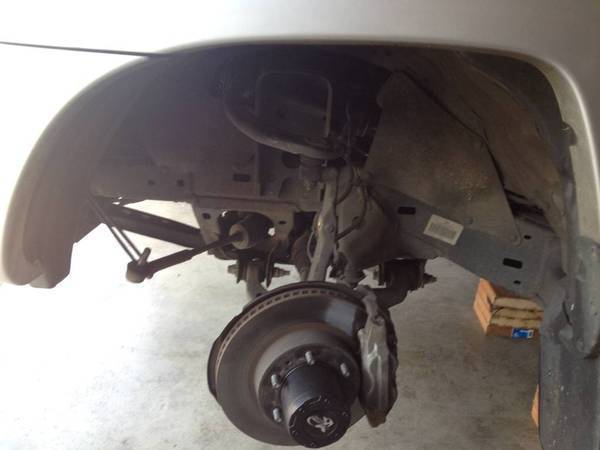

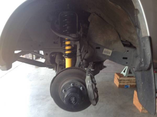

    Installed lift in my garage by myself with the tools i had on hand besides the rented coil compressor from Autozone so I could put together the new coils and shocks. Build was pretty straight forward with the help of Tacoma World with the exception of putting the shock/coils in the front - by myself was an absolute pain in the.

    With the 10mm lift enhancer, were you able to achieve a level ride or do you have slight rake? Read this on another thread:
    1.75” front à 1.5” rear = slight rake
    2.5” front à 2” rear = rake
    2.5” front à 1.5” rear = level
    ... Wheelers Off Road says that with the 885 coils you'll get 1.75" and that the Dakar Leafs give you 2.75". Also, does this setup give you just under 3" or 3" exactly do you think? I'm not looking to go past that 3" barrier requiring new UCA's..
    I am looking to go with the EXACT setup you have, I've been piecing it together over the past few weeks. Did you buy it all in a kit from somewhere or did you piece it all together?
    Lot's of questions, I know.. Just want to get all the details right before I pull the trigger.
  8. Jun 30, 2012 at 7:26 PM
    1expensiveTaco
    1expensiveTaco [OP] Active Member
    Aug 9, 2011
    #61426
    31
    Steven
    Washington
    07 Tacoma Access Cab 4x4 V6
    Hey man I'm honestly going to have to check for you, if you have not already found out what you needed to, i will try to get back to you sooner rather than later. I actually pieced it together i could not find a kit. Buuut http://www.wheelersoffroad.com/ will set you up with pretty much everything you need. Ill measure everything for you in the meantime, oh and i did not need new UCA', stock work just fine with no issues (although i would prefer to get some sturdier one's with more room.)
