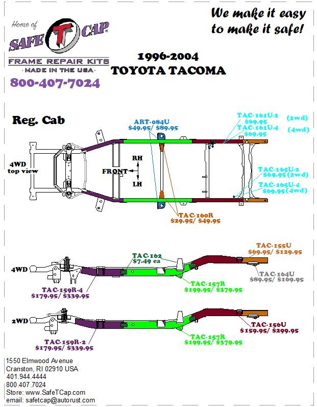

    We used the SafeTCap on our 2001 by one of their recommended vendors. They support the frame and cut away the rusty parts. fit the new section in place, weld it, and then coat the entire frame with POR-15.
    DawsonDestroyer and Bg97Taco[OP] like this.

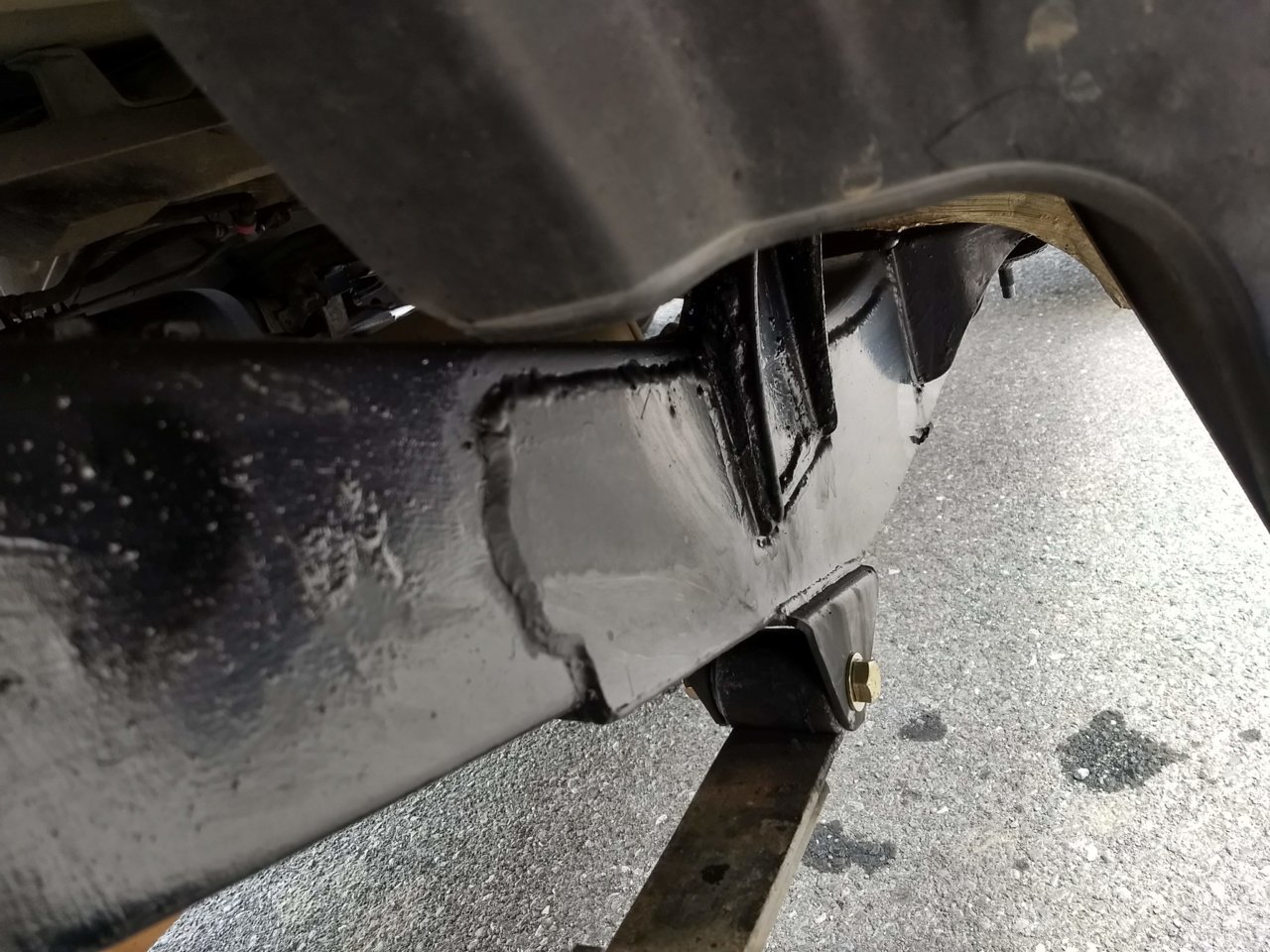

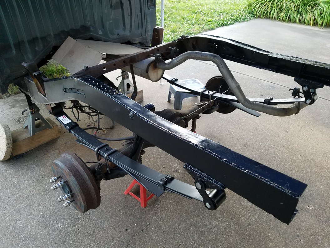

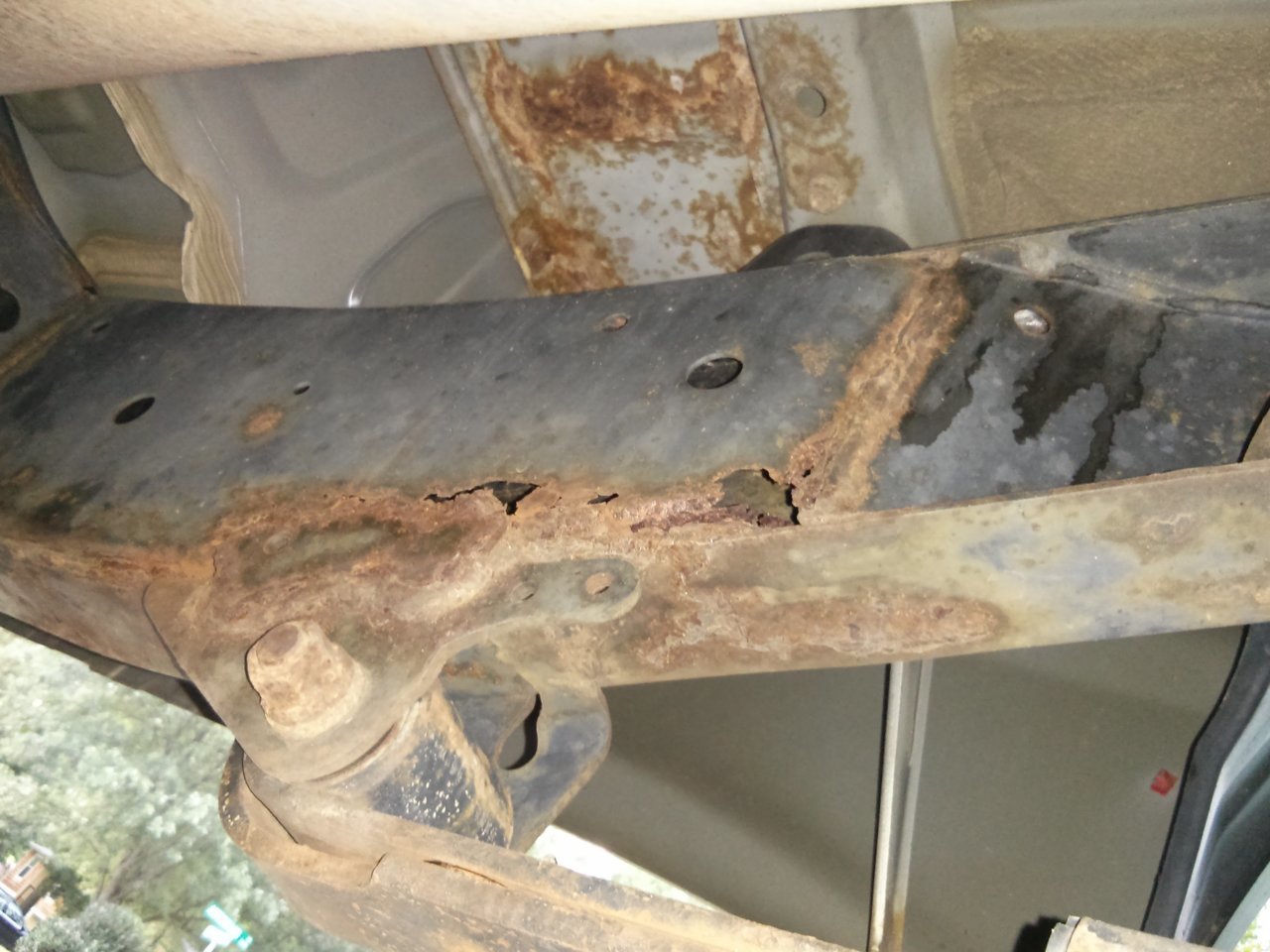

    I used the safety cap system on both of my first gens.......a 1996 and my 2003. Its a lot of work if ya do it right. They say ya don't have to take the bed off but i just don't see how ya cant. Ive taken off the bed both times. Expect alot of broken bolt when taking stuff apart. You'll be replacing alot of stuff or rebuilding stuff........if ya do it right. I had to replace 1 crossmember for the gas tank on my 96 and rebuild the one on my 2003. Buying anew crossmember from toyota will set you back several hundred. I got mine for 50 bucks from a donor truck at junkyard, luckily the bed was already off. Gas tank straps will usually need replaced also.
    My 96 was down for about 3 weeks , I took 1 week of vacation and the rest of the time i worked on it after work and weekends. But i also chipped big rust flakes off the entire frame then flap wheeled it to get it clean then used frame chassis saver which is just like the POR 15 that was mentioned above. I would guess close to 80 hrs on just cleaning up the frame rearend and complete suspension. Its a tremendous amount of work and dirt and rust in your eyes and lungs.
    Don't let me scare you off its very gratifying when your all done its just a lot of dirty labor. If these trucks weren't worth it i would have never done it twice.20190914_193644.jpg

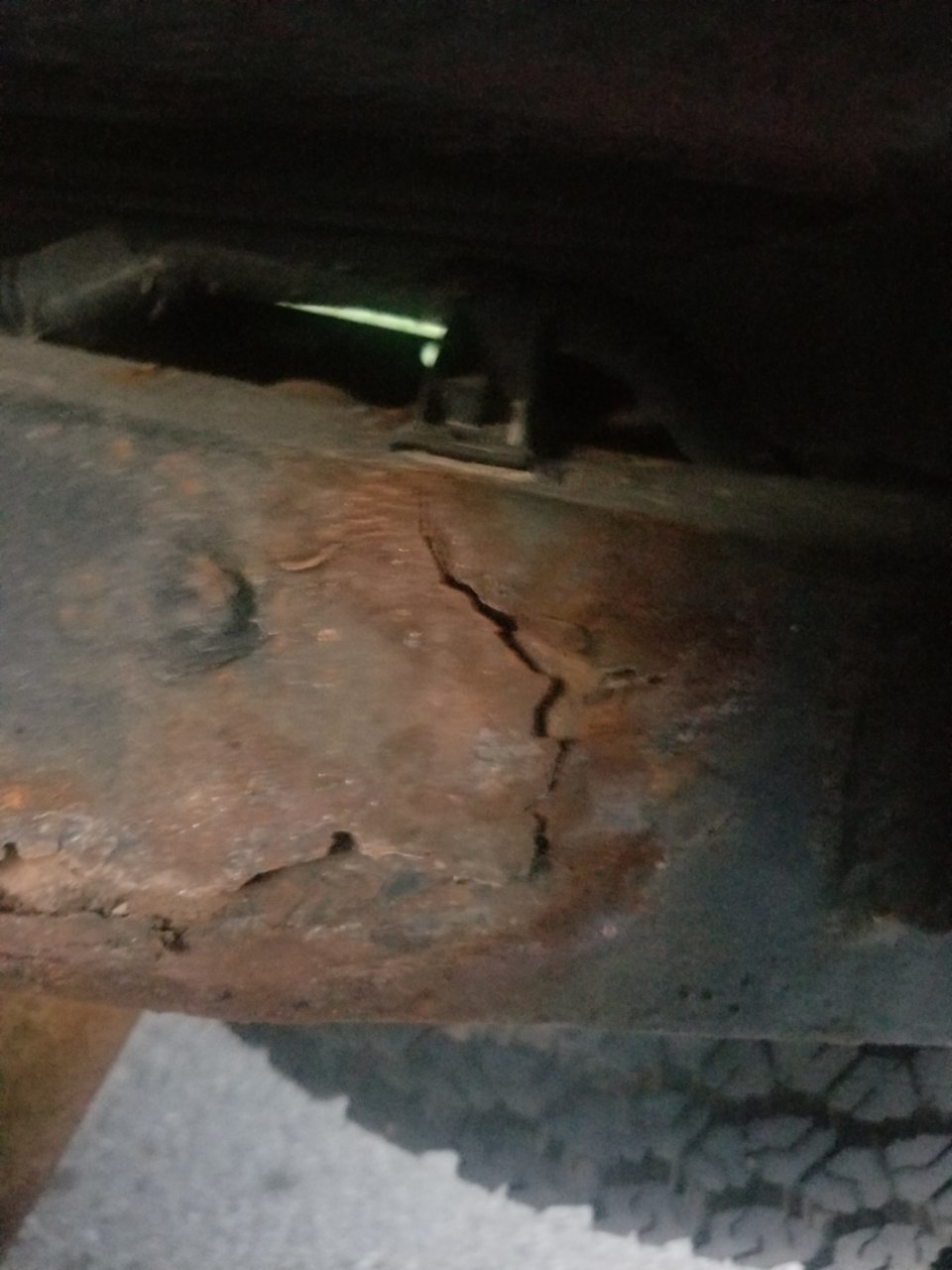

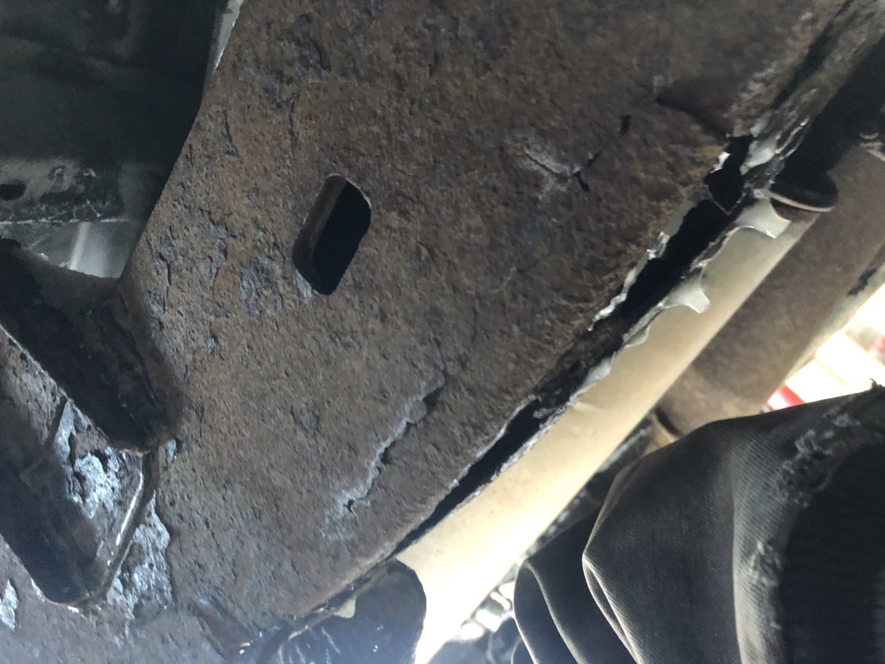

    Yeah, I agree. For me it wasn’t even an option to try it myself with an arc welder. I looked at the cost like having a car payment; the truck was paid off and if I did nothing it would break and be totaled. So for the equivalent cost of a few months of payments it could be like new again. This before picture is from 2013 - 5 years before we had it fixed.
    The truck spent most of its life in central NYS before moving to Charlotte NC In 2004. We received the undercoating letter from the dealer a few months after moving but it was already registered in NC and when we called Toyota said they would not honor it because the vehicle was not registered in an area (NY) where the notification applied. The rust slowed but in 2018 we finally had it fixed by Off Road Innovations in Winchester VA. There was another Auto Rust / SafeTCap dealer in Georgia which was closer to me but they told me it was probably too far gone to be fixed based on photos I sent them. I shared the photos with AutoRust and they said it looked fixable and recommended the place in Winchester VA.
    Long story short, I highly recommend the SafeTCap system and if you are on the east coast I highly recommend Off Road Innovations in Winchester. It might not look like it from the 2013 picture, but by 2018 we were a load of stone away from a broken frame.

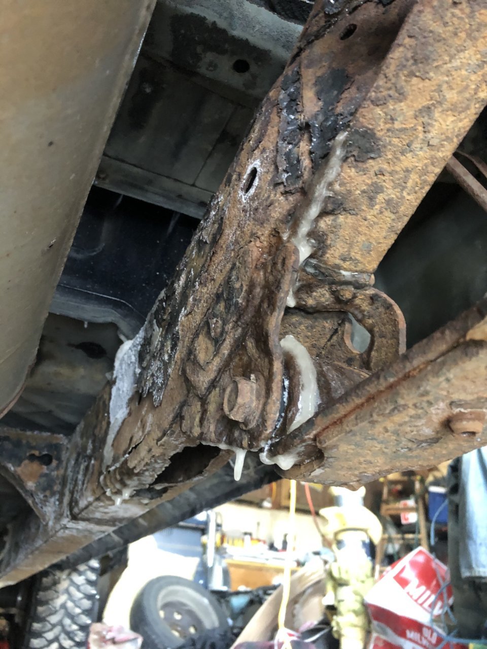

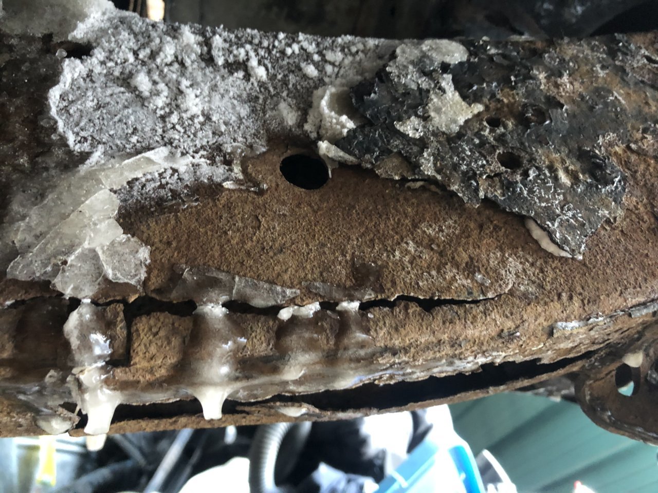

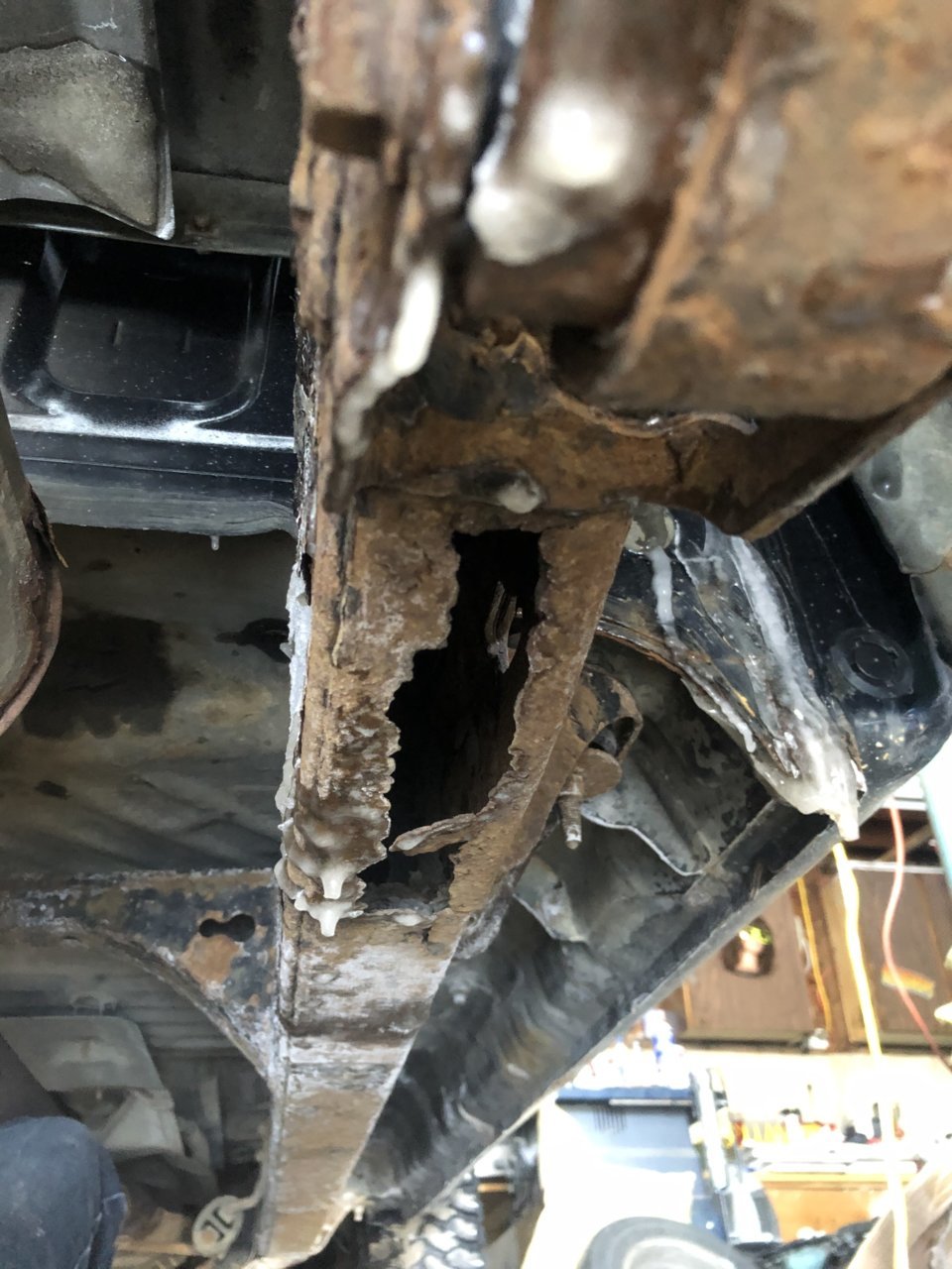

    It’s nasty ...

    You do indeed have your work cut out .
    You might have togo beyond what the safety caps cover.

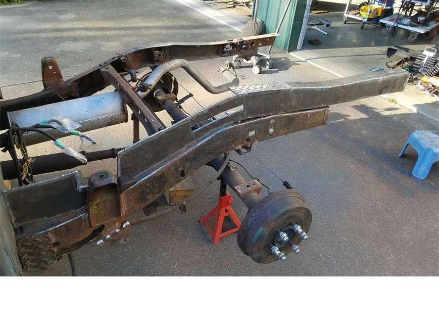

    Mine was similar and I ended up making replacement sections. I had a partial sheet of 6mm thick plate and some scrap. Not pretty, but hey, it's hidden under the bed so who cares.
    These pics are a ways from final condition, but you get the idea.
