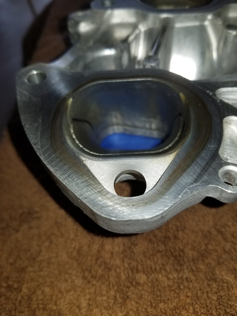

    This is the bottom side. Remove most of the lip. You can leave a little for anti-reversion but I didnt.

    @Roostfactor That's helpful, thanks a lot.
    I'm not sure this would be worth it at only 13psi without a valve job. I'll think about it anyway.

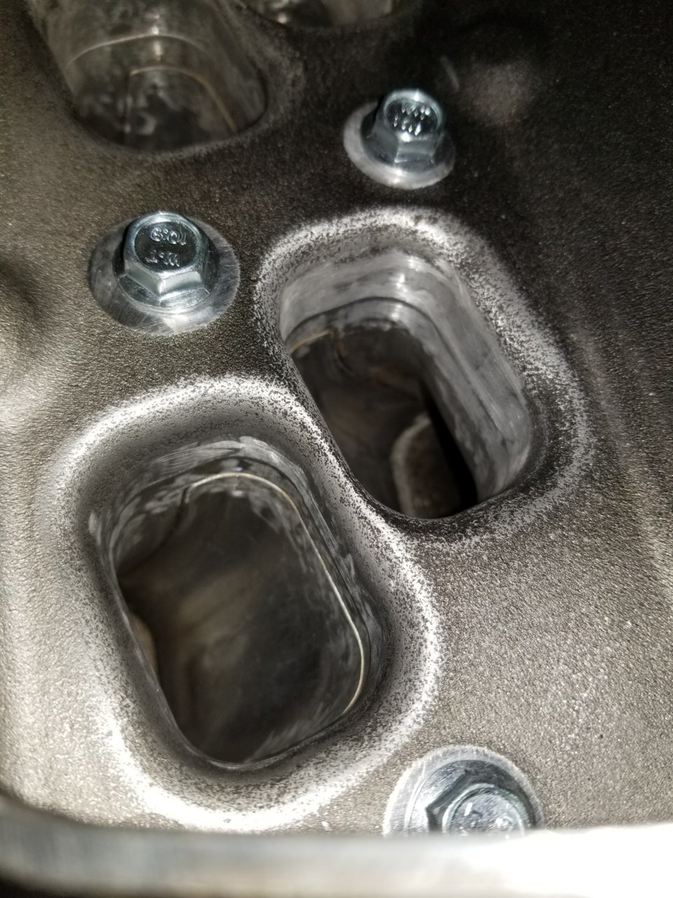

    From the top side. I have opened it up a bit more since this pic was taken.

    Sweet. Next time I do spark plugs I'll port it, I think. It may not make a difference, but it shouldn't hurt that much either.
