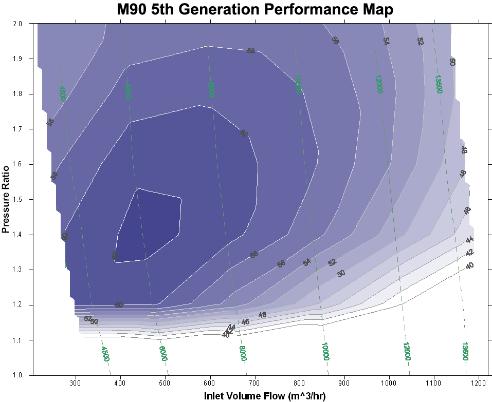

    Speed isn't really the issue. The pressure of the manifold is a better indicator. I was told/reading that under 13 psi you're still getting ok returns. I calculated my blower spins at just under 30000rpm.

    Thanks, is good info. Although I hear w are actually MP90 not M90. Don't make a difference for RPM calculation though... all I did was do a ratio of the diameter of crank to drive pulley, then multiplied by max crank rpm.

    Our crank driven pulley is 6.5". 6.5÷2.0x5500=17850

    Ours is in fact an mp90 which I think is just Magnuson's case with Eaton rotors. Ours is a gen V though and the link you posted is for an older version. What we need to look at then is an efficiency island. So @ThomasMore66 I will leave this here. :)

    Shit that's an awesome chart. Thanks.

    Sooo, if I'm reading this right 17850 is off the chart...

    Not bad but not perfect. With my ocd though I would be thinking about it not being perfect forever until I fixed the issue (even if there wasn't really an issue).

    Efficiency is way down by that point. Pressure ratio is off of atmospheric I’m presuming.

    I should be at a PR of about 2.0.

    Correct. The standard is 14.7psi or 29.92 in hg at sea level at 59°F.
    So you are close to that.

    That's the standard, but I'm at about 14.35 at my elevation. I'm guessing you're about 14.2 in WF. Edmonton would be about 13.6. So at 13 psi not quite a 2 PR. I just feel there's not much more in the SC at that point.
