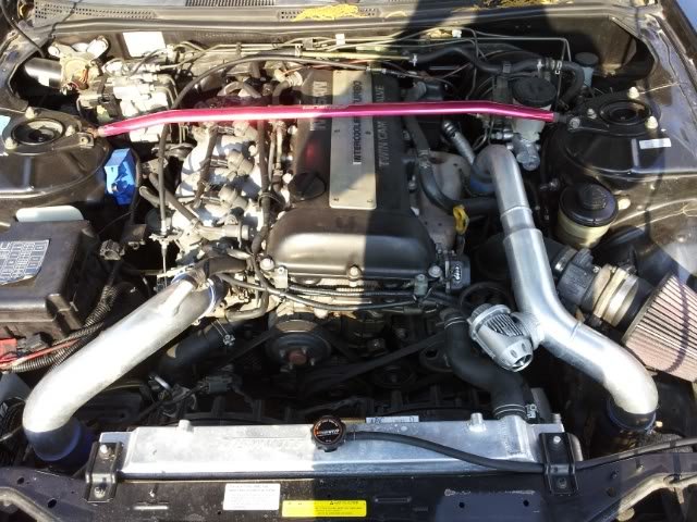

    I wouldn't really pick a car fight with Toon. His turbo build is impressive enough not to mention he has a s14 with a sr20 swap just for a DD.
