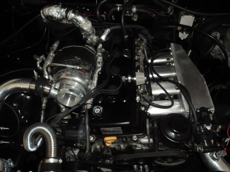

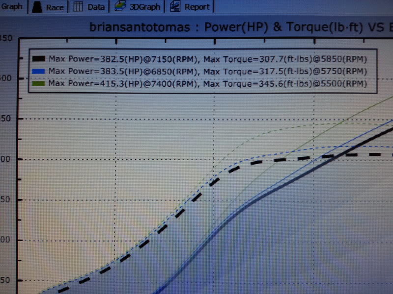

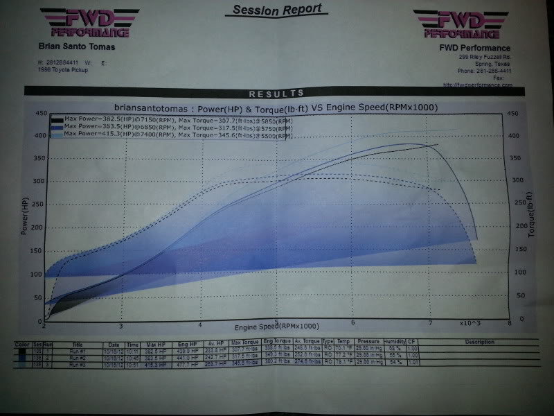

    Just FYI...Gabe is still working on the intake manifolds for the 1GR-FE motors. I was able to take my 2rz Turbo Tacoma to the dyno in the mean time. Gabe wired and tuned the megasquirt and custom made the intake manifold. First two pulls were done at 15psi and 3rd pull was done at 17psi. I like the results! :D
