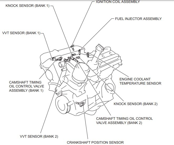

    Sounds like the VVT Solenoid got stuck on bank 1.
    They are in the valley of the engine, I believe you have to remove the upper intake manifold to get to them.

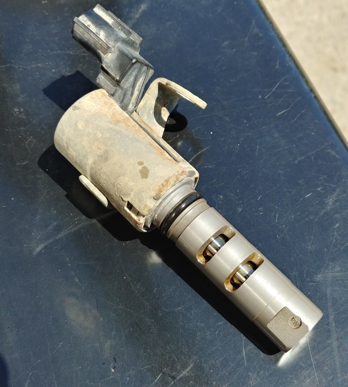

    Yes I think you are correct. Took the solenoid itself out in the gas station parking lot, looked great. The connection had a bit of grime in it, but nothing terrible.
    Put it all back together, started up and ran fine. Cleared the P0016 code but P0011 will not clear as I mentioned. ScanGauge said it was running in open loop the whole time which makes sense, felt just slightly down on power. But other than that, and the CEL and Trac Off lights you'd never know.
    Made it to my destination 45 mins up the road. Going to try to locate some brake cleaner tonight and give those screens a cleaning.

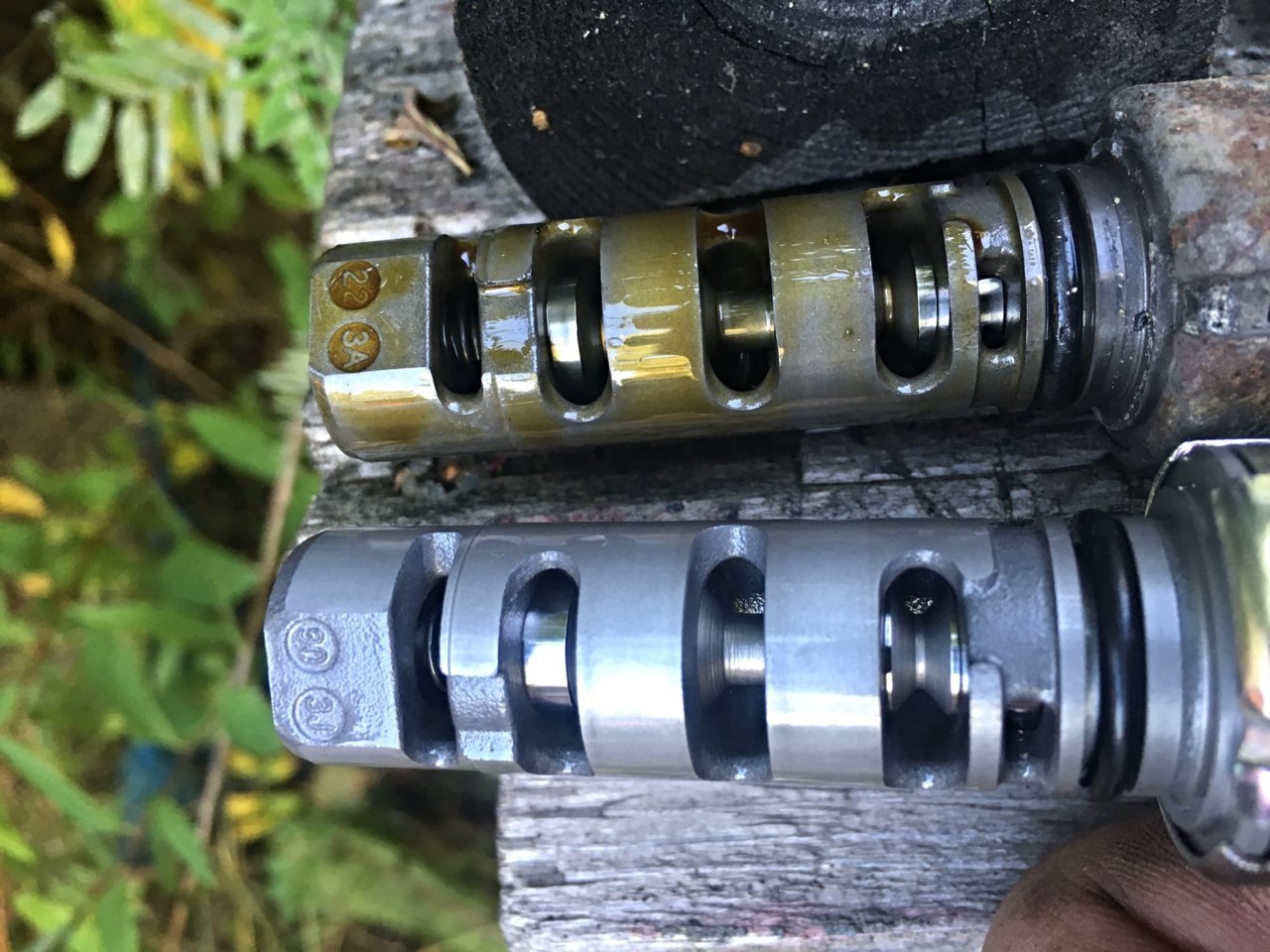

    Thanks for that link, very helpful. The oil flow diagram in particular. If the return spring is getting weak it makes sense why the cam timing was over-advanced
    Pictures below. Looks to me like it was in the neutral position when I pulled it Sunday. And a few pictures of the screen. Im shocked how clean that damn thing was. Guess there is something to be said for full synthetic and regular OCI. Second pic was just wiped down with a dry rag, no solvents used.
    Also, the truck threw a P0012 last night and ran kinda shitty at low throttle. Was less than a mile from home so I just drove it. Ran ok at mid range throttle and seemed fine when I parked it.
    Would you guys do any more testing of any sort? Pull the solenoid again and shoot some throttle body or MAF cleaner through it? Swap it from bank 1 to bank 2? 15330-0P010 looks to be what I need and is only about $100 from McGeorge, cheap if it gets me another 100k miles. But dont want to waste $100 if its a cam position sensor, or something more involved like a timing chain

    Swap it with the other bank and maybe swap the sensor too after. A broken timing "flange" on the sproket (the metal thing who give the timing mark for the sensor) with throw many other code so i dont' think it's that. If you swap and the code don't move to the other bank... i hope it's not a broken chain guide (it's under the chain between the 2 camshaft. It's very rare but can happen. Check the chain tensioner (the little door with 4 bolt near the coolant overflow tank on the engine) it take 5 minutes and you will see the stretching condition of the main chain, this can give some insight, it's a long shot there but if the tensioner is bad or the chain is over stretched the slack will change the timing on the bank 1, bank 2 will be ok since the clockwise rotation pull on it.
