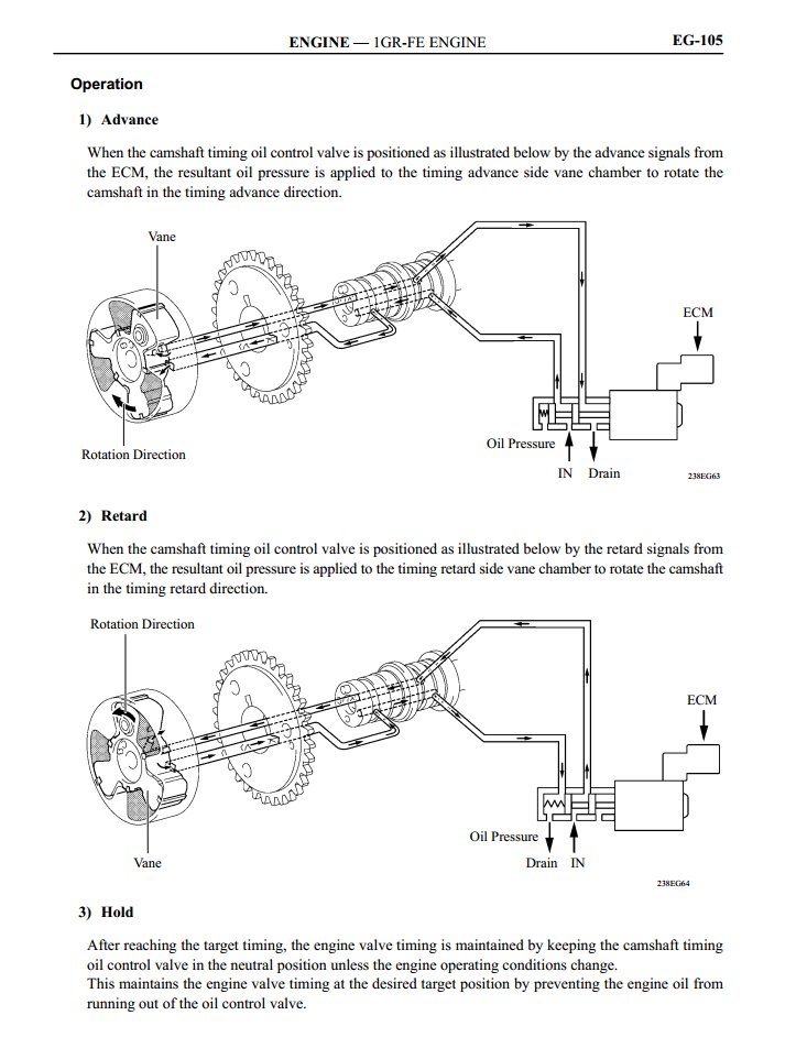

    For anyone troubleshooting this issue in the future, below is the oil flow to advance the cam.

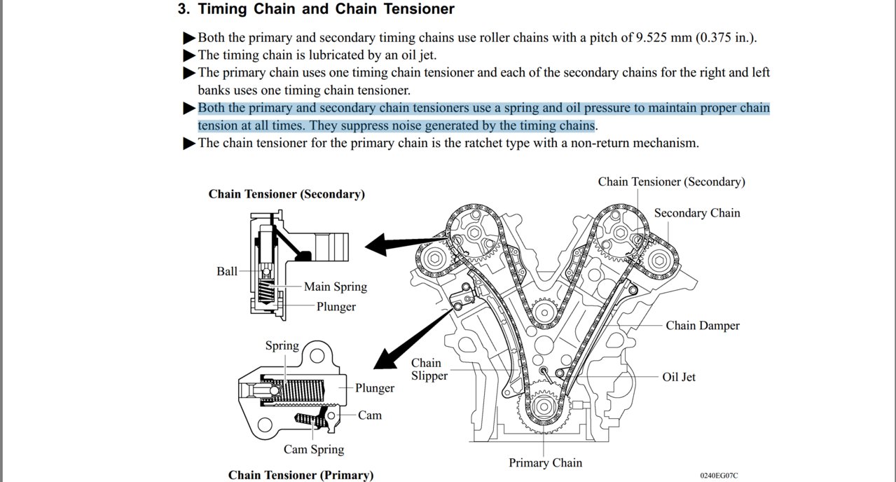

    Well your the first i met who claim that the primary tensioner is not operated by oil pressure.
    you can see the oil port on the head and behind the primary tensioner.
    The spring help the cylinder to stay extended and the ratchet in the notch when the engine is not running.
    I don't understand why you think i'm confused by the wording. There even a check ball in the drawing. Is there anyone who have one scrap sitting, i want a tear down of that !

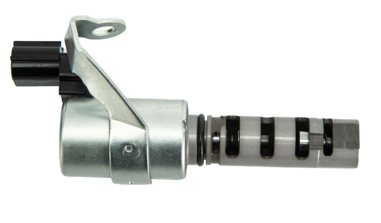

    As I was afraid, the solenoids are not interchangeable due to the mounting bracket so Im not going to be able to swap them

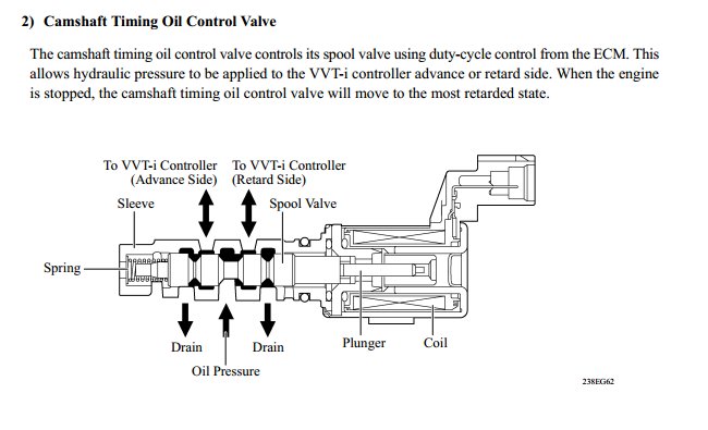

    Pulled bank 1 OCV tonight. It looked fully closed this time compared to when I had it out Sunday. Shot some MAF cleaner through it, got a little bit of sediment out but nothing bad.
    Used a 9v batt to power it. It worked absolutely great - about 90% of the time.. handful of times it did nothing and remained closed. Still drawing ~1 amp. Not sure what the failure mode is there, but will have a new one in from the local dealer tomorrow.

    Lastly I did confirm the solenoids / OCV cannot be swapped from side to side due to the mounting bracket. Pics tomorrow

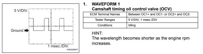

    The solenoid use a duty cycle to operate i found some waveform if this can help you.

    That's the cam/crank waveform, here's the one for the oil control valves (basically a 0-12v duty cycle).

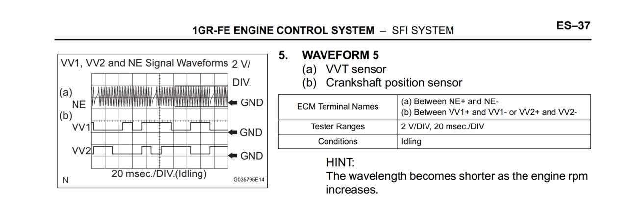

    Thanks for the correction, i don't know why when it took the screenshoot i was at the next page and didn't notice.
    Some guy on youtube said that the hold position is around 42% duty cycle on the solenoid i don't know if it's true but it's a ball park. You can use the waveform 5 graph to see if your "phaser"/sensor on the VVT work correctly. I think the (a) and (b) on the graph should be swapped. NE is the crankshaft
    VV1-VV2 are the phaser position.
