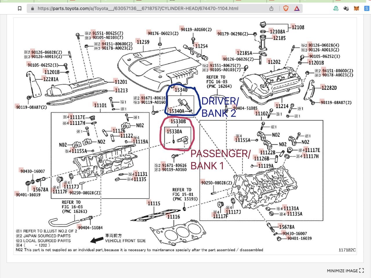

    Bank 1 (Passenger) aka "Right" VVTi valve for the 1GR-FE 4.0L engine, model code GRN245L-CRFDKA in my truck is: 15330-0P010
    It looks like the part # for the Drivers/Bank 2, aka "Left" VVTi solenoid is probably: 15340-0P010
    I've cross-checked & confirmed that this looks like the correct part for my engine variant. (Also fits many other 1GR-FE variants, but cross-check your exact variant code before ordering. The engine code is printed along w/ the VIN, GVWR, etc. on the driver's side door pillar sticker.)
    Attached is a parts diagram from Toyota Parts. It's a bit confusing that the assembly part number for the Bank 1 solenoid in the diagram (i.e. both the solenoid & its O-ring) is listed as "15330B," while the Bank 2 solenoid is just a plain "15340" without any alphabetic suffix. But I don't find any "15330B-0P010" parts for sale on the web. Only "15330-0P010", which is still pictured as the complete assembly including the O-ring.
    I've ordered both an original/OEM 15340-0P010 and a 15330-0P010. Current price before shipping & tax was about $80.00 each from an eBay seller w/ good reputation.

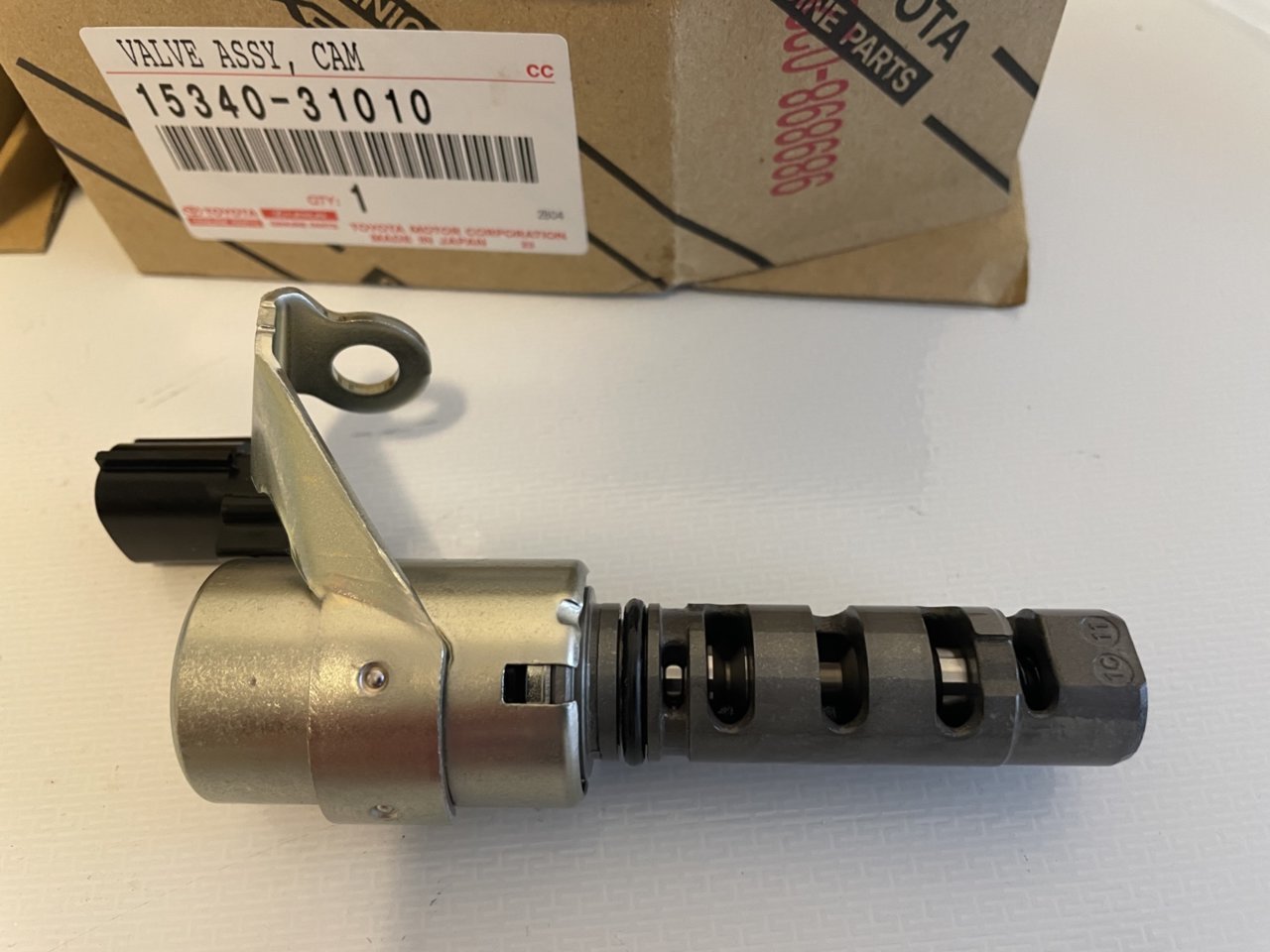

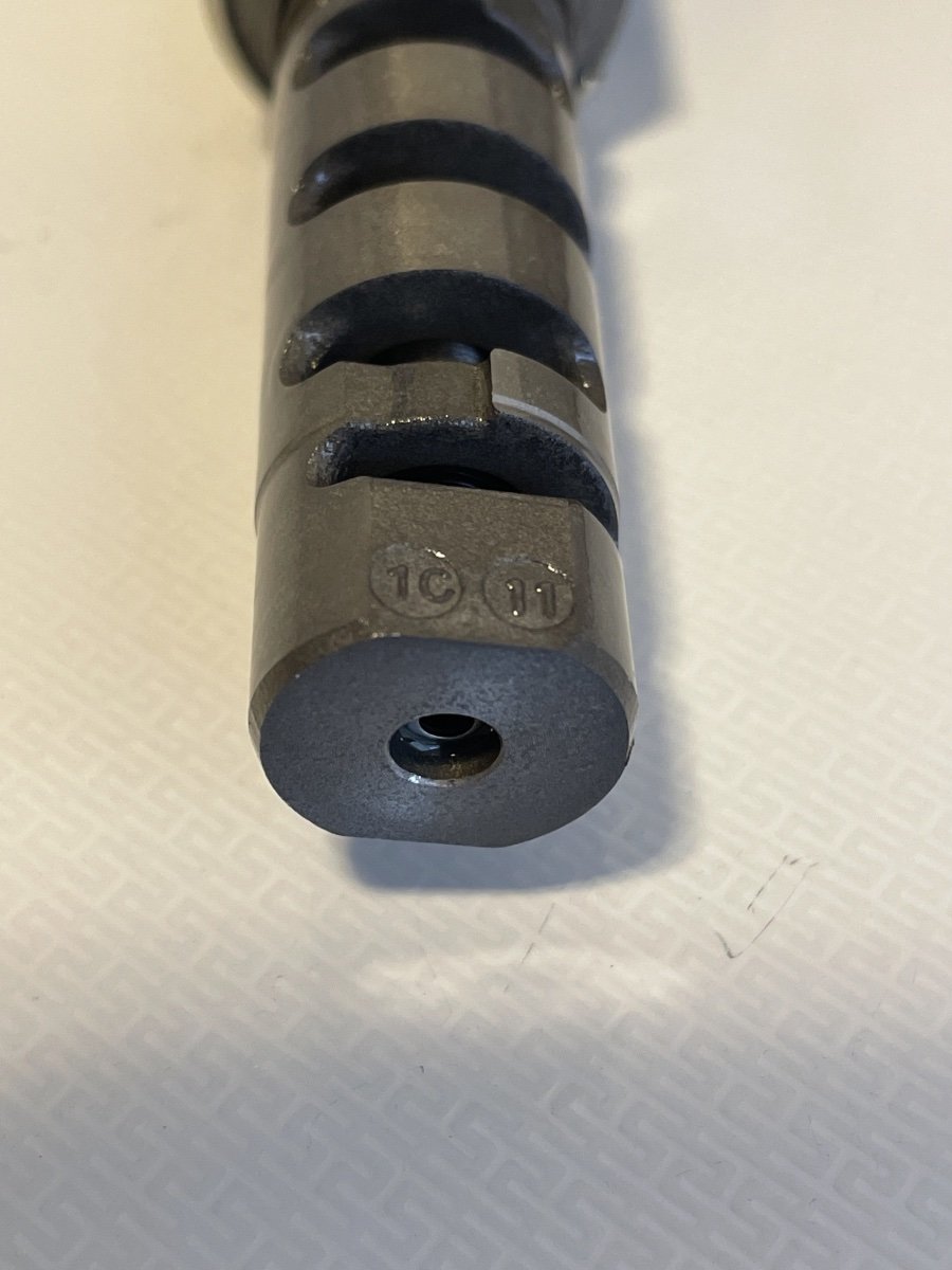

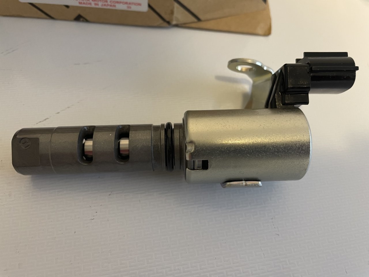

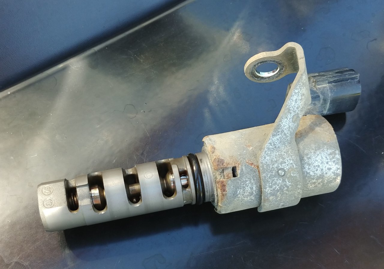

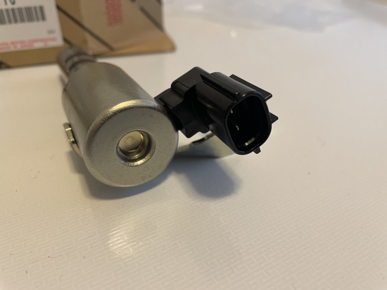

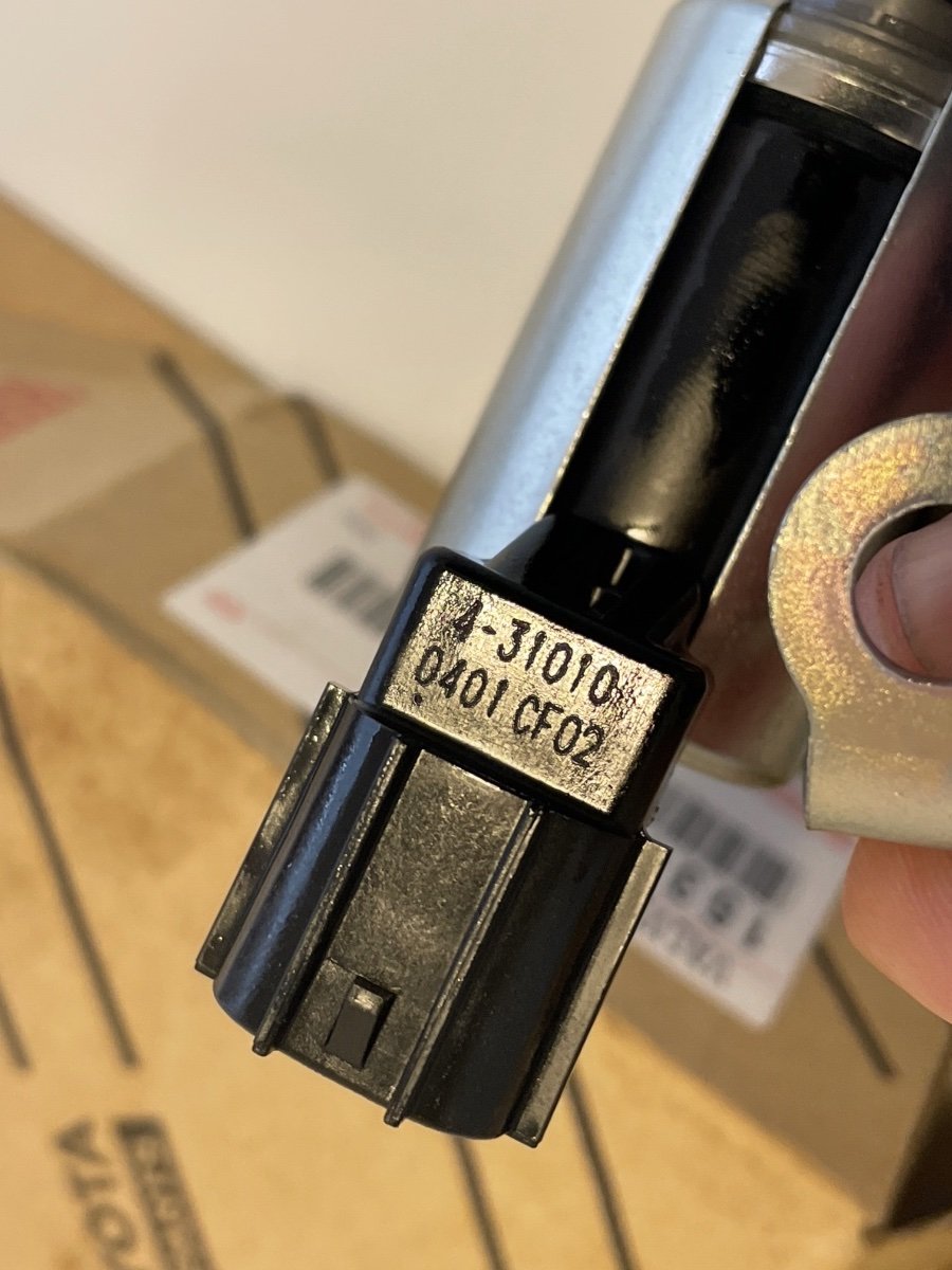

    Parts arrived. Here are photos for general interest. The ebay seller "Toyolex Parts" has an excellent rep (100 positive%) with >56,000 items sold so I'm pretty confident these are genuine Toyota parts. I'm not familiar w/ the complete range of different genuine-Toyota packaging; I was expecting the usual red-and-white striped box. I sent this seller the make/model/engine code as well as my VIN # before the purchase & they confirmed that these are the correct parts.
    2023_02_23-12_45_13.jpg 2023_02_23-12_46_02.jpg 2023_02_23-12_45_37.jpg 2023_02_23-12_45_47.jpg 2023_02_23-12_47_29.jpg 2023_02_23-12_46_49.jpg

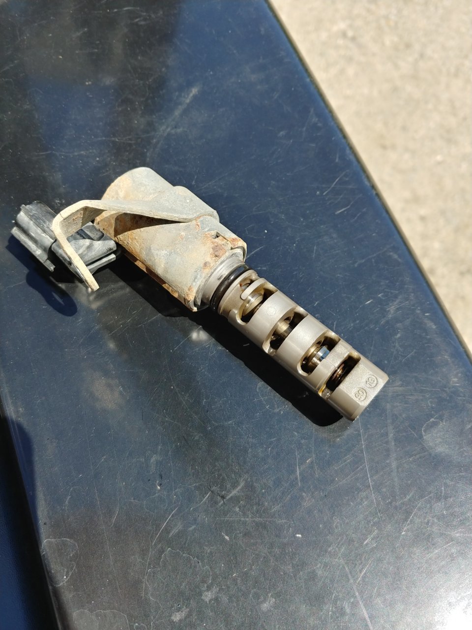

    This thread prompted me to take care of my occasional P0012 code today. Truck ran fine, just threw the code sometimes if I pulled some high RPMs.
    Of course, what should have been a 30-minute job turned into two hours because I had the same valve/solenoid separation issue. After rereading the thread and looking at a couple of YouTube videos for the issue, I managed to thread in a M10x1.25 bolt and pry it out without much difficulty. This bolt was perfect for the job, I think it managed nearly two full turns so it had good bite. I think it was about 30mm long with an integrated washer.
    I didn't have a P0012 code before I started, but upon restart it popped up. I cleared it and restarted, all's good. We'll see if it's gone for good.
