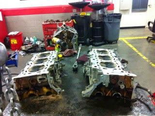

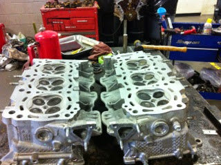

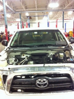

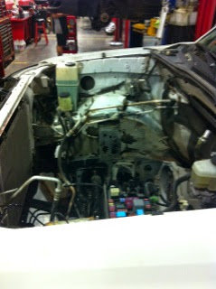

    Update:
    I picked up my truck last Saturday. Head gasket fixed. Total cost was just over $2600

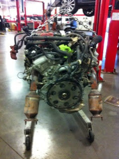

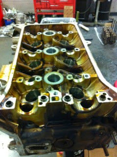

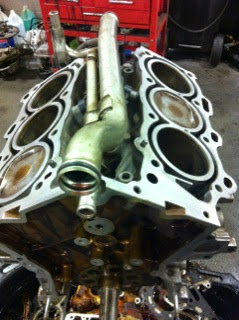

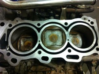

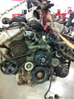

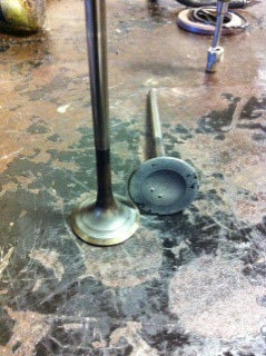

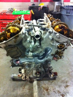

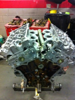

    Damn. They pulled the engine to do a head gasket? From your pictures it looks a like they did a VERY Professional job of it.

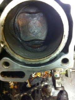

    I hope I am able to answer most of your questions.
    I did take my truck to the dealership. I was sitting at my sons soccer practice talking to a couple other gear head dads about what to do and discussing the input all of you guys gave me.
    Like it was divine intervention another dad showed up to get his son at the end of practice and was still wearing his mechanic uniform from the dealership. I knew from years ago he was a mechanic, but I had forgotten. Not only was he a mechanic, he was a Toyota mechanic and has been for the last 15+ years.
    So the next day I took my truck to the dealership and instructed them that this particular mechanic was the only person that was to turn a wrench on my truck.
    In light of us being "soccer friends" I think he did a little extra.

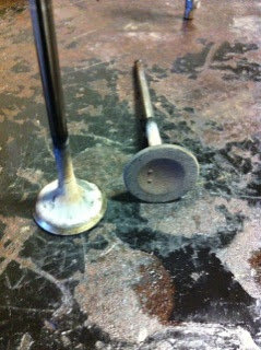

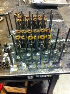

    My understanding is that after cleaning the motor, taking it apart he also cleaned the carbon off the pistons, valves etc.
    Replaced the following:
    Rear Main Seal
    Valve Seals
    Belt
    Of course oil change and coolant change.
    New head gaskets (yes the new part number)
    I will have to look at the paperwork to check everything again and then ask him what he did extra if anything that was not included on the paperwork.
    Above is from memory talking with him.
    I have not checked the mileage I am getting. Seems to run great.
