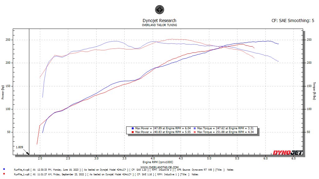

    Stock vs Stock
    2021 T4R (Red) vs 2018 3G Tacoma (Blue)
    Both on Premium Fuel
    Both on the same Dyno.
    Food for thought...

    I’ve never seen them side by side. Thanks. Look at the dips in the 3.5. SMH.
    JustDSM[QUOTED] likes this.

    A lot of that is attributed to the ACIS system that Toyota employs on that motor to improve low end/midrange torque. The application and execution of that system on the 2GR-FKS Tacoma engine leaves a bit to be desired. During activation/transition from the long runner mode to short runner mode, a great deal of torque is lost until the flapper valve sets into it's final position. Unfortunately not much can be done about it if you want to retain the torque advantage from the induction tuning the ACIS system brings.
    The 1GR Dual VVTi lost the ACIS system that the Single VVTi 1GR had. As you probably are already are aware.
