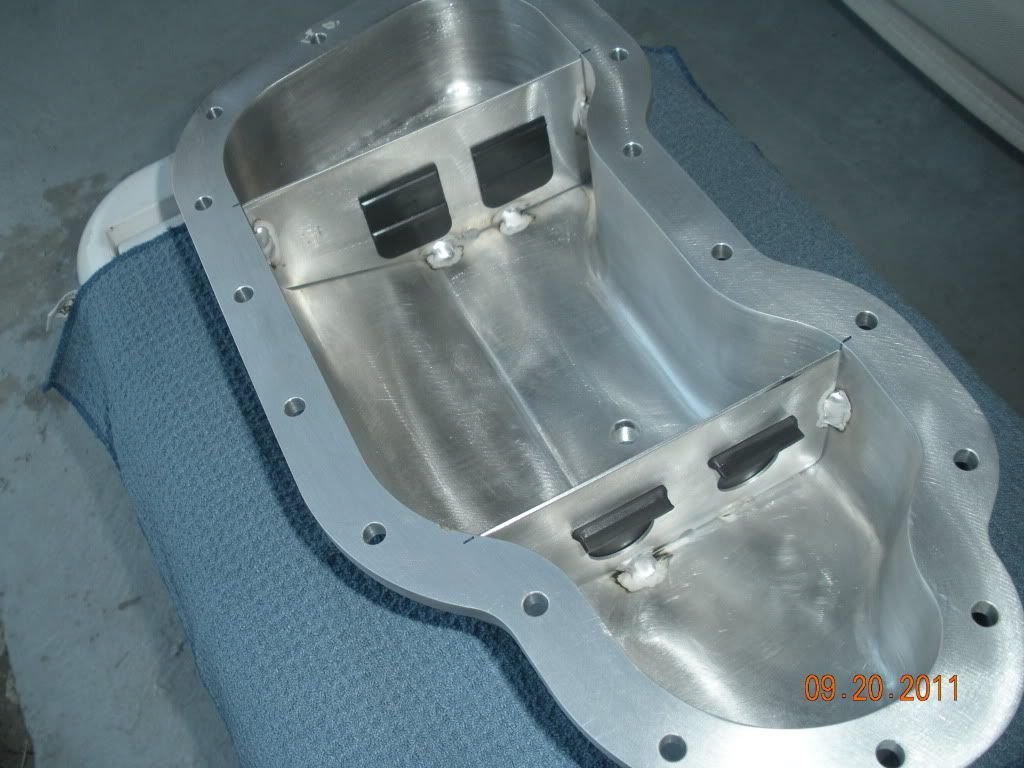

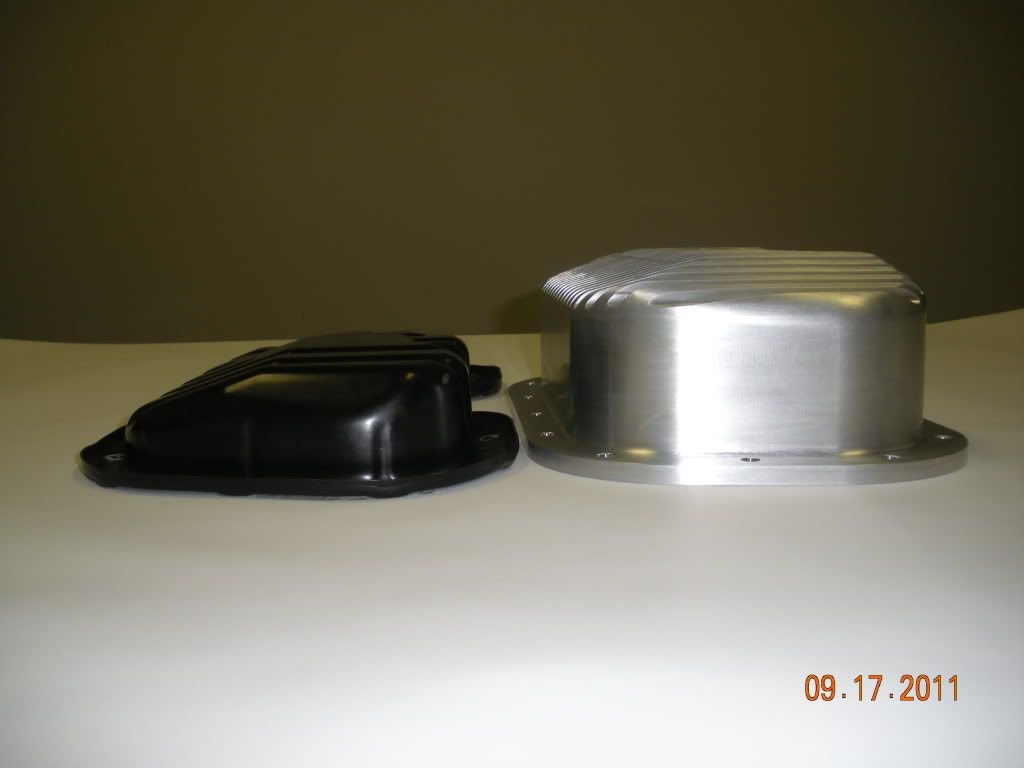

    These are oil pans for X-Runners. The black one on the left is OEM. The one on the right is made from 6061-T6 Aluminum with internal vertical baffles (with trap doors) and holds 2 1/2 extra quarts. Trap doors allow oil to pass to the center section, but not the reverse.

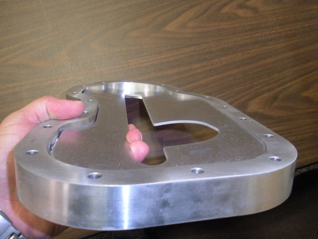

    These next pics are for an Oil Pan Spacer to increase the stock oil pan capacity. While not as pretty, it is cheaper to make this. Again, these pics are of an X-Runner Oil Pan Spacer.
    Black pan is OEM pan. Aluminum spacer underneath creates another quart of oil capacity.
    These pics show the baffle inside the spacer.

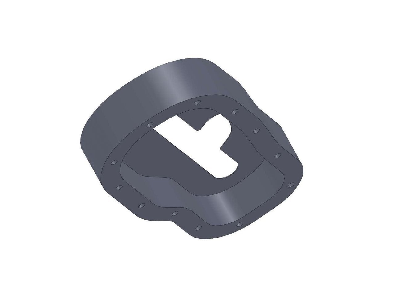

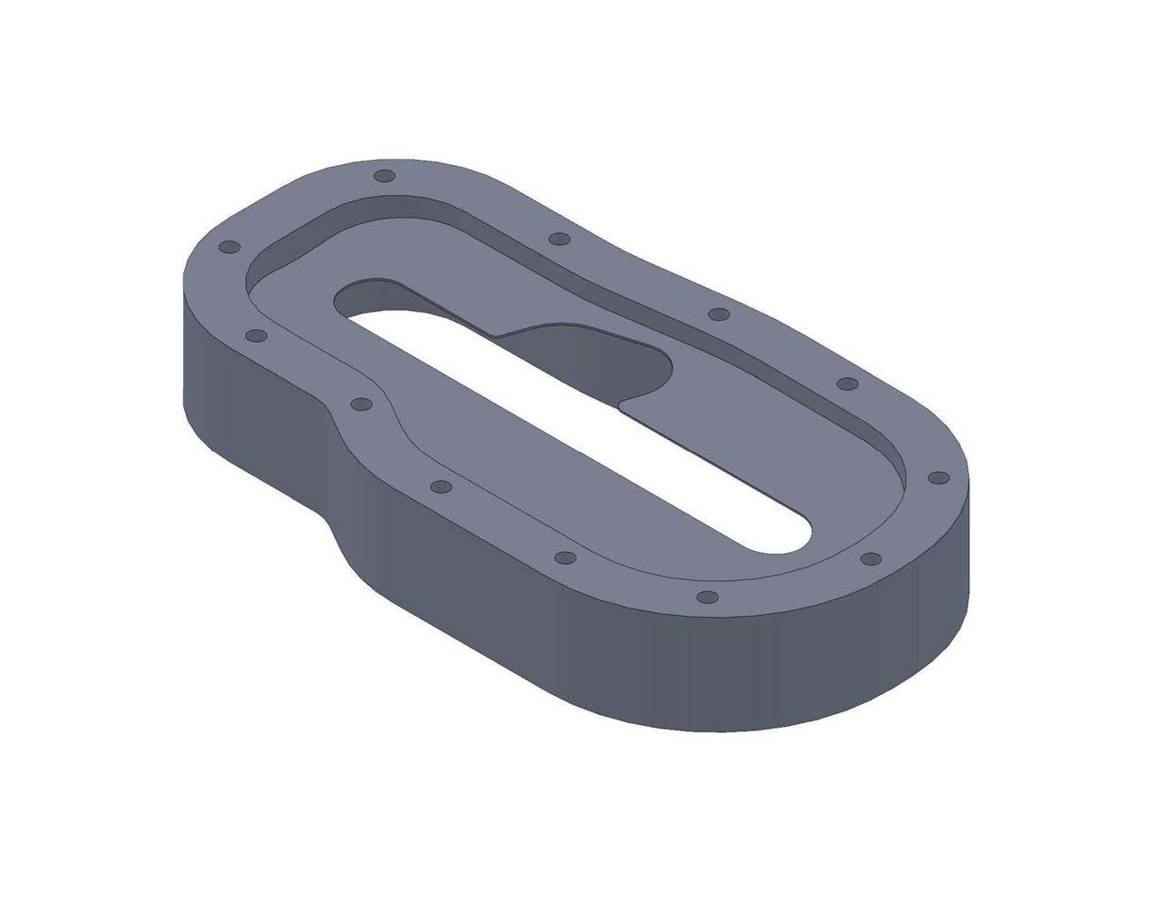

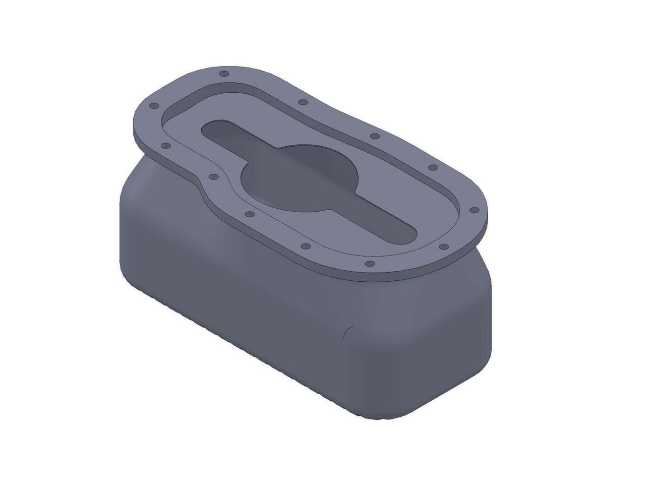

    Oil Pan Spacer w/baffle to be used with OEM steel Oil Pan
    These are solid models of an oil pan spacer with a horizontal baffle. This is approximately 1.75" tall. This will add a little over a quart. There will be a tear drop spacer for the oil pan pick-up to drop the pick-up tube do a lower position in the oil pan. This kit would use your stock OEM steel pan. The kit will come with all bolts/gaskets required for installation. The bottom of the OEM pan should be flush with the existing cross member.
    Price $570.00 including shipping to lower 48 states.

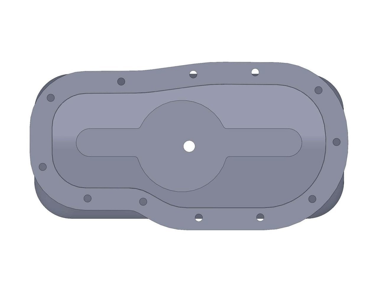

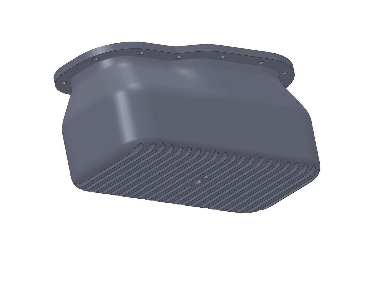

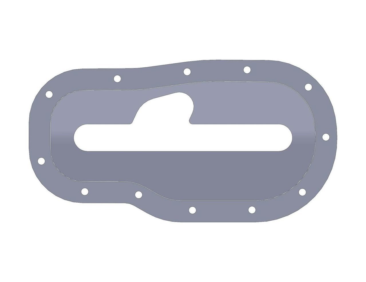

    Extra Capacity Billet Aluminum Oil Pan w/horizontal baffle
    These are solid models of an oil pan with a horizontal baffle.
    I have looked into this and I will need to make the bottom plate of the pan removeable to make this machinable. These models do not show it, but I will make the bottom plate removeable . I will update these solid models in about a week.
    This is approximately 1.75" taller than stock oil pan. This will add two (2) quarts of capacity and add a horizontal baffle. There will be a tear drop spacer for the oil pan pick-up to drop the pick-up tube do a lower position in the oil pan. The kit will come with all bolts/gaskets required for installation. The bottom of the OEM pan should be flush with the existing cross member. The bottom of the custom oil pan should be flush with the existing cross member.
    Price $1500.00 including shipping to lower 48 states.
