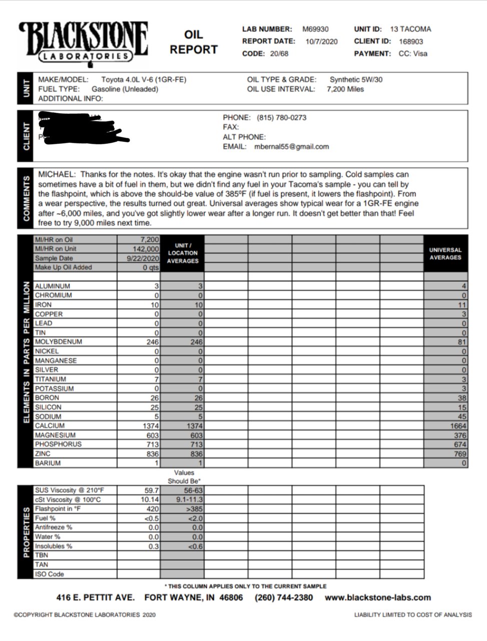

    Nothing special... Mobil or valvoline 5w-30 synthetic with an OEM filter usually every 5k. Sent a sample and 7.2 and they gave the go ahead to go 9k.

    They always give the “go ahead” I never hear anyone say “oh they told me to change my oil at 9,000”

    haha, I was going to say, I don't think I've ever seen Blackstone say to back off the mileage. I guess that's because we're all still stuck in the 3k interval mentality. I think someone should go 20k on their oil and send it in. See if Blackstone says to go 25 lol

    Oh I don’t think there fudging numbers , I just think either it’s not really necessary for a oil analysis or only useful for checking for coolant and gas in your oil if you suspect it . I don’t think they will ever say you oil is shot (broken down) and to change it

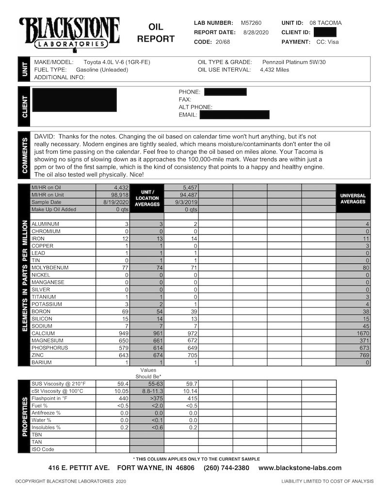

    Without the total base number there's really no way to say oil is good or bad. About all you can infer is that the additives are consumed. The OP didn't appear to do one and I usually don't either since I'm using synthetic on ~5k intervals there's not much reason to expect the oil isn't good anymore.
    The reason I do them is to watch for unusual wear or contamination. I switched from Mobil1 to Pennzoil Platinum I wanted to watch for anything odd. My boron is up but I think since sodium is still low that probably is just the relatively short interval leaving additives instead of coolant contamination.
    Whether I trust Blackstone or not, I dunno. I've sent used oil periodically to them for I guess about 10 years now and haven't seen anything to indicate foul play. But then again I'm not asking for UOA on Air Force One nor have I ever felt the need for an independent verification. It wouldn't be hard to send samples from the same engine to another lab to check them.
    OTOH 99.999% of people don't ever do that so who knows, maybe they just test a few and generate random numbers most of the time. But like you say, Blackstone is well known at BITOG and many others places so even if just 1-in-10,000 of people were to check them I bet such a thing would become viral pretty quick on the forums. I assume they have a process down to run these tests fast so I figure they're doing what they say they're doing.

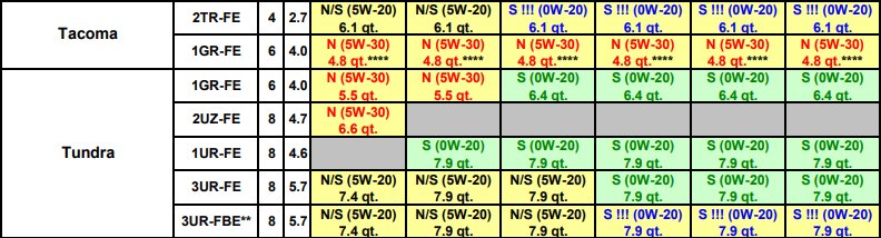

    hoo boy....didn't mean to re-open this can of worms. It's to be found here and there on the forum already.
    Every year Toyota service bulletin publishes a service bulletin for oil in different vehicles/motors.
    It clearly states the that Tacoma 4.0 1GR-FE 5.5 2 or 4 WD (different capacity) MUST RUN CONVENTIONAL OIL ONLY. NO SYNTHETIC. for ALL years.
    the same exact chart will show the 1GR-FE in the 4 Runners and the FJ Cruiser and say they should run SYNTHETIC ONLY. This is Toyota's service bulletins kids.

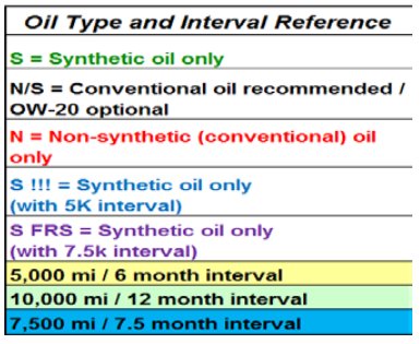

    I have a copy of the 2014 version on my desktop, I'll screen shot pieces of it so you can see.
    here's the legend:
    you can see four incidents of the 1GR-FE motor with different specs.

    FYI those are not the same 1GR-FE's.... everywhere it states synthetic for a 1GR would be the dual vvti version of it.

    So since my ‘07 isn’t even on the list , is it ok to run full synthetic ? I’m not trying to open a can of worms here , this is the first I’m hearing this . Thanks thou for explaining and showing me
