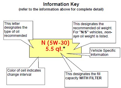

    No sweat. Look...we're all in the same boat. You read shit on a forum and you HAVE to dig and make your own decisions.
    For reference I'll share a portion of the 2013 version:
    so @nd4spdbh if I understand you correctly, the 5.5 qt capacity motor, is the only variation of the 1GR-FE that Toyota says this about. And the questions remains....WHY? Tacomabeast does a youtube video on this. He saw this data and chose to go back to conventional because of it. But as this thread says, and as every mechanic I've known for 35 years says, SYN is better, and if you can convert on a young motor and keep with it, do it, everytime.

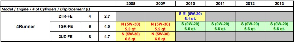

    gonna share another part of that chart
    So I think it's worth pointing out, they don't say you can't anything anywhere. True. But they are recommending that we don't use SYN and we change it every 5k.
    Like I say, for me personally, I've gone full syn and intend to keep it that way. I'm just frustrated Toyota would let confusing or contradictory info like this out there, and repeat it every year for years on end....

    My interpretation of those charts has been that Toyota is saying synthetic isn't mandatory. But that's basically self evident with anything specifying 0W-anything as it's not possible to achieve a 0W with conventional oil.

    Except that anything that is 0W is also shown with S !!! meaning synthetic only. they're clearly stating no conventional oil. Then they say the opposite, specifically, for the Tacoma.

    Yes, I mean saying 0W and S is redundant. There is no way a 0W could be conventional. Why they might say synthetic only for 5W-anything, if they even do recommend such a thing, I have no idea. Perhaps their thinking is if an engine is nominally designed for 0W the clearances and pour point of a synthetic might be easier on the engine if you use 5Wsomething in an exceptionally warm climate. But regardless if an oil meets a given API and ILSAC number then it shouldn't matter the base oil source.

    0w-20 is only available in synthetic
    Toyota isn't saying conventional oil will hurt the engine where 0w is specified, they're saying good luck finding a conventional 0w-20

    But we're talking about the 4.0 1GR-FE that is to be, per TOYOTA, CONVENTIONAL ONLY, . Slice and dice all you want. That is what the document states. This is their language.
    ONLY. They added that word. Didn't have to. That's pretty clear.
