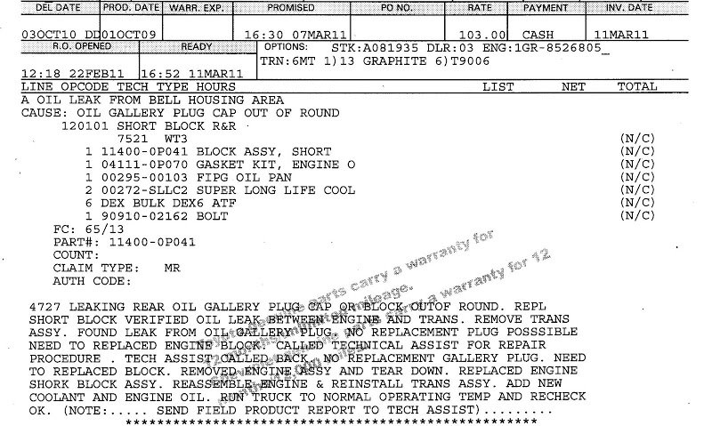

    The thing is if its the same size plug as a 2AZ 4cyl, NAPA sells the plug. Its a 20mm freeze plug. I know it works for a 2AZ not sure for the 1GR. You might want to tell your dealer to look into it. Hope this helps..

    Its not a freeze plug, obviously I guess, since it's leaking oil. I don't know why they want to short block the engine. I'd think there'd be one of many ways to solve this problem. One issue might be, freeze plugs can occasionally fail.. engine blocks shouldn't. I'll ask the service guy if its something I can go look at, just to satisfy curiosity.
    One thing he did say is. It looks like a 20 cent part, but toyota doesn't sell it without a block.
    Maybe it shows a failure in machining and "better safe than sorry".

    Its a small freeze plug type plug that holds back oil not coolant. Like I said I have not seen it on the 1GR but I bet that's your leak. Your service guy is correct that you cant get just a plug from Toyota without a short block but that dose not mean you cant get a new plug that fits, just not from Toyota. What ever the fix I hope you get it done without any problems or dealer drama...:)

    Yea, I dont think this dealer is going to fix it any way other than how tmc says. He said as soon as he foumd what it was he just called toyota and requested instructions. Guy sounds like he really knows what he's talking about, unlike some service writers that have no clue. Like I said. I said rear main, he said "woah, that's not good, and dropped to the ground and slid under the bell housing in his nice pressed, tucked, company aloha shirt. Even got his fingers dirty checking the oil drip. Claimed he climbed under again when they pulled the transmission to find the oil leak. Described it as if he did the work himself. Good guy so far (jinx).

    GOt my truck back
    No problems so far in the 4 miles I've driven it, and it's all detailed like it was going up for sale... the outside anyway, they didn't eff with the inside too much, it wasn't cleaned out when I dropped it off. Just on time too, that camry was starting to have shifting problems.. I take no responsibility for that.....
