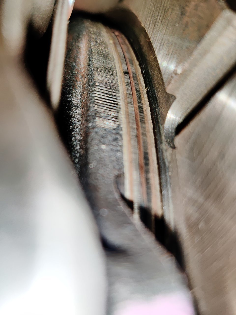

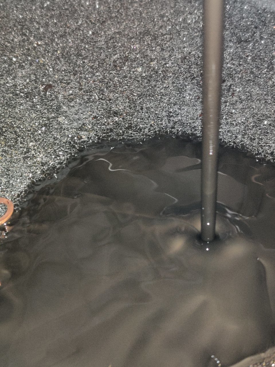

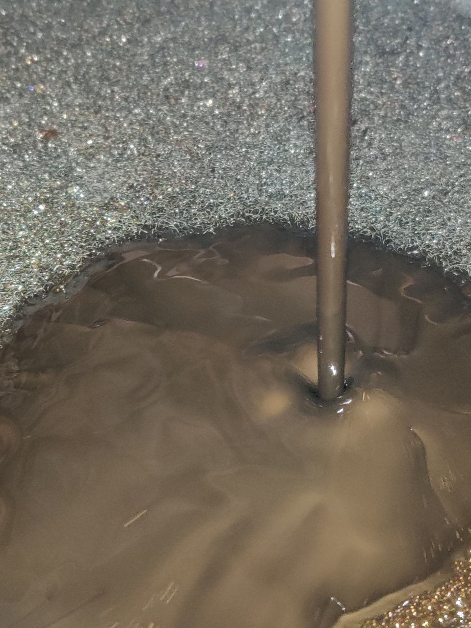

    A little back story. Once upon a time in the land of blissful ignorance. Lol! So a few weeks ago, in reality. I was performing an oil change on the truck. I started off by pulling the filter. I notice something out of the corner of my eye looked a little..off. I look back and think to myself "that looks kinda shiny". Yes, I was a little worried. Well time to raise the truck up and drain the engine. As the oil hits the drain pan you can see all the metallic material in the oil. My thoughts "Fuck". I have not had any noises, knocks, rough running, no symptoms of a failing engine. Well I had to finish the oil change. I think the part that pissed me off the most was the $70-80 of Liquid moly nexgen I had to put in it, just to goto waste.

    Make sure that you use a micrometer to measure the crankshaft mains and journals then document it. Most likely you can get away with standard sized bearings. are sure that you spin the crankshaft after mounting the crankshaft bearings. Rebuilding an engine is easier thank you think it is. Remember that in order for you to eat an elephant it takes one bite at a time so don't let it intimidate you.
    1. Get compression readings on each cylinder.
    2. Examine the spark plugs because they can tell a story.
    How did that oil get so much bearing material?

    Not sure how it got the metal in the oil. Tear down should tell me.

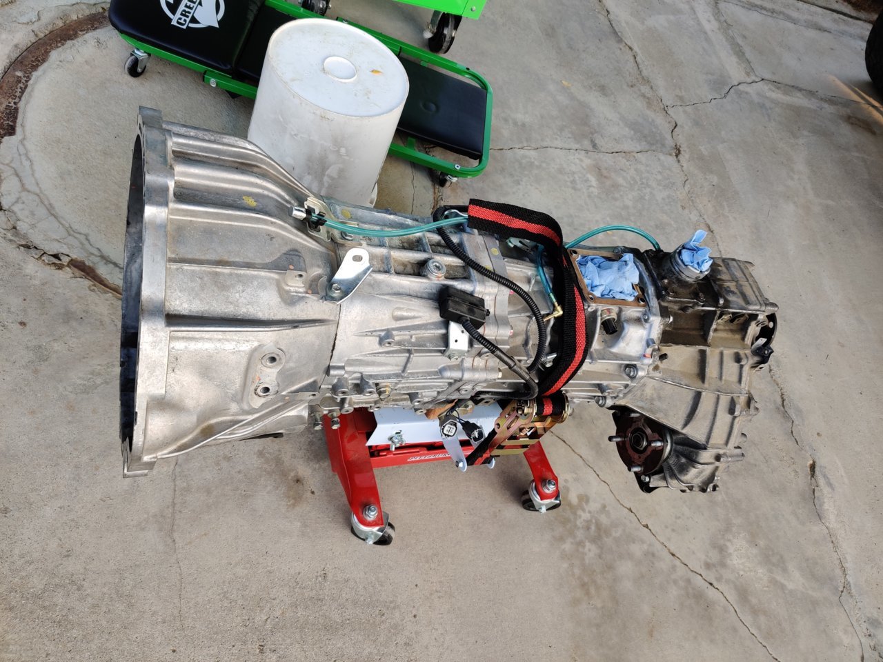

    Trans out and beer in hand. Lol!

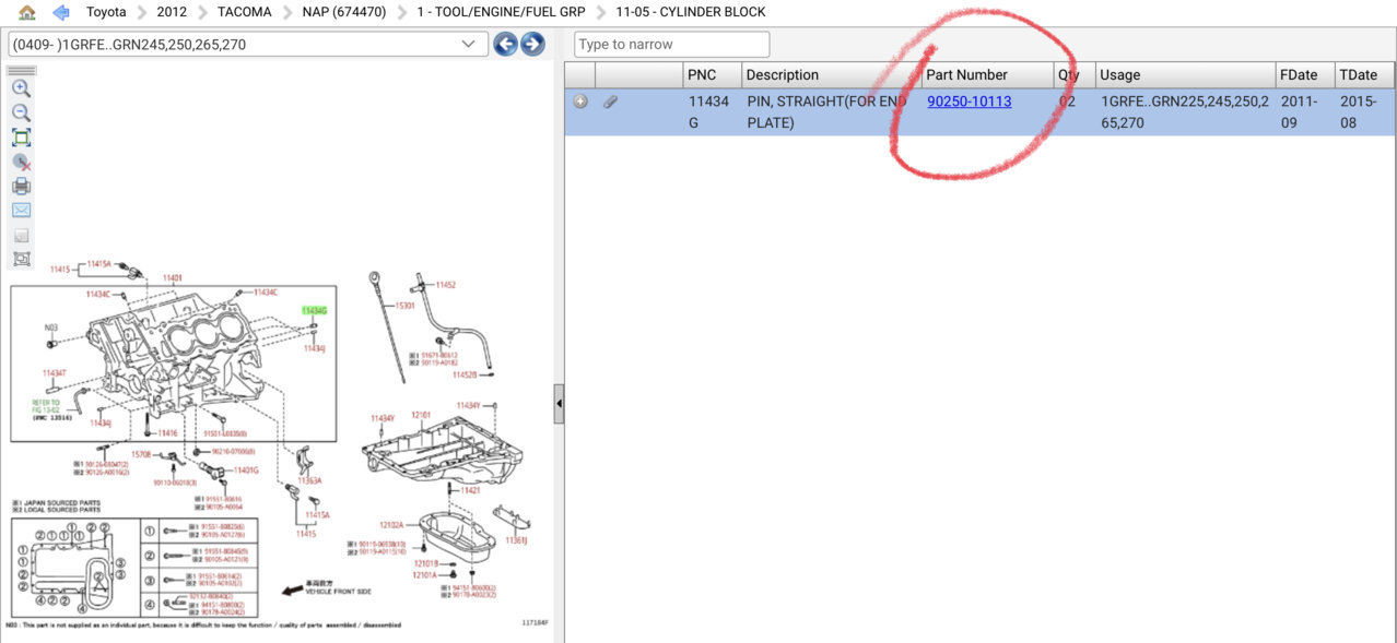

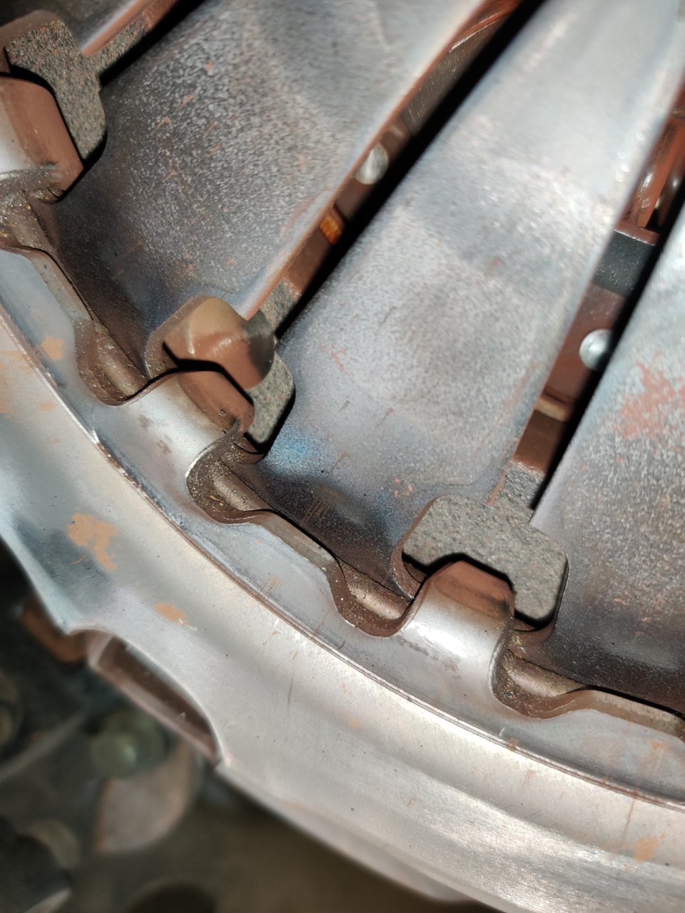

    A little more to the back story. About 5-7k ago I replaced the trans for a RC62F and added an AWD t-case. I had to use the 3rd gen pressure plate. I was not able to get one of the alignment dowels out of the old trans. So the new trans went in with one dowel. Since that repair I have had a vibration between 2k-3k at the highest rpm. I had not been able to get it tracked down. My fear is that vibration may have contributed to this failure. I took 3 pics of the clutch flywheel assembly while still on the engine. The pics are of looking through the vent gaps. There are three, hince three pics.

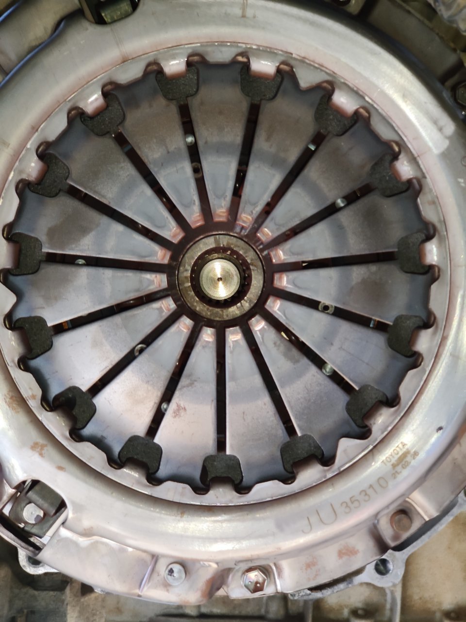

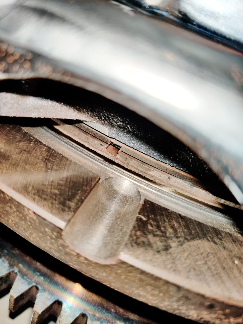

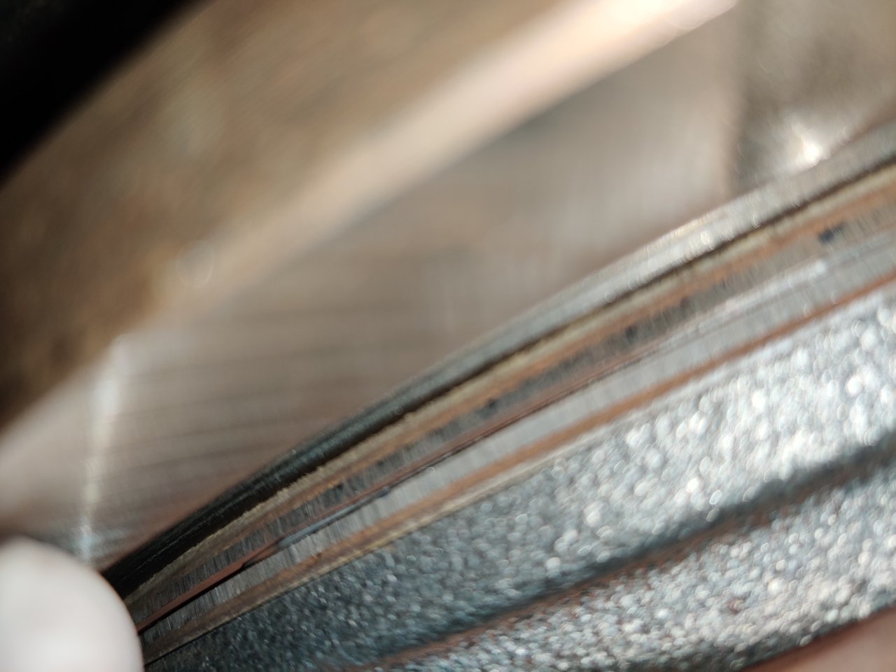

    Clutch disk definitely isn't flat.
    How are the dowels and holes for the pressure plate to flywheel? That would be the most likely culprit for a disk "flushness" issue.

    Tried all of that on the old dowel pin. It was not moving. that is why I put the the new trans in with only one.
    From what I can tell they all look good and seated properly. I will take pics of them tomorrow or when I pull the clutch off. I was worried the clutch disk may be off center from the missing dowel.
