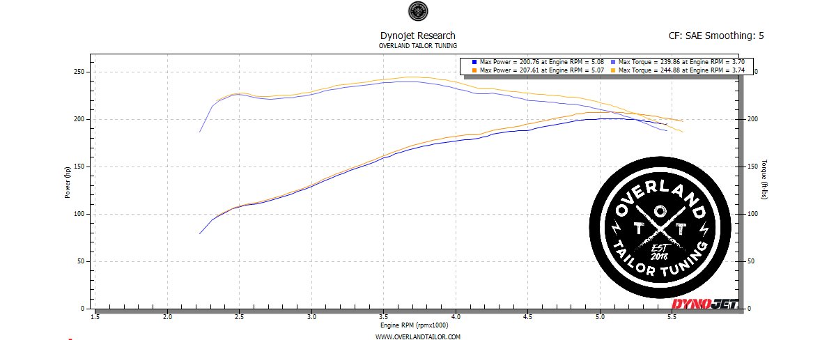

    And for giggles and to stir conversation, here's what happens when you remove the stock airfilter (leaving stock secondary in place):

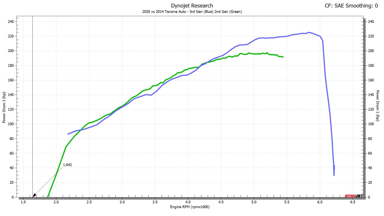

    How about a 2nd Gen vs a 3rd Gen Both Stock and Tuned?
    Here you go!
    Stock:

    Nice. Glad to have some data. Interesting graphs for 2nd and 3rd gens. Tbh, it does match my expectation that the 3.5 is just a bit down to the 4.0 at the low/mid end, but has better breathing and power at higher rpms.
    Question/verification though. The last 2nd gen graph shows a green line for regular gas results. Does this mean that all the other 2nd and 3rd gen pulls were done with premium gas and a premium gas tune?

    I only have one criticism.....what do the torque graphs look like? Thirsty for all the datas. :D
    Getting that 3rd gen engine tuned, really opens up the hp improvement, even as the rpms climb.
    It would do really well with boost.

    Also, very glad that the charts were displayed in SAE smoothing. :thumbsup:
