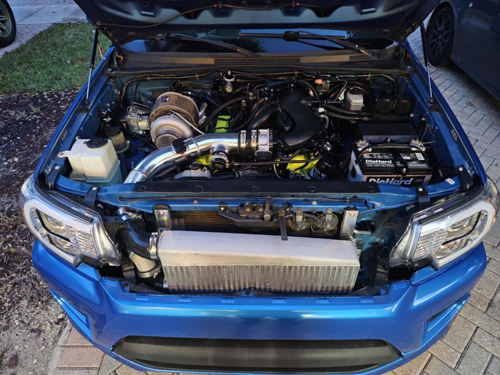

    My updated setup. Precision 6266, treadstone intercooler, custom turbo manifold, down pipe, full 3in exhaust, 850cc injectors, turbo smart WG/BOV/Regulator/ walbro pump, -8 lines, BC rods, .020 over Pistons from LC engineering, King bearings, ARP head studs, New OEM main studs, Stock crank, OEM head gaskets, Re grind cams from BC, Kelford springs, Titanium spring bases, Supertech valve seals, New valves, ported intake ports, Custom buckets, New timing chain kit and gears, New oil pump. clutchmasters clutch, tilton TOB setup.. Haltech elite 2500 ecu, Can guage, boomslang harness... URD short shifter

    OK..
    What does all that massive work & expense get you in WHP at the dyno?
  4. Oct 3, 2024 at 11:43 AM
    #24
    Xrunner2nv
    Xrunner2nv Well-Known Member
    Feb 12, 2019
    #282798
    59
    2008 Tacoma X-runner
    The original turbo kit setup was like $3500 turned on HP tuners. It was making 330hp
    I upgraded the turbo, injectors, fuel pump, and switched to haltech elite. Base run was 352 whp, end run it made 482whp
    It threw a rod on 2step one day and I made the decision to build a motor instead of buying a whole stock engine. The engine build from when it blew up to this date total including every single part and thing in the engine bay and upgrades in parts was about $7700..
    So from stock to what it is now I'm over 11k in. But I've had this truck since 2017, and started the turbo setup in 2020

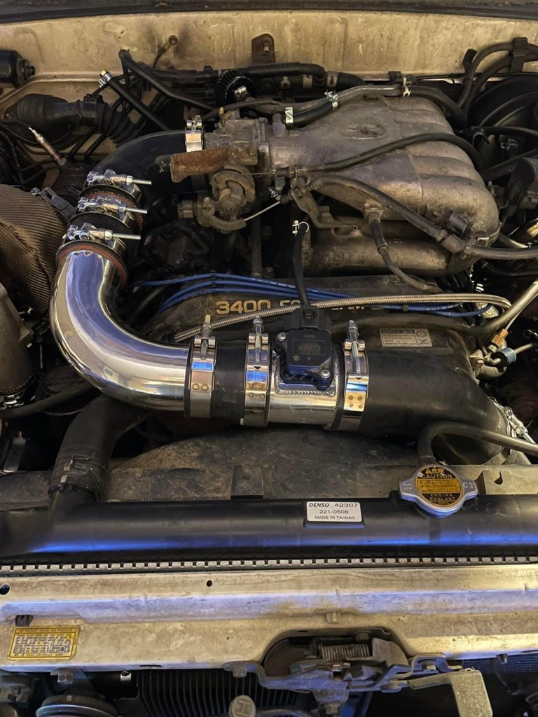

    I turbo’d the 5vz in my third gen 4Runner and absolutely love it. People talk about turbo lag, but running a smaller turbo (GTX3071 in my case), it spools up QUICK and makes great power. I’m running 7psi, but the intercooler cooling down the air charge means more power than a supercharger at the same 7psi. Makes towing my boat around so much easier, and traveling through the mountains a breeze. Wish someone made turbo manifolds for the 1gr. I don’t have the fab (welding) skills to make my own. If someone made some, I’d probably upgrade to a newer truck.
